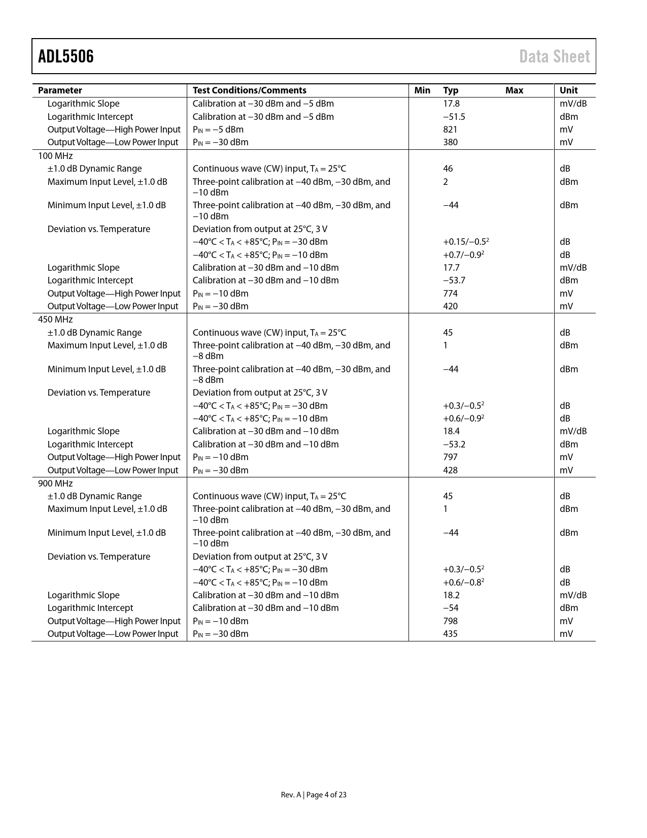

ADL5506. Data Sheet. Parameter. Test Conditions/Comments. Min Typ. Max. Unit
ADL5506 Data Sheet Parameter Test Conditions/Comments Min Typ Max Unit
link to page 8 link to page 8 link to page 8 link to page 8 link to page 8 link to page 8
Logarithmic Slope Calibration at −30 dBm and −5 dBm 17.8 mV/dB Logarithmic Intercept Calibration at −30 dBm and −5 dBm −51.5 dBm Output Voltage—High Power Input PIN = −5 dBm 821 mV Output Voltage—Low Power Input PIN = −30 dBm 380 mV 100 MHz ±1.0 dB Dynamic Range Continuous wave (CW) input, TA = 25°C 46 dB Maximum Input Level, ±1.0 dB Three-point calibration at −40 dBm, −30 dBm, and 2 dBm −10 dBm Minimum Input Level, ±1.0 dB Three-point calibration at −40 dBm, −30 dBm, and −44 dBm −10 dBm Deviation vs. Temperature Deviation from output at 25°C, 3 V −40°C < TA < +85°C; PIN = −30 dBm +0.15/−0.52 dB −40°C < TA < +85°C; PIN = −10 dBm +0.7/−0.92 dB Logarithmic Slope Calibration at −30 dBm and −10 dBm 17.7 mV/dB Logarithmic Intercept Calibration at −30 dBm and −10 dBm −53.7 dBm Output Voltage—High Power Input PIN = −10 dBm 774 mV Output Voltage—Low Power Input PIN = −30 dBm 420 mV 450 MHz ±1.0 dB Dynamic Range Continuous wave (CW) input, TA = 25°C 45 dB Maximum Input Level, ±1.0 dB Three-point calibration at −40 dBm, −30 dBm, and 1 dBm −8 dBm Minimum Input Level, ±1.0 dB Three-point calibration at −40 dBm, −30 dBm, and −44 dBm −8 dBm Deviation vs. Temperature Deviation from output at 25°C, 3 V −40°C < TA < +85°C; PIN = −30 dBm +0.3/−0.52 dB −40°C < TA < +85°C; PIN = −10 dBm +0.6/−0.92 dB Logarithmic Slope Calibration at −30 dBm and −10 dBm 18.4 mV/dB Logarithmic Intercept Calibration at −30 dBm and −10 dBm −53.2 dBm Output Voltage—High Power Input PIN = −10 dBm 797 mV Output Voltage—Low Power Input PIN = −30 dBm 428 mV 900 MHz ±1.0 dB Dynamic Range Continuous wave (CW) input, TA = 25°C 45 dB Maximum Input Level, ±1.0 dB Three-point calibration at −40 dBm, −30 dBm, and 1 dBm −10 dBm Minimum Input Level, ±1.0 dB Three-point calibration at −40 dBm, −30 dBm, and −44 dBm −10 dBm Deviation vs. Temperature Deviation from output at 25°C, 3 V −40°C < TA < +85°C; PIN = −30 dBm +0.3/−0.52 dB −40°C < TA < +85°C; PIN = −10 dBm +0.6/−0.82 dB Logarithmic Slope Calibration at −30 dBm and −10 dBm 18.2 mV/dB Logarithmic Intercept Calibration at −30 dBm and −10 dBm −54 dBm Output Voltage—High Power Input PIN = −10 dBm 798 mV Output Voltage—Low Power Input PIN = −30 dBm 435 mV Rev. A | Page 4 of 23 Document Outline FEATURES APPLICATIONS GENERAL DESCRIPTION FUNCTIONAL BLOCK DIAGRAM TABLE OF CONTENTS REVISION HISTORY SPECIFICATIONS ABSOLUTE MAXIMUM RATINGS ESD CAUTION PIN CONFIGURATION AND FUNCTION DESCRIPTIONS TYPICAL PERFORMANCE CHARACTERISTICS MEASUREMENT SETUPS THEORY OF OPERATION APPLICATIONS INFORMATION BASIC CONNECTIONS TRANSFER FUNCTION IN TERMS OF SLOPE AND INTERCEPT LOG CONFORMANCE ERROR CALCULATION Filter Capacitor Input Coupling Options Effect of Waveform Type on Intercept Temperature Drift at High Frequencies Operation Above 4.5 GHz VLOG Output Noise VLOG Pulse Response Time Device Handling EVALUATION BOARD LAND PATTERN AND SOLDERING INFORMATION OUTLINE DIMENSIONS ORDERING GUIDE
