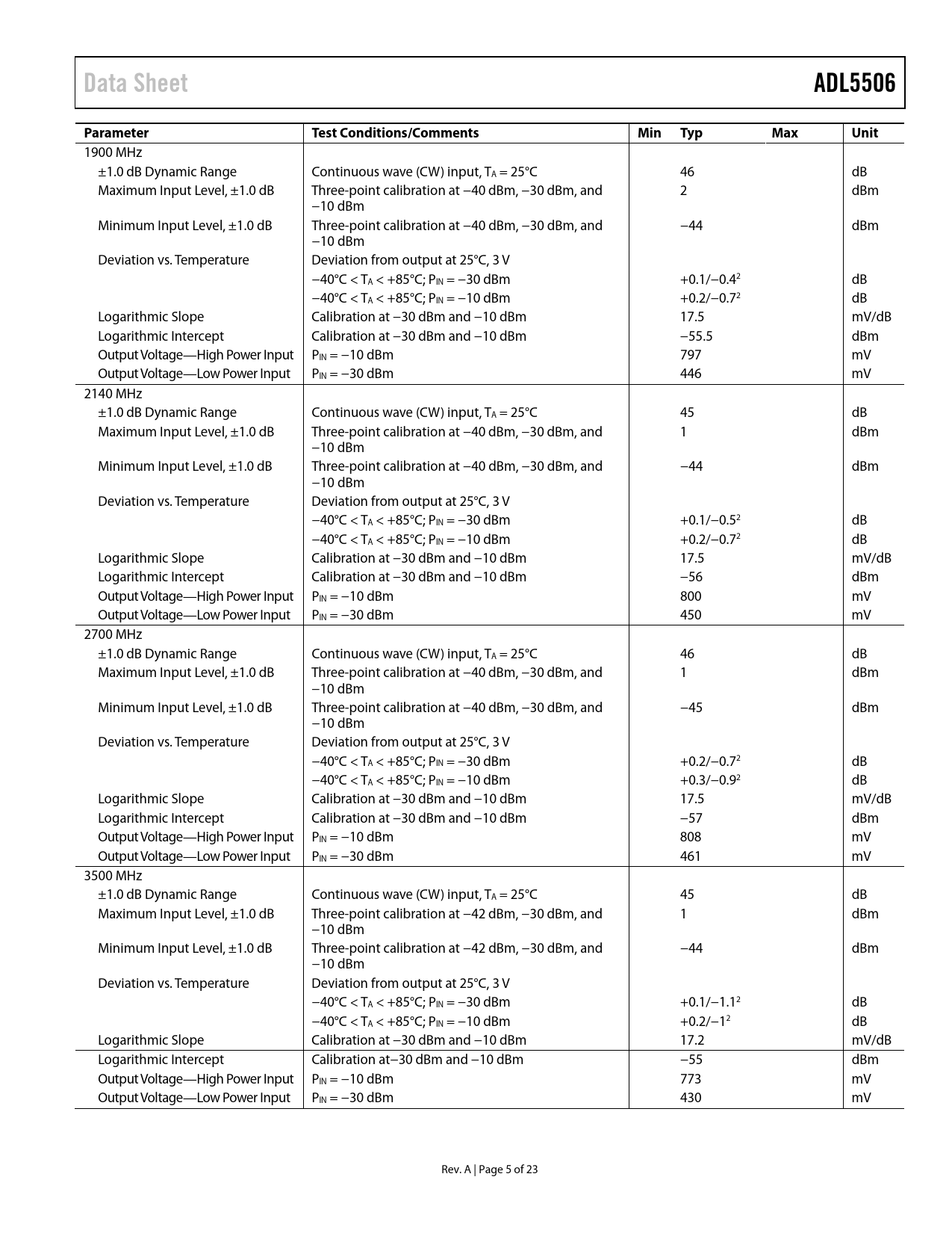

Data Sheet. ADL5506. Parameter. Test Conditions/Comments. Min Typ. Max. Unit
Data Sheet ADL5506 Parameter Test Conditions/Comments Min Typ Max Unit
link to page 8 link to page 8 link to page 8 link to page 8 link to page 8 link to page 8 link to page 8 link to page 8
1900 MHz ±1.0 dB Dynamic Range Continuous wave (CW) input, TA = 25°C 46 dB Maximum Input Level, ±1.0 dB Three-point calibration at −40 dBm, −30 dBm, and 2 dBm −10 dBm Minimum Input Level, ±1.0 dB Three-point calibration at −40 dBm, −30 dBm, and −44 dBm −10 dBm Deviation vs. Temperature Deviation from output at 25°C, 3 V −40°C < TA < +85°C; PIN = −30 dBm +0.1/−0.42 dB −40°C < TA < +85°C; PIN = −10 dBm +0.2/−0.72 dB Logarithmic Slope Calibration at −30 dBm and −10 dBm 17.5 mV/dB Logarithmic Intercept Calibration at −30 dBm and −10 dBm −55.5 dBm Output Voltage—High Power Input PIN = −10 dBm 797 mV Output Voltage—Low Power Input PIN = −30 dBm 446 mV 2140 MHz ±1.0 dB Dynamic Range Continuous wave (CW) input, TA = 25°C 45 dB Maximum Input Level, ±1.0 dB Three-point calibration at −40 dBm, −30 dBm, and 1 dBm −10 dBm Minimum Input Level, ±1.0 dB Three-point calibration at −40 dBm, −30 dBm, and −44 dBm −10 dBm Deviation vs. Temperature Deviation from output at 25°C, 3 V −40°C < TA < +85°C; PIN = −30 dBm +0.1/−0.52 dB −40°C < TA < +85°C; PIN = −10 dBm +0.2/−0.72 dB Logarithmic Slope Calibration at −30 dBm and −10 dBm 17.5 mV/dB Logarithmic Intercept Calibration at −30 dBm and −10 dBm −56 dBm Output Voltage—High Power Input PIN = −10 dBm 800 mV Output Voltage—Low Power Input PIN = −30 dBm 450 mV 2700 MHz ±1.0 dB Dynamic Range Continuous wave (CW) input, TA = 25°C 46 dB Maximum Input Level, ±1.0 dB Three-point calibration at −40 dBm, −30 dBm, and 1 dBm −10 dBm Minimum Input Level, ±1.0 dB Three-point calibration at −40 dBm, −30 dBm, and −45 dBm −10 dBm Deviation vs. Temperature Deviation from output at 25°C, 3 V −40°C < TA < +85°C; PIN = −30 dBm +0.2/−0.72 dB −40°C < TA < +85°C; PIN = −10 dBm +0.3/−0.92 dB Logarithmic Slope Calibration at −30 dBm and −10 dBm 17.5 mV/dB Logarithmic Intercept Calibration at −30 dBm and −10 dBm −57 dBm Output Voltage—High Power Input PIN = −10 dBm 808 mV Output Voltage—Low Power Input PIN = −30 dBm 461 mV 3500 MHz ±1.0 dB Dynamic Range Continuous wave (CW) input, TA = 25°C 45 dB Maximum Input Level, ±1.0 dB Three-point calibration at −42 dBm, −30 dBm, and 1 dBm −10 dBm Minimum Input Level, ±1.0 dB Three-point calibration at −42 dBm, −30 dBm, and −44 dBm −10 dBm Deviation vs. Temperature Deviation from output at 25°C, 3 V −40°C < TA < +85°C; PIN = −30 dBm +0.1/−1.12 dB −40°C < TA < +85°C; PIN = −10 dBm +0.2/−12 dB Logarithmic Slope Calibration at −30 dBm and −10 dBm 17.2 mV/dB Logarithmic Intercept Calibration at−30 dBm and −10 dBm −55 dBm Output Voltage—High Power Input PIN = −10 dBm 773 mV Output Voltage—Low Power Input PIN = −30 dBm 430 mV Rev. A | Page 5 of 23 Document Outline FEATURES APPLICATIONS GENERAL DESCRIPTION FUNCTIONAL BLOCK DIAGRAM TABLE OF CONTENTS REVISION HISTORY SPECIFICATIONS ABSOLUTE MAXIMUM RATINGS ESD CAUTION PIN CONFIGURATION AND FUNCTION DESCRIPTIONS TYPICAL PERFORMANCE CHARACTERISTICS MEASUREMENT SETUPS THEORY OF OPERATION APPLICATIONS INFORMATION BASIC CONNECTIONS TRANSFER FUNCTION IN TERMS OF SLOPE AND INTERCEPT LOG CONFORMANCE ERROR CALCULATION Filter Capacitor Input Coupling Options Effect of Waveform Type on Intercept Temperature Drift at High Frequencies Operation Above 4.5 GHz VLOG Output Noise VLOG Pulse Response Time Device Handling EVALUATION BOARD LAND PATTERN AND SOLDERING INFORMATION OUTLINE DIMENSIONS ORDERING GUIDE
