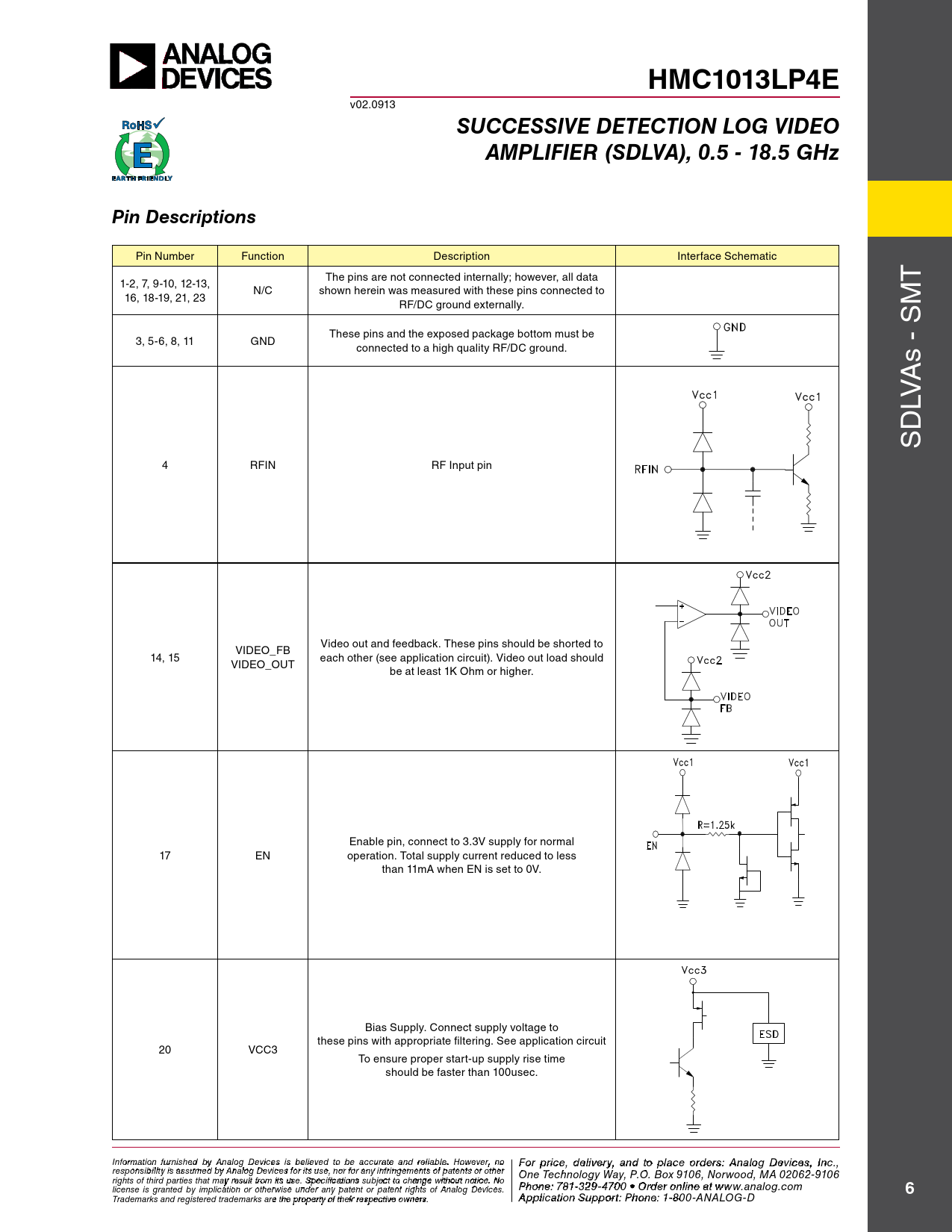

HMC1013LP4E. SUCCESSIVE DETECTION LOG VIDEO. AMPLIFIER (SDLVA), 0.5 - 18.5 GHz. Pin Descriptions
HMC1013LP4E SUCCESSIVE DETECTION LOG VIDEO AMPLIFIER (SDLVA), 0.5 - 18.5 GHz Pin Descriptions
HMC1013LP4E
v02.0913
Pin Number Function Description Interface Schematic The pins are not connected internally; however, all data 1-2, 7, 9-10, 12-13, T N/C shown herein was measured with these pins connected to 16, 18-19, 21, 23 RF/DC ground externally. M S These pins and the exposed package bottom must be 3, 5-6, 8, 11 GND connected to a high quality RF/DC ground. - As LV SD 4 RFIN RF Input pin Video out and feedback. These pins should be shorted to VIDEO_FB 14, 15 each other (see application circuit). Video out load should VIDEO_OUT be at least 1K Ohm or higher. Enable pin, connect to 3.3V supply for normal 17 EN operation. Total supply current reduced to less than 11mA when EN is set to 0V. Bias Supply. Connect supply voltage to these pins with appropriate filtering. See application circuit 20 VCC3 To ensure proper start-up supply rise time should be faster than 100usec. Inf F or o m r p atio r n ifc ur e n , d ishe e d lbiv y e A r n y a alog n D d t evic o p es is la beclie o eved rd to ebre sa: H ccur iattti e tae M nd re ilicarbloew . H a o ve C wever, o n rp o For price, delivery, and to place orders: Analog Devices, Inc., responsibility is assumed by Analog Devices for its use, nor for any infringements of patents or other oration, 2 Elizabeth Drive, Chelmsford, MA 01824 One Technology Way, P.O. Box 9106, Norwood, MA 02062-9106 Phone: 978-250-3343 Fax: 978-250-3373 O rights of third parties that may result from its use. Specifications subject to change without notice. No P rd hone e r O : 7 n 81- -3li 2n 9 e a -47 t w 0 w 0 • O w rd .h e it r o t niltie n .c e ao t m license is granted by implication or otherwise under any patent or patent rights of Analog Devices. www.analog.com
