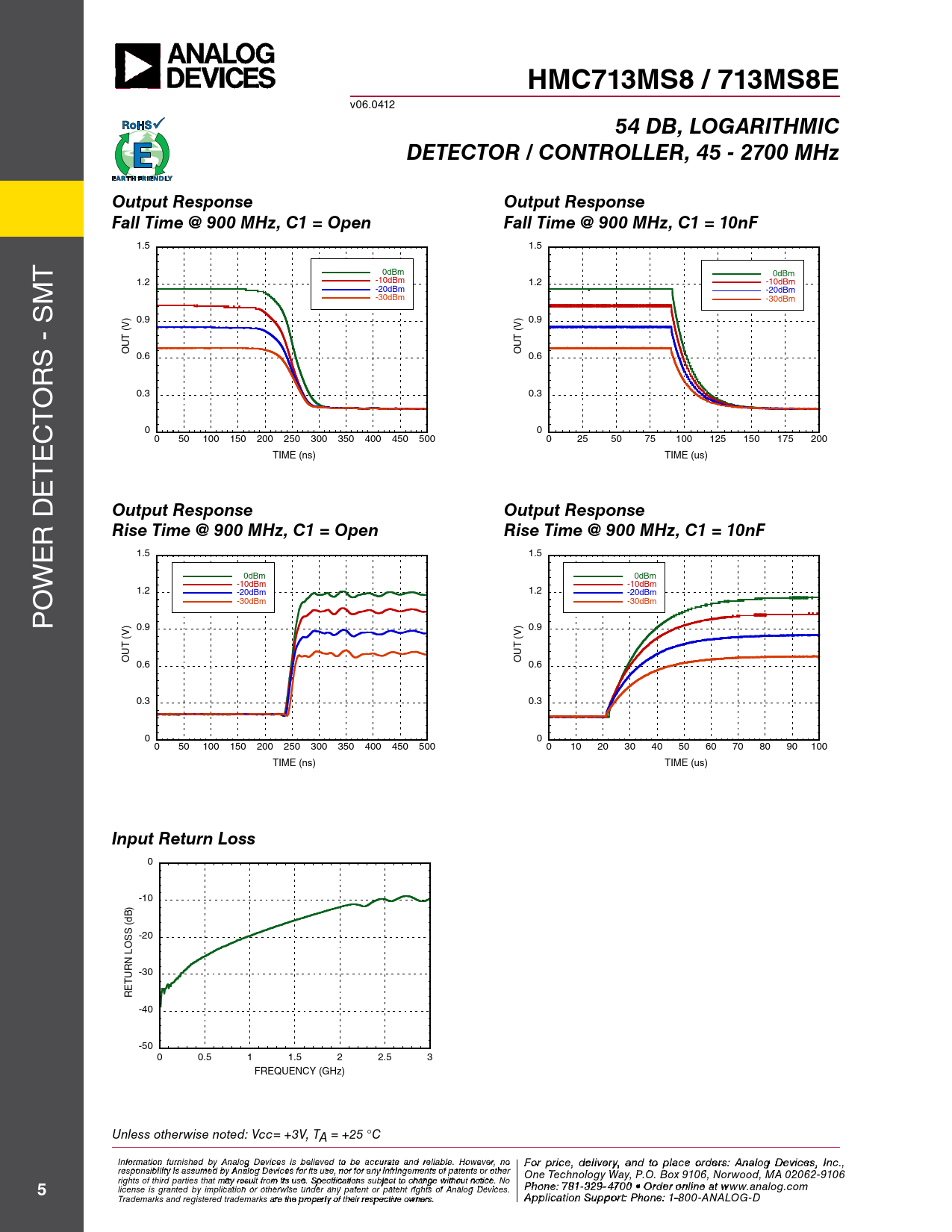

HMC713MS8 / 713MS8E. 54 DB, LOGARITHMIC. DETECTOR / CONTROLLER, 45 - 2700 MHz. Output Response. Fall Time @ 900 MHz, C1 = Open
HMC713MS8 / 713MS8E 54 DB, LOGARITHMIC DETECTOR / CONTROLLER, 45 - 2700 MHz Output Response Fall Time @ 900 MHz, C1 = Open
HMC713MS8 / 713MS8E
v06.0412
54 DB, LOGARITHMIC DETECTOR / CONTROLLER, 45 - 2700 MHz Output Response Output Response Fall Time @ 900 MHz, C1 = Open Fall Time @ 900 MHz, C1 = 10nF
1.5 1.5 t 0dBm 0dBm M 1.2 -10dBm 1.2 -10dBm -20dBm -20dBm -30dBm -30dBm s 0.9 0.9 - OUT (V) 0.6 OUT (V) 0.6 rs o 0.3 0.3 t c 0 0 e 0 50 100 150 200 250 300 350 400 450 500 0 25 50 75 100 125 150 175 200 t TIME (ns) TIME (us) e D
r
Rise Time @ 900 MHz, C1 = Open Rise Time @ 900 MHz, C1 = 10nF
e 1.5 1.5 w 0dBm 0dBm -10dBm -10dBm o 1.2 -20dBm 1.2 -20dBm -30dBm -30dBm P 0.9 0.9 OUT (V) 0.6 OUT (V) 0.6 0.3 0.3 0 0 0 50 100 150 200 250 300 350 400 450 500 0 10 20 30 40 50 60 70 80 90 100 TIME (ns) TIME (us)
Input Return Loss
0 -10 ) dB ( S -20 S O L N R -30 U T E R -40 -50 0 0.5 1 1.5 2 2.5 3 FREQUENCY (GHz) Unless otherwise noted: Vcc= +3V, TA = +25 °C I F nf o or r p mati r o in cfe ur , d nish e e l d iv b e y r A y a nalo n g d t Devi o p ces i la s c bele o ieve rd d t e o rbs e : H acc iutrtatite e M and ic reli rao bl w e. a H v o e C wever o , nrp o For price, delivery, and to place orders: Analog Devices, Inc., responsibility is assumed by Analog Devices for its use, nor for any infringements of patents or other oration, 2 Elizabeth Drive, Chelmsford, MA 01824 One Technology Way, P.O. Box 9106, Norwood, MA 02062-9106 Phone: 978-250-3343 Fax: 978-250-3373 O rights of third parties that may result from its use. Specifications subject to change without notice. No rd Phoe n r O e: 7 n- 81-li 3 n 2 e a 9-4 t w 70 ww 0 • O . rdh e itt r o it nle i . n co e a m
