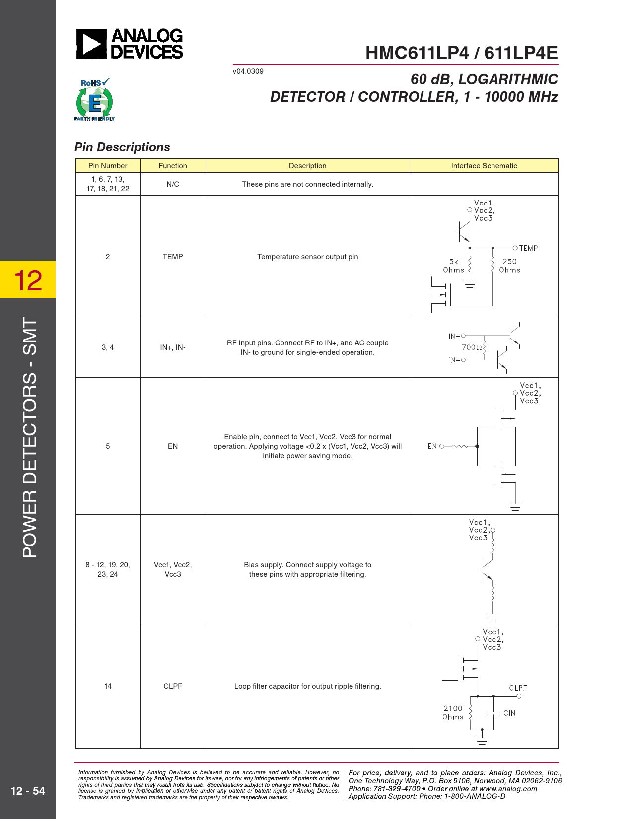

60 dB, LOGARITHMIC DETECTOR / CONTROLLER, 1 - 10000 MHz Pin Descriptions
Pin Number Function Description Interface Schematic 1, 6, 7, 13, N/C These pins are not connected internally. 17, 18, 21, 22 2 TEMP Temperature sensor output pin 12 T RF Input pins. Connect RF to IN+, and AC couple 3, 4 IN+, IN- IN- to ground for single-ended operation. S - SM R O T C E Enable pin, connect to Vcc1, Vcc2, Vcc3 for normal T 5 EN operation. Applying voltage <0.2 x (Vcc1, Vcc2, Vcc3) will initiate power saving mode. E R D E W O P 8 - 12, 19, 20, Vcc1, Vcc2, Bias supply. Connect supply voltage to 23, 24 Vcc3 these pins with appropriate fi ltering. 14 CLPF Loop fi lter capacitor for output ripple fi ltering. Information furnis F heod r pri by An ce, de alog Devi lcievs eir s y b , a eliev nd to pla ed to be accu ce o rate anrder d relia sbl, pl e. H ease co owever, no For price, delivery, and to place orders: Analog Devices, Inc., responsibility is assumed by Analog Devices for its use, nor for any infringements of patents or other ntact Hittite Microwave Corporation: One Technology Way, P.O. Box 9106, Norwood, MA 02062-9106 20 Alpha Road, Chelmsford, MA 01824 Phone: 978 rights of third parties that may result from its use. Specifications subject to change without notice. No Ph - o 25 ne 0 : 7 -3 81- 3 3 4 29 3 F -470 ax: 978 0 • Orde - r o 25 nlin 0- e a3 t 373
