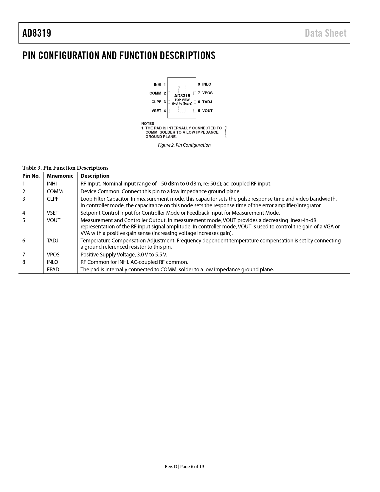

AD8319. Data Sheet. PIN CONFIGURATION AND FUNCTION DESCRIPTIONS. INHI 1. 8 INLO. COMM 2. 7 VPOS. TOP VIEW. CLPF 3. 6 TADJ. (Not to Scale)
AD8319 Data Sheet PIN CONFIGURATION AND FUNCTION DESCRIPTIONS INHI 1 8 INLO COMM 2 7 VPOS TOP VIEW CLPF 3 6 TADJ (Not to Scale)
AD8319 Data Sheet PIN CONFIGURATION AND FUNCTION DESCRIPTIONS INHI 1 8 INLO COMM 2 7 VPOS AD8319 TOP VIEW CLPF 3 6 TADJ (Not to Scale) VSET 4 5 VOUT NOTES 1. THE PAD IS INTERNALLY CONNECTED TO
002
COMM; SOLDER TO A LOW IMPEDANCE GROUND PLANE.
05705- Figure 2. Pin Configuration
Table 3. Pin Function Descriptions Pin No. Mnemonic Description
1 INHI RF Input. Nominal input range of −50 dBm to 0 dBm, re: 50 Ω; ac-coupled RF input. 2 COMM Device Common. Connect this pin to a low impedance ground plane. 3 CLPF Loop Filter Capacitor. In measurement mode, this capacitor sets the pulse response time and video bandwidth. In controller mode, the capacitance on this node sets the response time of the error amplifier/integrator. 4 VSET Setpoint Control Input for Controller Mode or Feedback Input for Measurement Mode. 5 VOUT Measurement and Controller Output. In measurement mode, VOUT provides a decreasing linear-in-dB representation of the RF input signal amplitude. In controller mode, VOUT is used to control the gain of a VGA or VVA with a positive gain sense (increasing voltage increases gain). 6 TADJ Temperature Compensation Adjustment. Frequency dependent temperature compensation is set by connecting a ground referenced resistor to this pin. 7 VPOS Positive Supply Voltage, 3.0 V to 5.5 V. 8 INLO RF Common for INHI. AC-coupled RF common. EPAD The pad is internally connected to COMM; solder to a low impedance ground plane. Rev. D | Page 6 of 19 Document Outline FEATURES APPLICATIONS FUNCTIONAL BLOCK DIAGRAM GENERAL DESCRIPTION TABLE OF CONTENTS REVISION HISTORY SPECIFICATIONS ABSOLUTE MAXIMUM RATINGS ESD CAUTION PIN CONFIGURATION AND FUNCTION DESCRIPTIONS TYPICAL PERFORMANCE CHARACTERISTICS THEORY OF OPERATION USING THE AD8319 BASIC CONNECTIONS INPUT SIGNAL COUPLING OUTPUT INTERFACE SETPOINT INTERFACE TEMPERATURE COMPENSATION OF OUTPUT VOLTAGE MEASUREMENT MODE SETTING THE OUTPUT SLOPE IN MEASUREMENT MODE CONTROLLER MODE OUTPUT FILTERING OPERATION BEYOND 8 GHz EVALUATION BOARD OUTLINE DIMENSIONS ORDERING GUIDE
