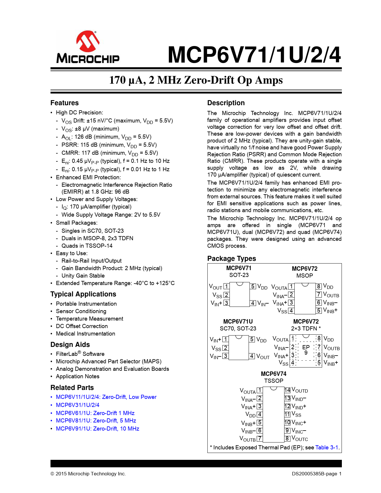

DescriptionThe MCP6V7x family of operational amplifiers provides input offset voltage correction for very low offset and offset drift

MCP6V71/1U/2/4. 170 µA, 2 MHz Zero-Drift Op Amps. Features. Description. Package Types. MCP6V71. MCP6V72. Typical Applications

MCP6V71/1U/2/4 170 µA, 2 MHz Zero-Drift Op Amps Features Description
• High DC Precision: The Microchip Technology Inc. MCP6V71/1U/2/4 - VOS Drift: ±15 nV/°C (maximum, VDD = 5.5V) family of operational amplifiers provides input offset - V voltage correction for very low offset and offset drift. OS: ±8 µV (maximum) - A These are low-power devices with a gain bandwidth OL: 126 dB (minimum, VDD = 5.5V) product of 2 MHz (typical). They are unity-gain stable, - PSRR: 115 dB (minimum, VDD = 5.5V) have virtually no 1/f noise and have good Power Supply - CMRR: 117 dB (minimum, VDD = 5.5V) Rejection Ratio (PSRR) and Common Mode Rejection - Eni: 0.45 µVP-P (typical), f = 0.1 Hz to 10 Hz Ratio (CMRR). These products operate with a single - E supply voltage as low as 2V, while drawing ni: 0.15 µVP-P (typical), f = 0.01 Hz to 1 Hz • Enhanced EMI Protection: 170 µA/amplifier (typical) of quiescent current. - Electromagnetic Interference Rejection Ratio The MCP6V71/1U/2/4 family has enhanced EMI pro- (EMIRR) at 1.8 GHz: 96 dB tection to minimize any electromagnetic interference • Low Power and Supply Voltages: from external sources. This feature makes it well suited for EMI sensitive applications such as power lines, - IQ: 170 µA/amplifier (typical) radio stations and mobile communications, etc. - Wide Supply Voltage Range: 2V to 5.5V The Microchip Technology Inc. MCP6V71/1U/2/4 op • Smal Packages: amps are offered in single (MCP6V71 and - Singles in SC70, SOT-23 MCP6V71U), dual (MCP6V72) and quad (MCP6V74) - Duals in MSOP-8, 2x3 TDFN packages. They were designed using an advanced - Quads in TSSOP-14 CMOS process. • Easy to Use: - Rail-to-Rail Input/Output
Package Types
- Gain Bandwidth Product: 2 MHz (typical)
MCP6V71 MCP6V72
- Unity Gain Stable SOT-23 MSOP • Extended Temperature Range: -40°C to +125°C VOUT 1 5 VDD V 1 8 V OUTA DD
V V SS 2 VINA– 2 7 OUTB • Portable Instrumentation VIN+ 3 4 VIN– VINA+ 3 6 VINB– • Sensor Conditioning VSS 4 5 VINB+ • Temperature Measurement
MCP6V71U MCP6V72
• DC Offset Correction SC70, SOT-23 2×3 TDFN * • Medical Instrumentation V V V IN+ 1 5 VDD OUTA 1 8 DD
Design Aids
V V 2 EP 7 V SS 2 INA– OUTB • FilterLab® Software V V 3 9 6 V IN– 3 4 VOUT INA+ INB– • Microchip Advanced Part Selector (MAPS) VSS 4 5 VINB+ • Analog Demonstration and Evaluation Boards • Application Notes
MCP6V74
TSSOP
Related Parts
