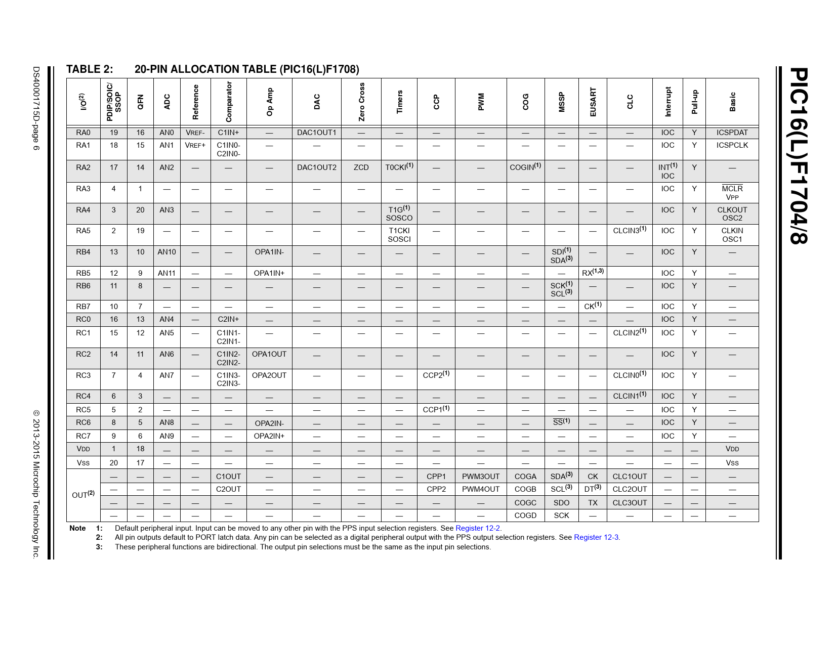

PIC16(L)F1704/8. TABLE 2:. 20-PIN ALLOCATION TABLE (PIC16(L)F1708). / C. ros. rru. ll-u. SSO. ADC. DAC. CCP. EUSART. (1). (3). (1,3). (2). Note

PIC16(L)F1704/8 TABLE 2: 20-PIN ALLOCATION TABLE (PIC16(L)F1708)

/ C e or s c p t ) p p OI P n at ros rs P ic (2 N m ar e M G S C s O /S re p A C rru ll-u I/ m IP SSO QF ADC fe CL m DAC ro CCP PW CO MS te Ba D Ti o Op EUSART In Pu P Re C Ze
RA0 19 16 AN0 VREF- C1IN+ — DAC1OUT1 — — — — — — — — IOC Y ICSPDAT RA1 18 15 AN1 VREF+ C1IN0- — — — — — — — — — — IOC Y ICSPCLK C2IN0- RA2 17 14 AN2 — — — DAC1OUT2 ZCD T0CKI

Note 1:
Default peripheral input. Input can be moved to any other pin with the PPS input selection registers. See Register 12-2.
2:
All pin outputs default to PORT latch data. Any pin can be selected as a digital peripheral output with the PPS output selection registers. See Register 12-3. Inc
