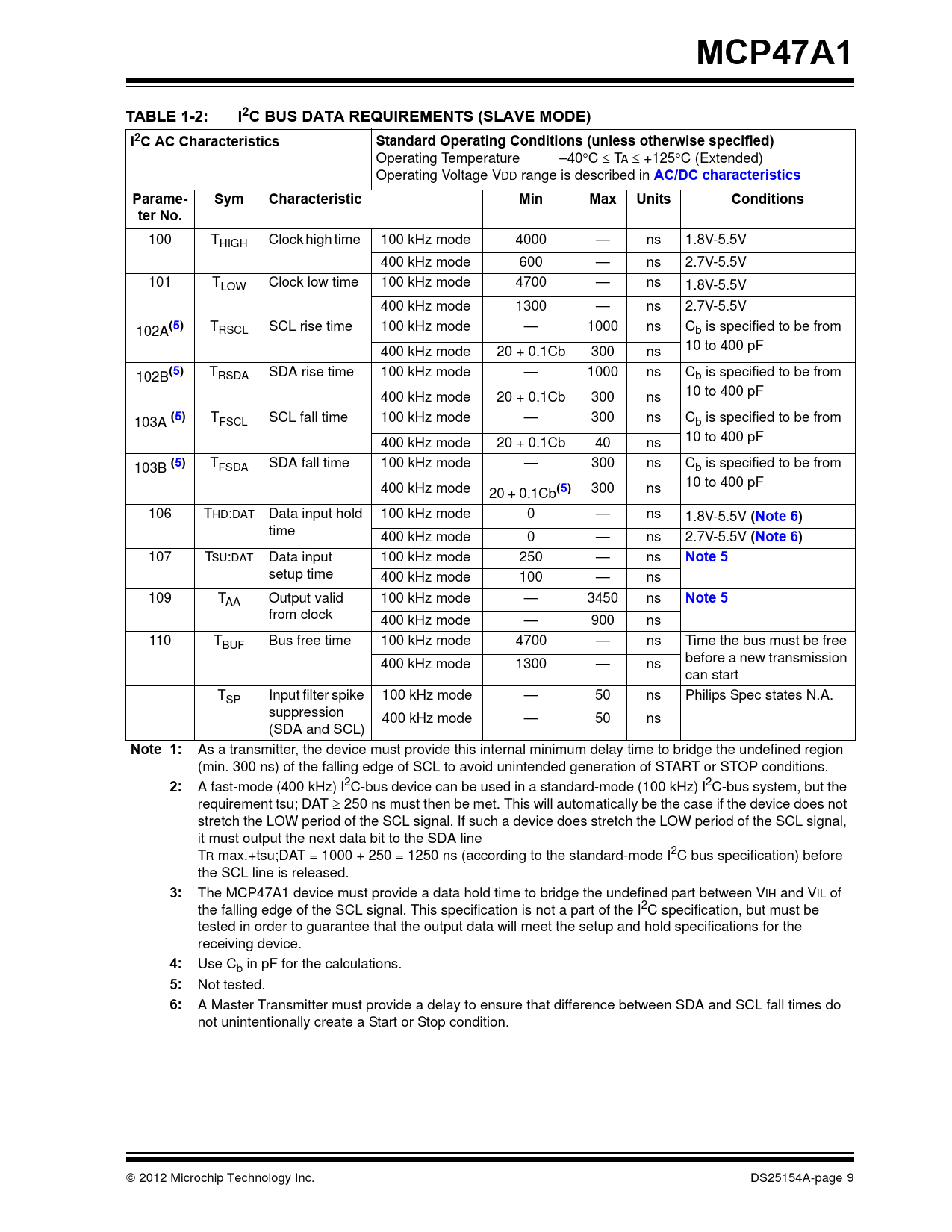

Pages / Page70 / 9 — MCP47A1. TABLE 1-2:. I2C BUS DATA REQUIREMENTS (SLAVE MODE). I2C AC …
MCP47A1. TABLE 1-2:. I2C BUS DATA REQUIREMENTS (SLAVE MODE). I2C AC Characteristics
MCP47A1 TABLE 1-2: I2C BUS DATA REQUIREMENTS (SLAVE MODE) I2C AC Characteristics
link to page 4
MCP47A1 TABLE 1-2: I2C BUS DATA REQUIREMENTS (SLAVE MODE) I2C AC Characteristics Standard Operating Conditions (unless otherwise specified)
Operating Temperature –40C  TA  +125C (Extended) Operating Voltage VDD range is described in
AC/DC characteristics Parame- Sym Characteristic Min Max Units Conditions ter No.
100 THIGH Clock high time 100 kHz mode 4000 — ns 1.8V-5.5V 400 kHz mode 600 — ns 2.7V-5.5V 101 TLOW Clock low time 100 kHz mode 4700 — ns 1.8V-5.5V 400 kHz mode 1300 — ns 2.7V-5.5V
(5)
102A TRSCL SCL rise time 100 kHz mode — 1000 ns Cb is specified to be from 10 to 400 pF 400 kHz mode 20 + 0.1Cb 300 ns
(5)
102B TRSDA SDA rise time 100 kHz mode — 1000 ns Cb is specified to be from 10 to 400 pF 400 kHz mode 20 + 0.1Cb 300 ns
(5)
103A TFSCL SCL fall time 100 kHz mode — 300 ns Cb is specified to be from 10 to 400 pF 400 kHz mode 20 + 0.1Cb 40 ns
(5)
103B TFSDA SDA fall time 100 kHz mode — 300 ns Cb is specified to be from 10 to 400 pF 400 kHz mode
(5)
20 + 0.1Cb 300 ns 106 THD:DAT Data input hold 100 kHz mode 0 — ns 1.8V-5.5V
(Note 6)
time 400 kHz mode 0 — ns 2.7V-5.5V
(Note 6)
107 TSU:DAT Data input 100 kHz mode 250 — ns
Note 5
setup time 400 kHz mode 100 — ns 109 TAA Output valid 100 kHz mode — 3450 ns
Note 5
from clock 400 kHz mode — 900 ns 110 TBUF Bus free time 100 kHz mode 4700 — ns Time the bus must be free before a new transmission 400 kHz mode 1300 — ns can start TSP Input filter spike 100 kHz mode — 50 ns Philips Spec states N.A. suppression 400 kHz mode — 50 ns (SDA and SCL)
Note 1:
As a transmitter, the device must provide this internal minimum delay time to bridge the undefined region (min. 300 ns) of the falling edge of SCL to avoid unintended generation of START or STOP conditions.
2:
A fast-mode (400 kHz) I2C-bus device can be used in a standard-mode (100 kHz) I2C-bus system, but the requirement tsu; DAT  250 ns must then be met. This will automatically be the case if the device does not stretch the LOW period of the SCL signal. If such a device does stretch the LOW period of the SCL signal, it must output the next data bit to the SDA line TR max.+tsu;DAT = 1000 + 250 = 1250 ns (according to the standard-mode I2C bus specification) before the SCL line is released.
3:
The MCP47A1 device must provide a data hold time to bridge the undefined part between VIH and VIL of the falling edge of the SCL signal. This specification is not a part of the I2C specification, but must be tested in order to guarantee that the output data will meet the setup and hold specifications for the receiving device.
4:
Use Cb in pF for the calculations.
5:
Not tested.
6:
A Master Transmitter must provide a delay to ensure that difference between SDA and SCL fall times do not unintentionally create a Start or Stop condition.  2012 Microchip Technology Inc. DS25154A-page 9 Document Outline 1.0 Electrical Characteristics 1.1 I2C Mode Timing Waveforms and Requirements FIGURE 1-1: I2C Bus Start/Stop Bits Timing Waveforms. FIGURE 1-2: I2C Bus Data Timing. TABLE 1-1: I2C Bus Start/Stop Bits Requirements TABLE 1-2: I2C Bus Data Requirements (Slave Mode) 2.0 Typical Performance Curves FIGURE 2-1: INL vs. Code (00h to 3Fh) and Temperature. VDD = 5.5V, VREF = 5.5V, 2.7V, 1.8V, and 1.0V. FIGURE 2-2: INL vs. Code (00h to 3Fh) and Temperature. VDD = 2.7V, VREF = 2.7V, 1.8V, and 1.0V. FIGURE 2-3: INL vs. Code (00h to 3Fh) and Temperature. VDD = 2.0V, VREF = 2.0V, 1.8V, and 1.0V. FIGURE 2-4: INL vs. Code (00h to 3Fh) and Temperature. VDD = 1.8V, VREF = 1.6V, and 1.0V. FIGURE 2-5: DNL vs. Code (00h to 3Fh) and Temperature. VDD = 5.5V, VREF = 5.5V, 2.7V, 1.8V, and 1.0V. FIGURE 2-6: DNL vs. Code (00h to 3Fh) and Temperature. VDD = 2.7V, VREF = 2.7V, 1.8V, and 1.0V. FIGURE 2-7: DNL vs. Code (00h to 3Fh) and Temperature. VDD = 2.0V, VREF = 2.0V, 1.8V, and 1.0V. FIGURE 2-8: DNL vs. Code (00h to 3Fh) and Temperature. VDD = 1.8V, VREF = 1.6V, and 1.0V. FIGURE 2-9: Full Scale Error (FSE) vs. Temperature. VDD = 5.5V, VREF = 5.5V, 2.7V, 1.8V, and 1.0V. FIGURE 2-10: Full Scale Error (FSE) vs. Temperature. VDD = 2.7V, VREF = 2.7V, 1.8V, and 1.0V. FIGURE 2-11: Full Scale Error (FSE) vs. Temperature. VDD = 2.0V, VREF = 2.0V, 1.8V, and 1.0V. FIGURE 2-12: Full Scale Error (FSE) vs. Temperature. VDD = 1.8V, VREF = 1.6V, and 1.0V. FIGURE 2-13: Zero Scale Error (ZSE) vs. Temperature. VDD = 5.5V, VREF = 5.5V, 2.7V, 1.8V, and 1.0V. FIGURE 2-14: Zero Scale Error (ZSE) vs. Temperature. VDD = 2.7V, VREF = 2.7V, 1.8V, and 1.0V. FIGURE 2-15: Zero Scale Error (ZSE) vs. Temperature. VDD = 2.0V, VREF = 2.0V, 1.8V, and 1.0V. FIGURE 2-16: Zero Scale Error (ZSE) vs. Temperature. VDD = 1.8V, VREF = 1.6V, and 1.0V. FIGURE 2-17: Total Unadjusted Error vs. Code and Temperature. VDD = 5.5V, VREF = 5.5V, 2.7V, 1.8V, and 1.0V. FIGURE 2-18: Total Unadjusted Error vs. Code and Temperature. VDD = 2.7V, VREF = 2.7V, 1.8V, and 1.0V. FIGURE 2-19: Total Unadjusted Error vs. Code and Temperature. VDD = 2.0V, VREF = 2.0V, 1.8V, and 1.0V. FIGURE 2-20: Total Unadjusted Error vs. Code and Temperature. VDD = 1.8V, VREF = 1.6V, and 1.0V. FIGURE 2-21: VOUT Tempco vs. Code ( (VOUT(+125C) - VOUT(-40C) / VOUT(+25C,Code=FS) / 165 ) * 1,000,000 ), VDD = 5.5V, VREF = 5.5V, 2.7V, 1.8V, and 1.0V. FIGURE 2-22: VOUT Tempco vs. Code ( (VOUT(+125C) - VOUT(-40C) / VOUT(+25C,Code=FS) / 165 ) * 1,000,000 ), VDD = 2.7V, VREF = 2.7V, 1.8V, and 1.0V. FIGURE 2-23: VOUT Tempco vs. Code ( (VOUT(+125C) - VOUT(-40C) / VOUT(+25C,Code=FS) / 165 ) * 1,000,000 ), VDD = 2.0V, VREF = 2.0V, 1.8V, and 1.0V. FIGURE 2-24: VOUT Tempco vs. Code ( (VOUT(+125C) - VOUT(-40C) / VOUT(+25C,Code=FS) / 165 ) * 1,000,000 ), VDD = 1.8V, VREF = 1.6V, and 1.0V. FIGURE 2-25: VIH / VIL Threshold of SDA/SCL Inputs vs. Temperature and VDD. FIGURE 2-26: VOL (SDA) vs. VDD and Temperature. FIGURE 2-27: Interface Active Current (IDD) vs. SCL Frequency (fSCL) and Temperature VDD = 1.8V, 2.7V and 5.5V, VREF = 1.0V and VDD. (no load on VOUT). FIGURE 2-28: Interface Inactive Current (STATIC) vs. Temperature and VDD. VDD = 1.8V, 2.7V and 5.5V, VREF = 1.0V and VDD. (no load on VOUT, SCL = SDA = VDD). FIGURE 2-29: VOUT vs. Resistive Load. VDD = 5.0V. FIGURE 2-30: VOUT vs. Resistive Load. VDD = 2.7V. FIGURE 2-31: VOUT vs. Source / Sink Current. VDD = 5.0V. FIGURE 2-32: VOUT vs. Source / Sink Current. VDD = 2.7V. FIGURE 2-33: VOUT Accuracy vs. VDD and Temperature. FIGURE 2-34: RVREF Resistances vs. VDD and Temperature. FIGURE 2-35: -3dB Bandwidth vs Frequency, VDD = 5.5V. FIGURE 2-36: Zero-Scale to Full-Scale Settling Time (00h to 40h), VDD = 5.0V, VREF = 5.0V, RL = 5kW, CL = 200 pF (Time scale = 2 µs / div). FIGURE 2-37: Full-Scale to Zero-Scale Settling Time (40h to 00h), VDD = 5.0V, VREF = 5.0V, RL = 5kW, CL = 200 pF (Time scale = 2 µs / div). FIGURE 2-38: Half-Scale Settling Time (10h to 30h), VDD = 5.0V, VREF = 5.0V, RL = 5kW, CL = 200 pF. (Time scale = 2 µs / div) FIGURE 2-39: Half-Scale Settling Time (30h to 10h), VDD = 5.0V, VREF = 5.0V, RL = 5kW, CL = 200 pF (Time scale = 2 µs / div). FIGURE 2-40: Digital Feedthrough (SCL signal coupling to VOUT pin); VDD = 5.0V, VREF = 5.0V, FSCL = 100 kHz, VOUT = 20h (VOUT Voltage Scale = 20 mV/div, Time scale = 2 µs / div). 2.1 Test Circuit FIGURE 2-41: -3 db Gain vs. Frequency Test. 3.0 Pin Descriptions TABLE 3-1: Pinout Description for The MCP47A1 3.1 Positive Power Supply Input (VDD) 3.2 Ground (VSS) 3.3 I2C Serial Clock (SCL) 3.4 I2C Serial Data (SDA) 3.5 Analog Output Voltage Pin (VOUT) 3.6 Voltage Reference Pin (VREF) 4.0 General Overview FIGURE 4-1: Resistor Network and Output Buffer Block Diagram. 4.1 POR/BOR Operation TABLE 4-1: Default POR Wiper Setting Selection TABLE 4-2: Device functionality at each VDD Region FIGURE 4-2: Power-up and Brown-out. 5.0 Serial Interface - I2C Module FIGURE 5-1: Typical Application I2C Bus Configurations. 5.1 I2C I/O Considerations 5.2 I2C Bit Definitions FIGURE 5-2: Start Bit. FIGURE 5-3: Data Bit. FIGURE 5-4: Acknowledge Waveform. TABLE 5-1: MCP47A1 A / A Responses FIGURE 5-5: Repeat Start Condition Waveform. FIGURE 5-6: Stop Condition Receive or Transmit Mode. FIGURE 5-7: Typical 16-bit I2C Waveform Format. FIGURE 5-8: I2C Data States and Bit Sequence. FIGURE 5-9: Slave Address Bits in the I2C Control Byte. TABLE 5-2: Device I2C Address FIGURE 5-10: General Call Formats. 5.3 Serial Commands FIGURE 5-11: I2C Single Byte Write Command Format. FIGURE 5-12: I2C Write Command Format. FIGURE 5-13: I2C Write Communication Behavior. FIGURE 5-14: I2C Read Command Format. FIGURE 5-15: I2C Read Communication Behavior. 6.0 Resistor Network 6.1 RVREF Resistance FIGURE 6-1: Resistor Network and Output Buffer Block Diagram. 6.2 RAB Resistor Ladder 6.3 Serial Buffer to Wiper Register Decode TABLE 6-1: Serial Shift Register value to Wiper Value 6.4 Resistor Variations (Voltage and Temperature) 6.5 POR Value TABLE 6-2: POR/BOR Settings 7.0 Output Buffer 7.1 Output Buffer / VOUT Operation FIGURE 7-1: Output Buffer Block Diagram. TABLE 7-1: Theoretical DAC Output Values FIGURE 7-2: Amplifier Input (VW) to Amplifier Output (VOUT) General Characteristics (VREF = VDD). FIGURE 7-3: Solving for VOUT, VREF, or DAC Register Code. 7.2 Output Slew Rate FIGURE 7-4: VOUT Pin Slew Rate. 7.3 Driving Resistive and Capacitive Loads FIGURE 7-5: Circuit to Stabilize Output Buffer for Large Capacitive Loads (CL). 7.4 Output Errors TABLE 7-2: Calculation Comparison FIGURE 7-6: Output Voltage (VOUT) Error. 8.0 Applications Examples 8.1 DC Set Point or Calibration FIGURE 8-1: Set Point or Threshold Calibration. FIGURE 8-2: Example Circuit Of Set Point or Threshold Calibration. FIGURE 8-3: Single-Supply “Window” DAC. 8.2 Selectable Gain and Offset Bipolar Voltage Output FIGURE 8-4: Bipolar Voltage Source with Selectable Gain and Offset Circuit. FIGURE 8-5: Simplified Bipolar Voltage Source with Selectable Gain and Offset Circuit. 8.3 Building Programmable Current Source FIGURE 8-6: Digitally-Controlled Current Source. 8.4 Serial Interface Communication Times TABLE 8-1: Serial Interface Times / Frequencies 8.5 Software I2C Interface Reset Sequence FIGURE 8-7: Software Reset Sequence Format. 8.6 Design Considerations FIGURE 8-8: Typical Microcontroller Connections. FIGURE 8-9: Example MCP47A1 Circuit. TABLE 8-2: Package Footprint FIGURE 8-10: I2C Bus Connection Test. 9.0 Development support 9.1 Evaluation/Demonstration Boards FIGURE 9-1: SC70EV Bond Out PCB – Top Layer and Silk-Screen. 9.2 Technical Documentation TABLE 9-1: Technical Documentation 10.0 Packaging Information 10.1 Package Marking Information Appendix A: Revision History Appendix B: Terminology Product Identification System Trademarks Worldwide Sales and Service
