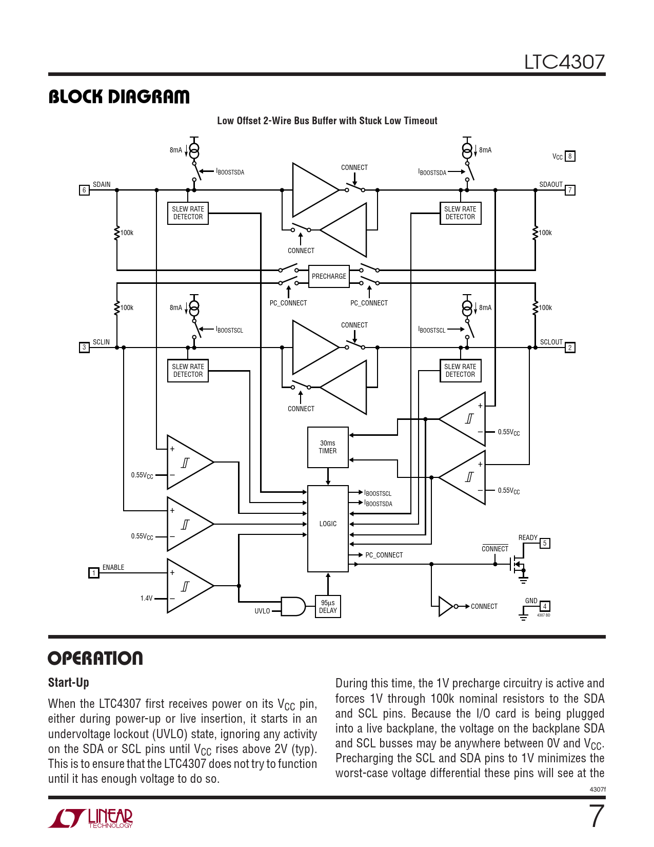

BLOCK DIAGRA. Low Offset 2-Wire Bus Buffer with Stuck Low Timeout. OPERATION. Start-Up
BLOCK DIAGRA Low Offset 2-Wire Bus Buffer with Stuck Low Timeout OPERATION Start-Up
LTC4307
W BLOCK DIAGRA Low Offset 2-Wire Bus Buffer with Stuck Low Timeout
8mA 8mA VCC 8 CONNECT IBOOSTSDA IBOOSTSDA SDAIN SDAOUT 6 7 SLEW RATE SLEW RATE DETECTOR DETECTOR 100k 100k CONNECT PRECHARGE PC_CONNECT PC_CONNECT 100k 8mA 8mA 100k CONNECT IBOOSTSCL IBOOSTSCL SCLIN SCLOUT 3 2 SLEW RATE SLEW RATE DETECTOR DETECTOR + CONNECT – 0.55VCC 30ms + TIMER + 0.55VCC – – 0.55V I CC BOOSTSCL IBOOSTSDA + LOGIC 0.55VCC – READY 5 CONNECT PC_CONNECT ENABLE 1 + 1.4V – GND 95μs CONNECT 4 UVLO DELAY 4307 BD
OPERATION Start-Up
During this time, the 1V precharge circuitry is active and When the LTC4307 fi rst receives power on its V forces 1V through 100k nominal resistors to the SDA CC pin, either during power-up or live insertion, it starts in an and SCL pins. Because the I/O card is being plugged undervoltage lockout (UVLO) state, ignoring any activity into a live backplane, the voltage on the backplane SDA on the SDA or SCL pins until V and SCL busses may be anywhere between 0V and VCC. CC rises above 2V (typ). This is to ensure that the LTC4307 does not try to function Precharging the SCL and SDA pins to 1V minimizes the until it has enough voltage to do so. worst-case voltage differential these pins will see at the 4307f 7
