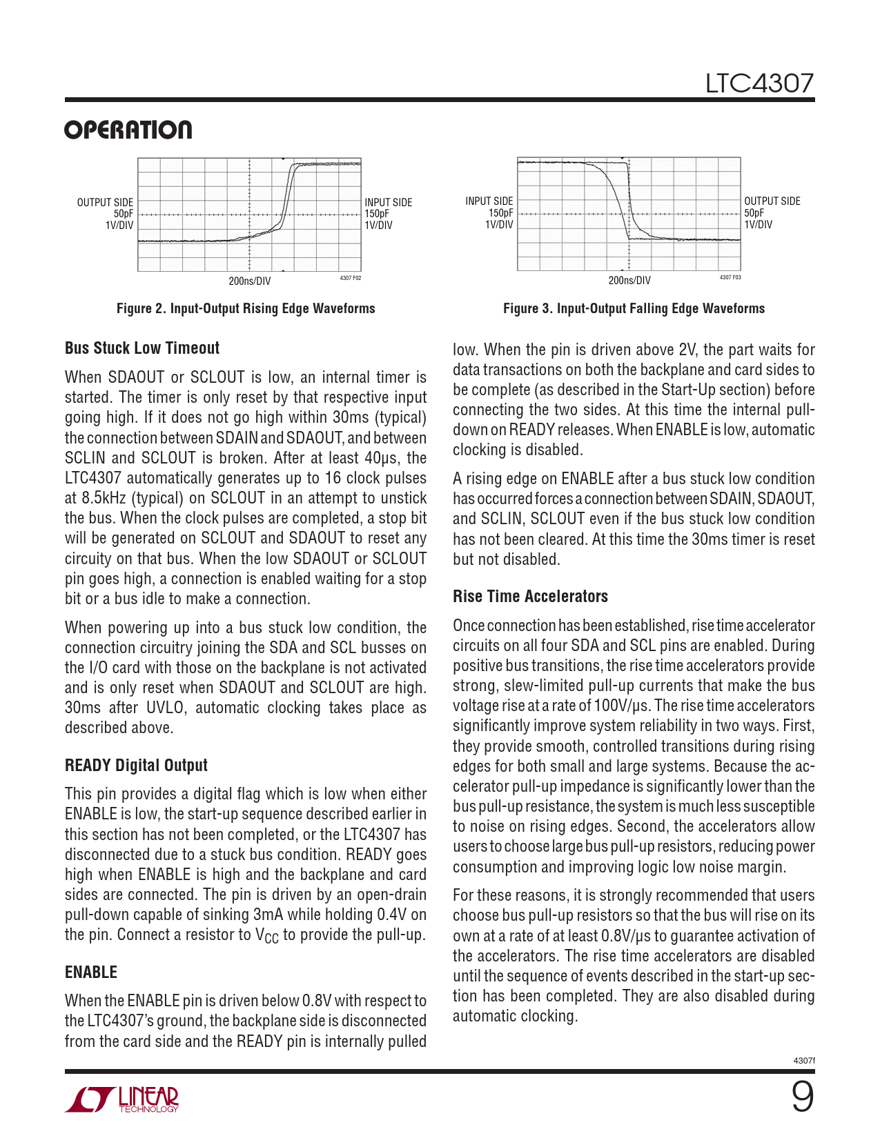

OUTPUT SIDE INPUT SIDE INPUT SIDE OUTPUT SIDE 50pF 150pF 150pF 50pF 1V/DIV 1V/DIV 1V/DIV 1V/DIV 200ns/DIV 4307 F02 200ns/DIV 4307 F03
Figure 2. Input-Output Rising Edge Waveforms Figure 3. Input-Output Falling Edge Waveforms Bus Stuck Low Timeout
low. When the pin is driven above 2V, the part waits for When SDAOUT or SCLOUT is low, an internal timer is data transactions on both the backplane and card sides to started. The timer is only reset by that respective input be complete (as described in the Start-Up section) before going high. If it does not go high within 30ms (typical) connecting the two sides. At this time the internal pull- the connection between SDAIN and SDAOUT, and between down on READY releases. When ENABLE is low, automatic SCLIN and SCLOUT is broken. After at least 40μs, the clocking is disabled. LTC4307 automatically generates up to 16 clock pulses A rising edge on ENABLE after a bus stuck low condition at 8.5kHz (typical) on SCLOUT in an attempt to unstick has occurred forces a connection between SDAIN, SDAOUT, the bus. When the clock pulses are completed, a stop bit and SCLIN, SCLOUT even if the bus stuck low condition will be generated on SCLOUT and SDAOUT to reset any has not been cleared. At this time the 30ms timer is reset circuity on that bus. When the low SDAOUT or SCLOUT but not disabled. pin goes high, a connection is enabled waiting for a stop bit or a bus idle to make a connection.
