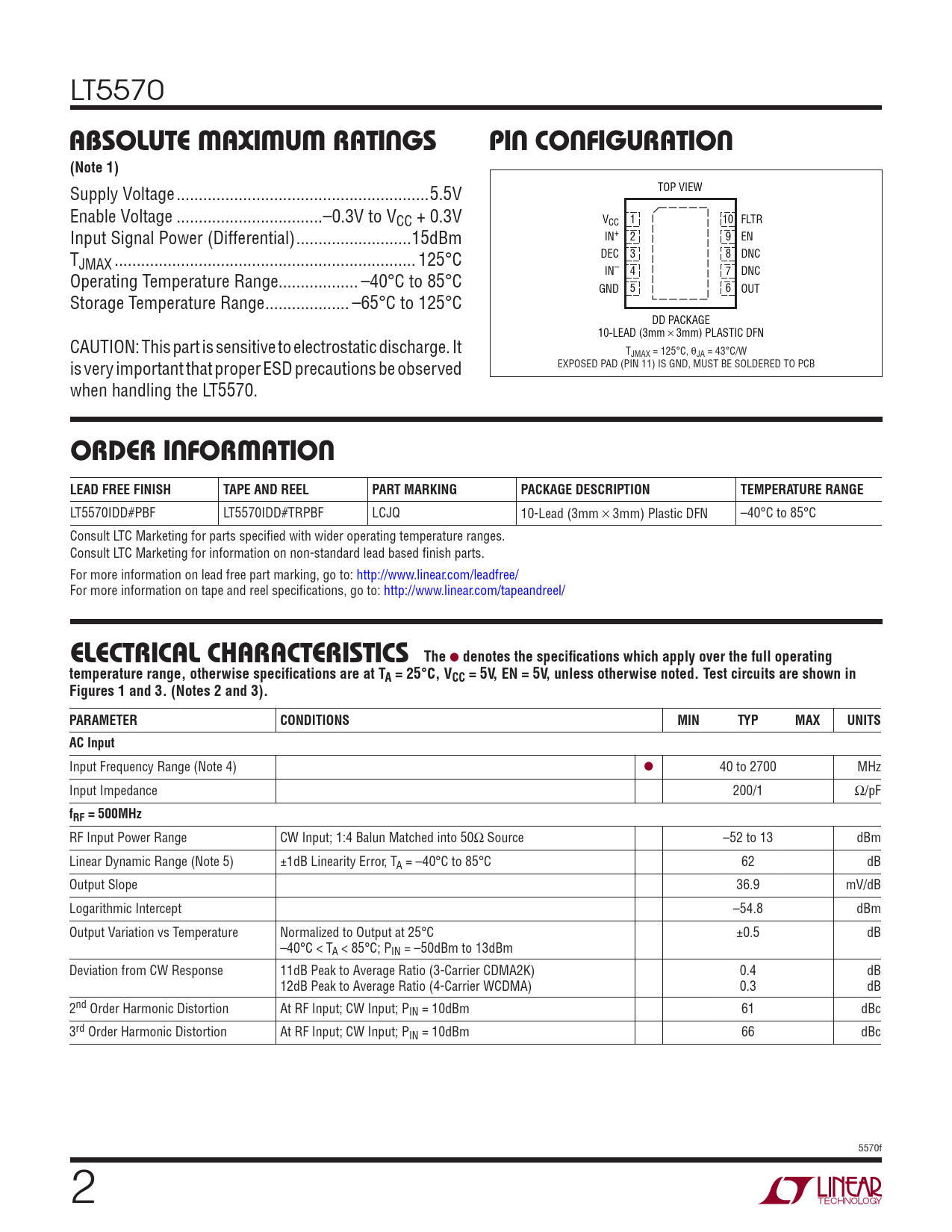

DescriptionFast Responding, 40MHz to 2.7GHz Mean-Squared Power Detector

ABSOLUTE MAXIMUM RATINGS PIN CONFIGURATION (Note 1)
Supply Voltage ...5.5V TOP VIEW Enable Voltage ...–0.3V to VCC + 0.3V V 1 10 FLTR CC Input Signal Power (Differential) ..15dBm IN+ 2 9 EN T DEC 3 8 DNC JMAX .. 125°C IN– 4 7 DNC Operating Temperature Range.. –40°C to 85°C GND 5 6 OUT Storage Temperature Range ... –65°C to 125°C DD PACKAGE 10-LEAD (3mm s 3mm) PLASTIC DFN CAUTION: This part is sensitive to electrostatic discharge. It TJMAX = 125°C, θJA = 43°C/W is very important that proper ESD precautions be observed EXPOSED PAD (PIN 11) IS GND, MUST BE SOLDERED TO PCB when handling the LT5570.

denotes the specifi cations which apply over the full operating temperature range, otherwise specifi cations are at TA = 25°C, VCC = 5V, EN = 5V, unless otherwise noted. Test circuits are shown in Figures 1 and 3. (Notes 2 and 3). PARAMETER CONDITIONS MIN TYP MAX UNITS AC Input
Input Frequency Range (Note 4) l 40 to 2700 MHz Input Impedance 200/1 Ω/pF
fRF = 500MHz
RF Input Power Range CW Input; 1:4 Balun Matched into 50Ω Source –52 to 13 dBm Linear Dynamic Range (Note 5) ±1dB Linearity Error, TA = –40°C to 85°C 62 dB Output Slope 36.9 mV/dB Logarithmic Intercept –54.8 dBm Output Variation vs Temperature Normalized to Output at 25°C ±0.5 dB –40°C < TA < 85°C; PIN = –50dBm to 13dBm Deviation from CW Response 11dB Peak to Average Ratio (3-Carrier CDMA2K) 0.4 dB 12dB Peak to Average Ratio (4-Carrier WCDMA) 0.3 dB 2nd Order Harmonic Distortion At RF Input; CW Input; PIN = 10dBm 61 dBc 3rd Order Harmonic Distortion At RF Input; CW Input; PIN = 10dBm 66 dBc 5570f 2
