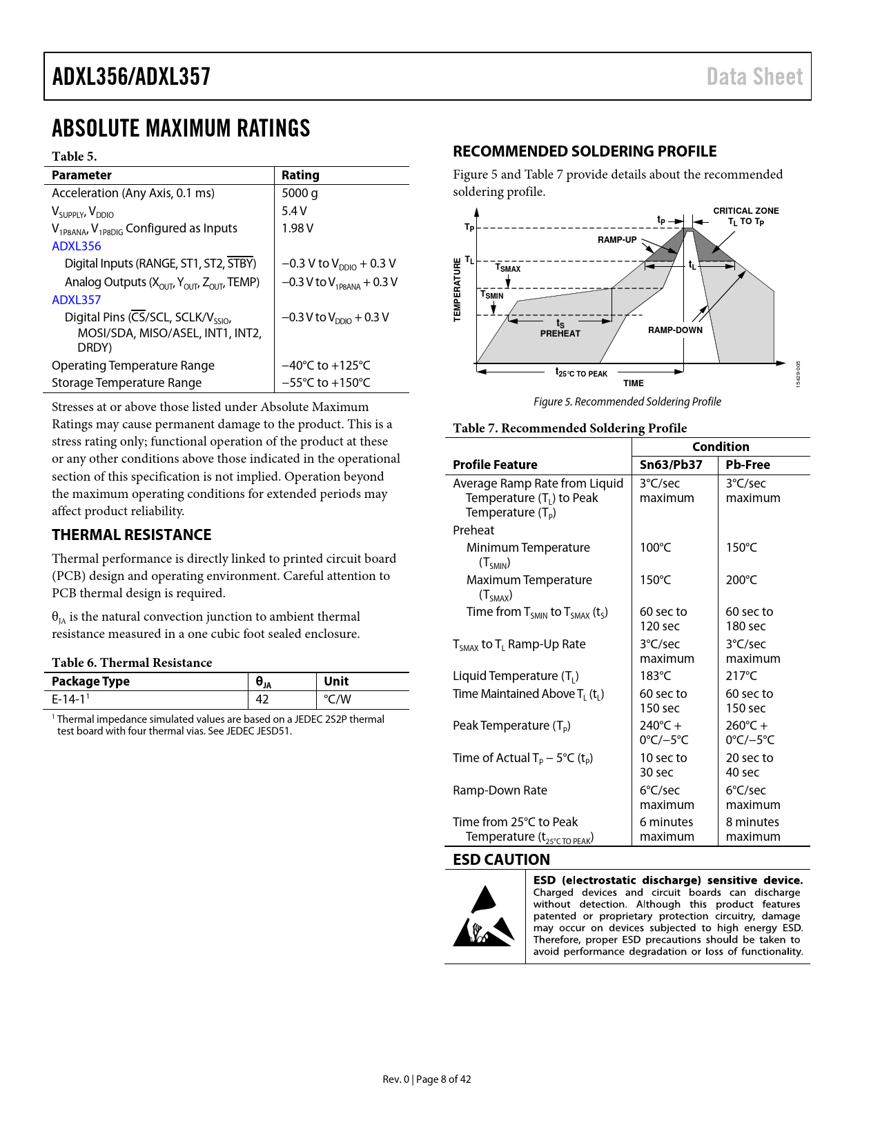

ADXL356/ADXL357. Data Sheet. ABSOLUTE MAXIMUM RATINGS Table 5. RECOMMENDED SOLDERING PROFILE. Parameter. Rating. CRITICAL ZONE
ADXL356/ADXL357 Data Sheet ABSOLUTE MAXIMUM RATINGS Table 5 RECOMMENDED SOLDERING PROFILE Parameter Rating CRITICAL ZONE
link to page 8 link to page 8
ADXL356/ADXL357 Data Sheet ABSOLUTE MAXIMUM RATINGS Table 5. RECOMMENDED SOLDERING PROFILE Parameter Rating
Figure 5 and Table 7 provide details about the recommended Acceleration (Any Axis, 0.1 ms) 5000 g soldering profile. V , V 5.4 V SUPPLY DDIO
CRITICAL ZONE t
V , V Configured as Inputs 1.98 V
P TL TO TP T
1P8ANA 1P8DIG
P
ADXL356
RAMP-UP
Digital Inputs (RANGE, ST1, ST2, STBY) −0.3 V to V + 0.3 V
TL
DDIO
T tL URE SMAX
Analog Outputs (X , Y , Z , TEMP) −0.3 V to V + 0.3 V OUT OUT OUT 1P8ANA
RAT
ADXL357
E TSMIN P M
Digital Pins (CS/SCL, SCLK/V , −0.3 V to V + 0.3 V
E
SSIO DDIO
T t
MOSI/SDA, MISO/ASEL, INT1, INT2,
S PREHEAT RAMP-DOWN
DRDY) Operating Temperature Range −40°C to +125°C
t
005
25°C TO PEAK
Storage Temperature Range −55°C to +150°C
TIME
15429- Stresses at or above those listed under Absolute Maximum Figure 5. Recommended Soldering Profile Ratings may cause permanent damage to the product. This is a
Table 7. Recommended Soldering Profile
stress rating only; functional operation of the product at these
Condition
or any other conditions above those indicated in the operational
Profile Feature Sn63/Pb37 Pb-Free
section of this specification is not implied. Operation beyond Average Ramp Rate from Liquid 3°C/sec 3°C/sec the maximum operating conditions for extended periods may Temperature (T ) to Peak L maximum maximum affect product reliability. Temperature (T ) P
THERMAL RESISTANCE
Preheat Minimum Temperature 100°C 150°C Thermal performance is directly linked to printed circuit board (T ) SMIN (PCB) design and operating environment. Careful attention to Maximum Temperature 150°C 200°C PCB thermal design is required. (T ) SMAX θ Time from T to T (t ) 60 sec to 60 sec to JA is the natural convection junction to ambient thermal SMIN SMAX S resistance measured in a one cubic foot sealed enclosure. 120 sec 180 sec T to T Ramp-Up Rate 3°C/sec 3°C/sec SMAX L
Table 6. Thermal Resistance
maximum maximum
Package Type θ Unit
Liquid Temperature (T ) 183°C 217°C L
JA
E-14-11 42 °C/W Time Maintained Above T (t ) 60 sec to 60 sec to L L 150 sec 150 sec 1 Thermal impedance simulated values are based on a JEDEC 2S2P thermal test board with four thermal vias. See JEDEC JESD51. Peak Temperature (T ) 240°C + 260°C + P 0°C/−5°C 0°C/−5°C Time of Actual T − 5°C (t ) 10 sec to 20 sec to P P 30 sec 40 sec Ramp-Down Rate 6°C/sec 6°C/sec maximum maximum Time from 25°C to Peak 6 minutes 8 minutes Temperature (t ) maximum maximum 25°C TO PEAK
