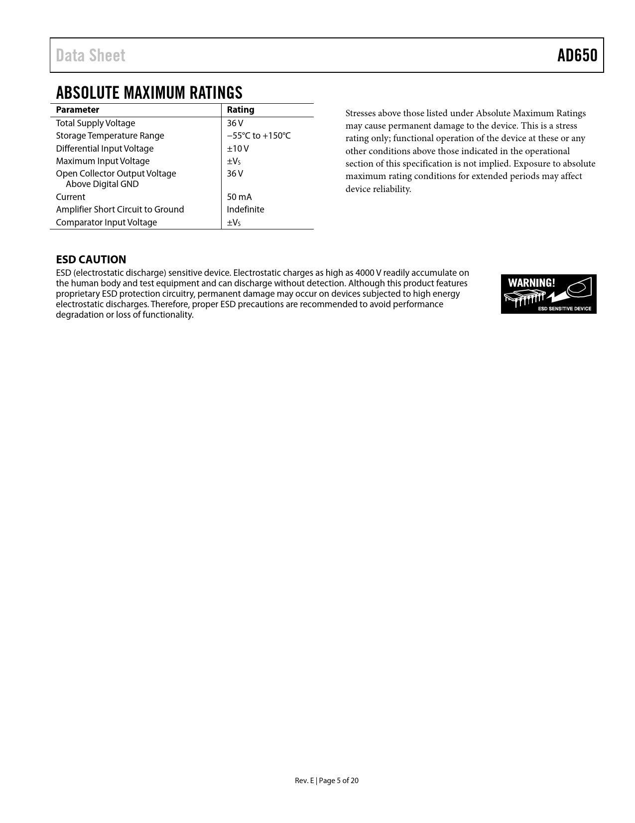

Data Sheet. AD650. ABSOLUTE MAXIMUM RATINGS Parameter. Rating. ESD CAUTION
Data Sheet AD650 ABSOLUTE MAXIMUM RATINGS Parameter Rating ESD CAUTION
Stresses above those listed under Absolute Maximum Ratings Total Supply Voltage 36 V may cause permanent damage to the device. This is a stress Storage Temperature Range −55°C to +150°C rating only; functional operation of the device at these or any Differential Input Voltage ±10 V other conditions above those indicated in the operational Maximum Input Voltage ±VS section of this specification is not implied. Exposure to absolute Open Collector Output Voltage 36 V maximum rating conditions for extended periods may affect Above Digital GND device reliability. Current 50 mA Amplifier Short Circuit to Ground Indefinite Comparator Input Voltage ±VS
ESD CAUTION
ESD (electrostatic discharge) sensitive device. Electrostatic charges as high as 4000 V readily accumulate on the human body and test equipment and can discharge without detection. Although this product features proprietary ESD protection circuitry, permanent damage may occur on devices subjected to high energy electrostatic discharges. Therefore, proper ESD precautions are recommended to avoid performance degradation or loss of functionality. Rev. E | Page 5 of 20 Document Outline Features Functional Block Diagram Product Description Product Highlights Revision History Specifications Absolute Maximum Ratings ESD Caution Pin Configurations and Function Descriptions Circuit Operation Unipolar Configuration One-Shot Timing Component Selection Bipolar V/F Unipolar V/F, Negative Input Voltage F/V Conversion High Frequency Operation Decoupling and Grounding Temperature Coefficients Nonlinearity Specification PSRR Other Circuit Considerations Applications Differential Voltage-to-Frequency Conversion Autozero Circuit Phase-Locked Loop F/V Conversion Outline Dimensions Ordering Guide
