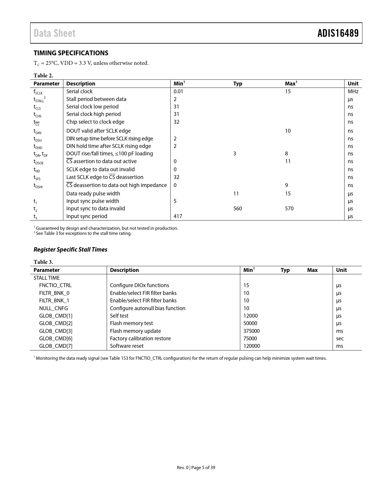

Data Sheet ADIS16489 TIMING SPECIFICATIONS
TC = 25°C, VDD = 3.3 V, unless otherwise noted.
Table 2. Parameter Description Min1 Typ Max1 Unit
f Serial clock 0.01 15 MHz SCLK t 2 Stall period between data 2 µs STALL t Serial clock low period 31 ns CLS t Serial clock high period 31 ns CHS t Chip select to clock edge 32 ns CS t DOUT valid after SCLK edge 10 ns DAV t DIN setup time before SCLK rising edge 2 ns DSU t DIN hold time after SCLK rising edge 2 ns DHD t , t DOUT rise/fall times, ≤100 pF loading 3 8 ns DR DF t DSOE CS assertion to data out active 0 11 ns t SCLK edge to data out invalid 0 ns HD t Last SCLK edge to SFS CS deassertion 32 ns t DSHI CS deassertion to data out high impedance 0 9 ns Data ready pulse width 11 15 µs t Input sync pulse width 5 µs 1 t Input sync to data invalid 560 570 µs 2 t Input sync period 417 µs 3 1 Guaranteed by design and characterization, but not tested in production. 2 See Table 3 for exceptions to the stal time rating.
Register Specific Stall Times Table 3. Parameter Description Min1 Typ Max Unit
STALL TIME FNCTIO_CTRL Configure DIOx functions 15 μs FILTR_BNK_0 Enable/select FIR filter banks 10 μs FILTR_BNK_1 Enable/select FIR filter banks 10 μs NULL_CNFG Configure autonull bias function 10 μs GLOB_CMD[1] Self test 12000 μs GLOB_CMD[2] Flash memory test 50000 μs GLOB_CMD[3] Flash memory update 375000 ms GLOB_CMD[6] Factory calibration restore 75000 sec GLOB_CMD[7] Software reset 120000 ms 1 Monitoring the data ready signal (see Table 153 for FNCTIO_CTRL configuration) for the return of regular pulsing can help minimize system wait times. Rev. 0 | Page 5 of 39 Document Outline Features Applications General Description Functional block Diagram Revision History Specifications Timing Specifications Register Specific Stall Times Timing Diagrams Absolute Maximum Ratings Thermal Resistance ESD Caution Pin Configuration and Function Descriptions Typical Performance Characteristics Theory of Operation Introduction Register Structure SPI Communication Device Configuration Dual Memory Structure Reading Sensor Data User Register Memory Map User Register Defintions Page 0 (PAGE_ID) Sample Sequence Counter (SEQ_CNT) Status/Error Flag Indicators (SYS_E_FLAG) Self Test Error Flags (DIAG_STS) Alarm Error Flags (ALM_STS) Internal Temperature (TEMP_OUT) Gyroscope Data X-Axis Gyroscope (X_GYRO_LOW, X_GYRO_OUT) Y-Axis Gyroscope (Y_GYRO_LOW, Y_GYRO_OUT) Z-Axis Gyroscope (Z_GYRO_LOW, Z_GYRO_OUT) Gyroscope Resolution Acceleration Data X-Axis Accelerometer (X_ACCL_LOW, X_ACCL_OUT) Y-Axis Accelerometer (Y_ACCL_LOW, Y_ACCL_OUT) Z-Axis Accelerometer (Z_ACCL_LOW, Z_ACCL_OUT) Accelerometer Resolution Barometer Data Barometer (BAROM_LOW, BAROM_OUT) Barometer Resolution Delta Angles X-Axis Delta Angle (X_DELTANG_LOW, X_DELTANG_OUT) Y-Axis Delta Angle (Y_DELTANG_LOW, Y_DELTANG_OUT) Z-Axis Delta Angle (Z_DELTANG_LOW, Z_DELTANG_OUT) Delta Angle Resolution Delta Velocity X-Axis Delta Velocity (X_DELTVEL_LOW, X_DELTVEL_OUT) Y-Axis Delta Velocity (Y_DELTVEL_LOW, Y_DELTVEL_OUT) Z-Axis Delta Velocity (Z_DELTVEL_LOW, Z_DELTVEL_OUT) Delta Velocity Resolution Real-Time Clock Real-Time Clock: Minutes/Seconds (TIME_MS_OUT) Real-Time Clock: Days/Hours (TIME_DH_OUT) Real-Time Clock: Years/Months (TIME_YM_OUT) Product Identification ( PROD_ID) Page 2 (PAGE_ID) Calibration Calibration, Gyroscope Scale (X_GYRO_SCALE) Calibration, Gyroscope Scale (Y_GYRO_SCALE) Calibration, Gyroscope Scale (Z_GYRO_SCALE) Calibration, Accelerometer Scale (X_ACCL_SCALE) Calibration, Accelerometer Scale (Y_ACCL_SCALE) Calibration, Accelerometer Scale (Z_ACCL_SCALE) Calibration, Gyroscope Bias (XG_BIAS_LOW, XG_BIAS_HIGH) Calibration, Gyroscope Bias (YG_BIAS_LOW, YG_BIAS_HIGH) Calibration, Gyroscope Bias (ZG_BIAS_LOW, ZG_BIAS_HIGH) Calibration, Accelerometer Bias (XA_BIAS_LOW, XA_BIAS_HIGH) Calibration, Accelerometer Bias (YA_BIAS_LOW, YA_BIAS_HIGH) Calibration, Accelerometer Bias (ZA_BIAS_LOW, ZA_BIAS_HIGH) Barometers Calibration, Barometer Bias (BR_BIAS_LOW, BR_BIAS_HIGH) Scratch Registers (USER_SCR_x) Flash Memory Endurance Counter (FLSHCNT_LOW, FLSHCNT_HIGH) Page 3 (PAGE_ID) Global Commands (GLOB_CMD) Software Reset Factory Calibration Restore Flash Memory Update Flash Memory Test On Demand Self Test (ODST) Bias Correction Update Auxiliary I/O Line Configuration (FNCTIO_CTRL) Data Ready Indicator Input Sync/Clock Control Alarm Indicator General-Purpose I/O Control (GPIO_CTRL) Miscellaneous Configuration (CONFIG) Point of Percussion Linear Acceleration on Effect on Gyroscope Bias Decimation Filter (DEC_RATE) Continuous Bias Estimation (NULL_CNFG) Power Management (SLP_CNT) FIR Filter Control (FILTR_BNK_0, FILTR_BNK_1) Alarm Configuration (ALM_CNFG_0, ALM_CNFG_1, ALM_CFG_2) Solving for ΔX_ACCL_OUT, ΔZ_GYRO_OUT, ΔY_GYRO_OUT, and ΔX_GYRO_OUT Solving for ΔZ_ACCL_OUT and ΔY_ACCL_OUT X-Axis Gyroscope Alarm (XG_ALM_MAGN) Alarm Example Y-Axis Gyroscope Alarm (YG_ALM_MAGN) Z-Axis Gyroscope Alarm (ZG_ALM_MAGN) X-Axis Accelerometer Alarm (XA_ALM_MAGN) Y-Axis Accelerometer Alarm (YA_ALM_MAGN) Z-Axis Accelerometer Alarm (ZA_ALM_MAGN) Barometer Alarm (BR_ALM_MAGN) Firmware Revision (FIRM_REV) Firmware Revision Day and Month (FIRM_DM) Firmware Revision Year (FIRM_Y) Page 4 (PAGE_ID) Part Identification Numbers (PART_ID1, PART_ID2, PART_ID3, PART_ID4) FIR Filters Page 5, Page 6 (PAGE_ID) FIR Filter Bank A (FIR_COEF_A000 to FIR_COEF_A119) Page 7, Page 8 (PAGE_ID) FIR Filter Bank B (FIR_COEF_B000 to FIR_COEF_B119) Page 9, Page 10 (PAGE_ID) FIR Filter Bank C (FIR_COEF_C000 to FIR_COEF_C119) Page 11, Page 12 (PAGE_ID) FIR Filter Bank D (FIR_COEF_D000 to FIR_COEF_D119) Default Filter Performance Applications Information Mounting Best Practices Evaluation Tools Breakout Board, ADIS16IMU1/PCBZ PC-Based Evaluation, EVAL-ADIS Power Supply Considerations Packaging and Ordering Information Outline Dimensions Ordering Guide
