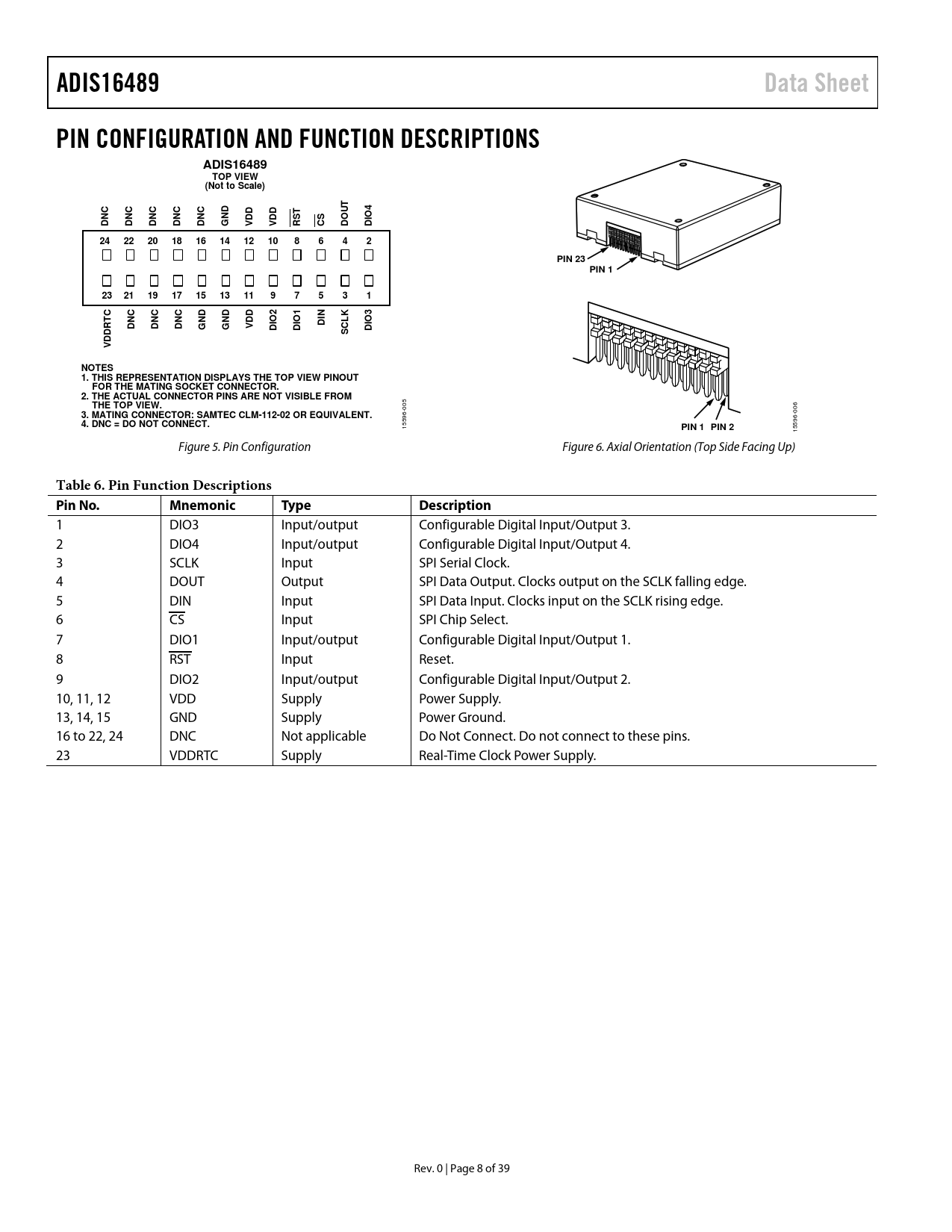

ADIS16489. Data Sheet. PIN CONFIGURATION AND FUNCTION DESCRIPTIONS. TOP VIEW. (Not to Scale). IO4. DNC. PIN 23. PIN 1. IO2. IO1. IO3. DDRT V
ADIS16489 Data Sheet PIN CONFIGURATION AND FUNCTION DESCRIPTIONS TOP VIEW (Not to Scale) IO4 DNC PIN 23 PIN 1 IO2 IO1 IO3 DDRT V
ADIS16489 Data Sheet PIN CONFIGURATION AND FUNCTION DESCRIPTIONS ADIS16489 TOP VIEW (Not to Scale) T UT ND DD DD IO4 DNC DNC DNC DNC DNC G V V RS CS DO D 24 22 20 18 16 14 12 10 8 6 4 2 PIN 23 PIN 1 23 21 19 17 15 13 11 9 7 5 3 1 C N K ND ND DD IO2 IO1 DI IO3 DNC DNC DNC G G V CL D D D S DDRT V NOTES 1. THIS REPRESENTATION DISPLAYS THE TOP VIEW PINOUT FOR THE MATING SOCKET CONNECTOR. 2. THE ACTUAL CONNECTOR PINS ARE NOT VISIBLE FROM THE TOP VIEW.
005 006
3. MATING CONNECTOR: SAMTEC CLM-112-02 OR EQUIVALENT. 4. DNC = DO NOT CONNECT.
15596-
PIN 1 PIN 2
15596- Figure 5. Pin Configuration Figure 6. Axial Orientation (Top Side Facing Up)
Table 6. Pin Function Descriptions Pin No. Mnemonic Type Description
1 DIO3 Input/output Configurable Digital Input/Output 3. 2 DIO4 Input/output Configurable Digital Input/Output 4. 3 SCLK Input SPI Serial Clock. 4 DOUT Output SPI Data Output. Clocks output on the SCLK falling edge. 5 DIN Input SPI Data Input. Clocks input on the SCLK rising edge. 6 CS Input SPI Chip Select. 7 DIO1 Input/output Configurable Digital Input/Output 1. 8 RST Input Reset. 9 DIO2 Input/output Configurable Digital Input/Output 2. 10, 11, 12 VDD Supply Power Supply. 13, 14, 15 GND Supply Power Ground. 16 to 22, 24 DNC Not applicable Do Not Connect. Do not connect to these pins. 23 VDDRTC Supply Real-Time Clock Power Supply. Rev. 0 | Page 8 of 39 Document Outline Features Applications General Description Functional block Diagram Revision History Specifications Timing Specifications Register Specific Stall Times Timing Diagrams Absolute Maximum Ratings Thermal Resistance ESD Caution Pin Configuration and Function Descriptions Typical Performance Characteristics Theory of Operation Introduction Register Structure SPI Communication Device Configuration Dual Memory Structure Reading Sensor Data User Register Memory Map User Register Defintions Page 0 (PAGE_ID) Sample Sequence Counter (SEQ_CNT) Status/Error Flag Indicators (SYS_E_FLAG) Self Test Error Flags (DIAG_STS) Alarm Error Flags (ALM_STS) Internal Temperature (TEMP_OUT) Gyroscope Data X-Axis Gyroscope (X_GYRO_LOW, X_GYRO_OUT) Y-Axis Gyroscope (Y_GYRO_LOW, Y_GYRO_OUT) Z-Axis Gyroscope (Z_GYRO_LOW, Z_GYRO_OUT) Gyroscope Resolution Acceleration Data X-Axis Accelerometer (X_ACCL_LOW, X_ACCL_OUT) Y-Axis Accelerometer (Y_ACCL_LOW, Y_ACCL_OUT) Z-Axis Accelerometer (Z_ACCL_LOW, Z_ACCL_OUT) Accelerometer Resolution Barometer Data Barometer (BAROM_LOW, BAROM_OUT) Barometer Resolution Delta Angles X-Axis Delta Angle (X_DELTANG_LOW, X_DELTANG_OUT) Y-Axis Delta Angle (Y_DELTANG_LOW, Y_DELTANG_OUT) Z-Axis Delta Angle (Z_DELTANG_LOW, Z_DELTANG_OUT) Delta Angle Resolution Delta Velocity X-Axis Delta Velocity (X_DELTVEL_LOW, X_DELTVEL_OUT) Y-Axis Delta Velocity (Y_DELTVEL_LOW, Y_DELTVEL_OUT) Z-Axis Delta Velocity (Z_DELTVEL_LOW, Z_DELTVEL_OUT) Delta Velocity Resolution Real-Time Clock Real-Time Clock: Minutes/Seconds (TIME_MS_OUT) Real-Time Clock: Days/Hours (TIME_DH_OUT) Real-Time Clock: Years/Months (TIME_YM_OUT) Product Identification ( PROD_ID) Page 2 (PAGE_ID) Calibration Calibration, Gyroscope Scale (X_GYRO_SCALE) Calibration, Gyroscope Scale (Y_GYRO_SCALE) Calibration, Gyroscope Scale (Z_GYRO_SCALE) Calibration, Accelerometer Scale (X_ACCL_SCALE) Calibration, Accelerometer Scale (Y_ACCL_SCALE) Calibration, Accelerometer Scale (Z_ACCL_SCALE) Calibration, Gyroscope Bias (XG_BIAS_LOW, XG_BIAS_HIGH) Calibration, Gyroscope Bias (YG_BIAS_LOW, YG_BIAS_HIGH) Calibration, Gyroscope Bias (ZG_BIAS_LOW, ZG_BIAS_HIGH) Calibration, Accelerometer Bias (XA_BIAS_LOW, XA_BIAS_HIGH) Calibration, Accelerometer Bias (YA_BIAS_LOW, YA_BIAS_HIGH) Calibration, Accelerometer Bias (ZA_BIAS_LOW, ZA_BIAS_HIGH) Barometers Calibration, Barometer Bias (BR_BIAS_LOW, BR_BIAS_HIGH) Scratch Registers (USER_SCR_x) Flash Memory Endurance Counter (FLSHCNT_LOW, FLSHCNT_HIGH) Page 3 (PAGE_ID) Global Commands (GLOB_CMD) Software Reset Factory Calibration Restore Flash Memory Update Flash Memory Test On Demand Self Test (ODST) Bias Correction Update Auxiliary I/O Line Configuration (FNCTIO_CTRL) Data Ready Indicator Input Sync/Clock Control Alarm Indicator General-Purpose I/O Control (GPIO_CTRL) Miscellaneous Configuration (CONFIG) Point of Percussion Linear Acceleration on Effect on Gyroscope Bias Decimation Filter (DEC_RATE) Continuous Bias Estimation (NULL_CNFG) Power Management (SLP_CNT) FIR Filter Control (FILTR_BNK_0, FILTR_BNK_1) Alarm Configuration (ALM_CNFG_0, ALM_CNFG_1, ALM_CFG_2) Solving for ΔX_ACCL_OUT, ΔZ_GYRO_OUT, ΔY_GYRO_OUT, and ΔX_GYRO_OUT Solving for ΔZ_ACCL_OUT and ΔY_ACCL_OUT X-Axis Gyroscope Alarm (XG_ALM_MAGN) Alarm Example Y-Axis Gyroscope Alarm (YG_ALM_MAGN) Z-Axis Gyroscope Alarm (ZG_ALM_MAGN) X-Axis Accelerometer Alarm (XA_ALM_MAGN) Y-Axis Accelerometer Alarm (YA_ALM_MAGN) Z-Axis Accelerometer Alarm (ZA_ALM_MAGN) Barometer Alarm (BR_ALM_MAGN) Firmware Revision (FIRM_REV) Firmware Revision Day and Month (FIRM_DM) Firmware Revision Year (FIRM_Y) Page 4 (PAGE_ID) Part Identification Numbers (PART_ID1, PART_ID2, PART_ID3, PART_ID4) FIR Filters Page 5, Page 6 (PAGE_ID) FIR Filter Bank A (FIR_COEF_A000 to FIR_COEF_A119) Page 7, Page 8 (PAGE_ID) FIR Filter Bank B (FIR_COEF_B000 to FIR_COEF_B119) Page 9, Page 10 (PAGE_ID) FIR Filter Bank C (FIR_COEF_C000 to FIR_COEF_C119) Page 11, Page 12 (PAGE_ID) FIR Filter Bank D (FIR_COEF_D000 to FIR_COEF_D119) Default Filter Performance Applications Information Mounting Best Practices Evaluation Tools Breakout Board, ADIS16IMU1/PCBZ PC-Based Evaluation, EVAL-ADIS Power Supply Considerations Packaging and Ordering Information Outline Dimensions Ordering Guide
