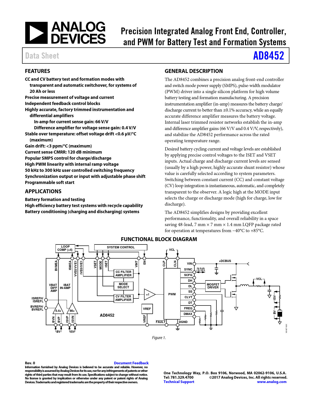

Precision Integrated Analog Front End, Controller, and PWM for Battery Test and Formation Systems Data Sheet AD8452 FEATURES GENERAL DESCRIPTION CC and CV battery test and formation modes with
The AD8452 combines a precision analog front-end controller
transparent and automatic switchover, for systems of
and switch mode power supply (SMPS), pulse-width modulator
20 Ah or less
(PWM) driver into a single silicon platform for high volume
Precise measurement of voltage and current
battery testing and formation manufacturing. A precision
Independent feedback control blocks
instrumentation amplifier (in-amp) measures the battery charge/
Highly accurate, factory trimmed instrumentation and
discharge current to better than ±0.1% accuracy, while an equally
differential amplifiers
accurate difference amplifier measures the battery voltage.
In-amp for current sense gain: 66 V/V
Internal laser trimmed resistor networks establish the in-amp
Difference amplifier for voltage sense gain: 0.4 V/V
and difference amplifier gains (66 V/V and 0.4 V/V, respectively),
Stable over temperature: offset voltage drift <0.6 μV/°C
and stabilize the AD8452 performance across the rated
(maximum)
operating temperature range.
Gain drift: <3 ppm/°C (maximum)
Desired battery cycling current and voltage levels are established
Current sense CMRR: 120 dB minimum
by applying precise control voltages to the ISET and VSET
Popular SMPS control for charge/discharge
inputs. Actual charge and discharge current levels are sensed
High PWM linearity with internal ramp voltage
(usually by a high power, highly accurate shunt resistor) whose
50 kHz to 300 kHz user controlled switching frequency
value is carefully selected according to system parameters.
Synchronization output or input with adjustable phase shift
Switching between constant current (CC) and constant voltage
Programmable soft start
(CV) loop integration is instantaneous, automatic, and completely
APPLICATIONS
transparent to the observer. A logic high at the MODE input
Battery formation and testing
selects the charge or discharge mode (high for charge, low for
High efficiency battery test systems with recycle capability
discharge).
Battery conditioning (charging and discharging) systems
The AD8452 simplifies designs by providing excellent performance, functionality, and overall reliability in a space saving 48-lead, 7 mm × 7 mm × 1.4 mm LQFP package rated for operation at temperatures from −40°C to +85°C.
FUNCTIONAL BLOCK DIAGRAM LOOP SYSTEM CONTROL COMP (×4) VCL A E T T P N +DCBUS N EN VIN ME ISE /IVE1 VI CL CL VSET IS /VVE1 MOD BVMEA SYNC CC FILTER IVE0 VVE0 AMPLIFIER SCFG VCL DH VBAT IBAT MODE MOSFET DL DIFF IN-AMP SELECT DRIVER AMP SS ×1 PWM CV FILTER V ISREFH/ CLVT IS ISREFL AMPLIFIER DT BVREFH/ BVREFL VREF FREQ 0.4× 66× BV AD8452 DMAX N P EF BV ISVN ISVP BV VR FAULT DGND
