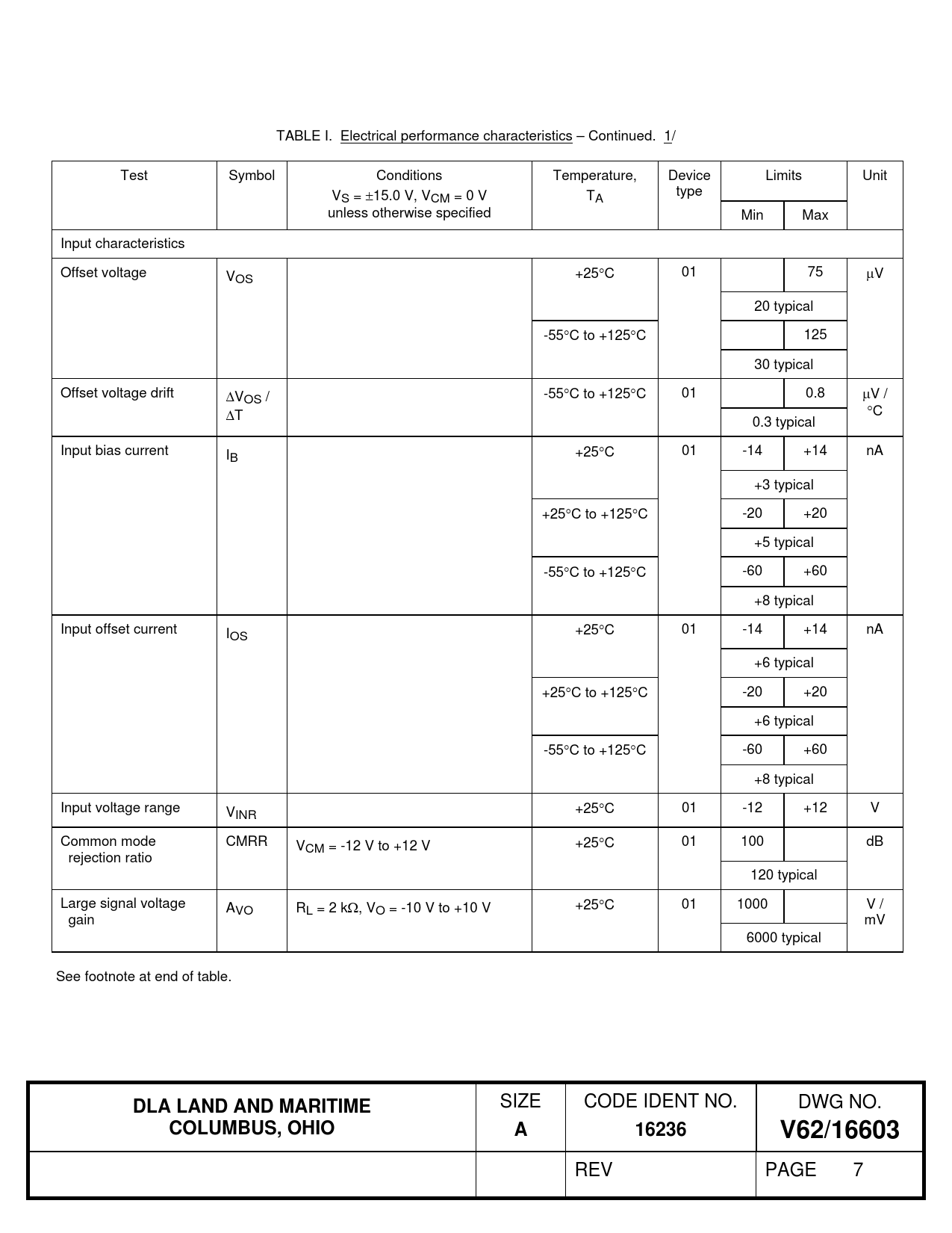

TABLE I. Electrical performance characteristics – Continued. 1/ Test Symbol Conditions Temperature, Device Limits Unit V type S = 15.0 V, VCM = 0 V TA unless otherwise specified Min Max Input characteristics Offset voltage VOS +25C 01 75 V 20 typical -55C to +125C 125 30 typical Offset voltage drift V -55C to +125C 01 0.8 V / OS / T C 0.3 typical Input bias current IB +25C 01 -14 +14 nA +3 typical +25C to +125C -20 +20 +5 typical -55C to +125C -60 +60 +8 typical Input offset current IOS +25C 01 -14 +14 nA +6 typical +25C to +125C -20 +20 +6 typical -55C to +125C -60 +60 +8 typical Input voltage range VINR +25C 01 -12 +12 V Common mode CMRR VCM = -12 V to +12 V +25C 01 100 dB rejection ratio 120 typical Large signal voltage AVO RL = 2 k, VO = -10 V to +10 V +25C 01 1000 V / gain mV 6000 typical See footnote at end of table.
