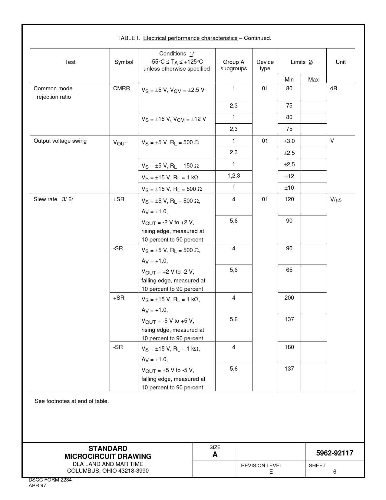

STANDARD 5962-92117 MICROCIRCUIT DRAWING
TABLE I. Electrical performance characteristics – Continued. Conditions 1/ Test Symbol -55°C ≤ TA ≤ +125°C Group A Device Limits 2/ Unit unless otherwise specified subgroups type Min Max Common mode CMRR VS = ±5 V, VCM = ±2.5 V 1 01 80 dB rejection ratio 2,3 75 VS = ±15 V, VCM = ±12 V 1 80 2,3 75 Output voltage swing VOUT VS = ±5 V, RL = 500 Ω 1 01 ±3.0 V 2.3 ±2.5 VS = ±5 V, RL = 150 Ω 1 ±2.5 VS = ±15 V, RL = 1 kΩ 1,2,3 ±12 VS = ±15 V, RL = 500 Ω 1 ±10 Slew rate 3/ 6/ +SR V 4 01 120 V/µs S = ±5 V, RL = 500 Ω, AV = +1.0, V 5,6 90 OUT = -2 V to +2 V, rising edge, measured at 10 percent to 90 percent -SR V 4 90 S = ±5 V, RL = 500 Ω, AV = +1.0, V 5,6 65 OUT = +2 V to -2 V, falling edge, measured at 10 percent to 90 percent +SR V 4 200 S = ±15 V, RL = 1 kΩ, AV = +1.0, V 5,6 137 OUT = -5 V to +5 V, rising edge, measured at 10 percent to 90 percent -SR V 4 180 S = ±15 V, RL = 1 kΩ, AV = +1.0, V 5,6 137 OUT = +5 V to -5 V, falling edge, measured at 10 percent to 90 percent See footnotes at end of table.
