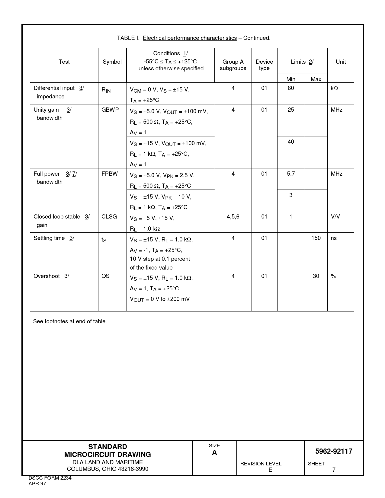

STANDARD. 5962-92117. MICROCIRCUIT DRAWING
STANDARD 5962-92117 MICROCIRCUIT DRAWING
TABLE I. Electrical performance characteristics – Continued. Conditions 1/ Test Symbol -55°C ≤ TA ≤ +125°C Group A Device Limits 2/ Unit unless otherwise specified subgroups type Min Max Differential input 3/ R 4 01 60 kΩ IN VCM = 0 V, VS = ±15 V, impedance TA = +25°C Unity gain 3/ GBWP V 4 01 25 MHz S = ±5.0 V, VOUT = ±100 mV, bandwidth RL = 500 Ω, TA = +25°C, AV = 1 V 40 S = ±15 V, VOUT = ±100 mV, RL = 1 kΩ, TA = +25°C, AV = 1 Full power 3/ 7/ FPBW V 4 01 5.7 MHz S = ±5.0 V, VPK = 2.5 V, bandwidth RL = 500 Ω, TA = +25°C V 3 S = ±15 V, VPK = 10 V, RL = 1 kΩ, TA = +25°C Closed loop stable 3/ CLSG V 4,5,6 01 1 V/V S = ±5 V, ±15 V, gain RL = 1.0 kΩ Settling time 3/ t 4 01 150 ns S VS = ±15 V, RL = 1.0 kΩ, AV = -1, TA = +25°C, 10 V step at 0.1 percent of the fixed value Overshoot 3/ OS V 4 01 30 % S = ±15 V, RL = 1.0 kΩ, AV = 1, TA = +25°C, VOUT = 0 V to ±200 mV See footnotes at end of table.
