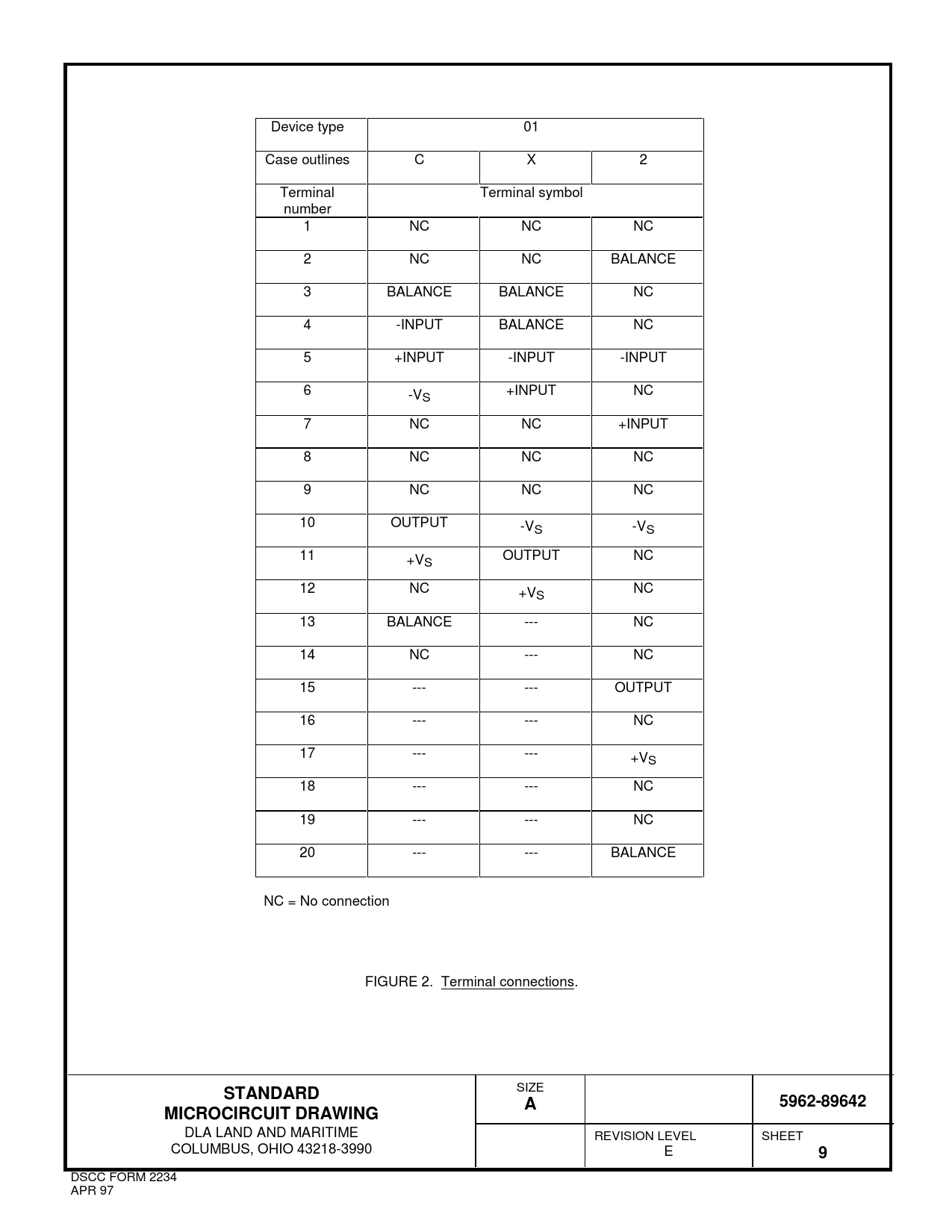

STANDARD. 5962-89642. MICROCIRCUIT DRAWING
STANDARD 5962-89642 MICROCIRCUIT DRAWING
Device type 01 Case outlines C X 2 Terminal Terminal symbol number 1 NC NC NC 2 NC NC BALANCE 3 BALANCE BALANCE NC 4 -INPUT BALANCE NC 5 +INPUT -INPUT -INPUT 6 -VS +INPUT NC 7 NC NC +INPUT 8 NC NC NC 9 NC NC NC 10 OUTPUT -VS -VS 11 +VS OUTPUT NC 12 NC +VS NC 13 BALANCE --- NC 14 NC --- NC 15 --- --- OUTPUT 16 --- --- NC 17 --- --- +VS 18 --- --- NC 19 --- --- NC 20 --- --- BALANCE NC = No connection FIGURE 2. Terminal connections.
