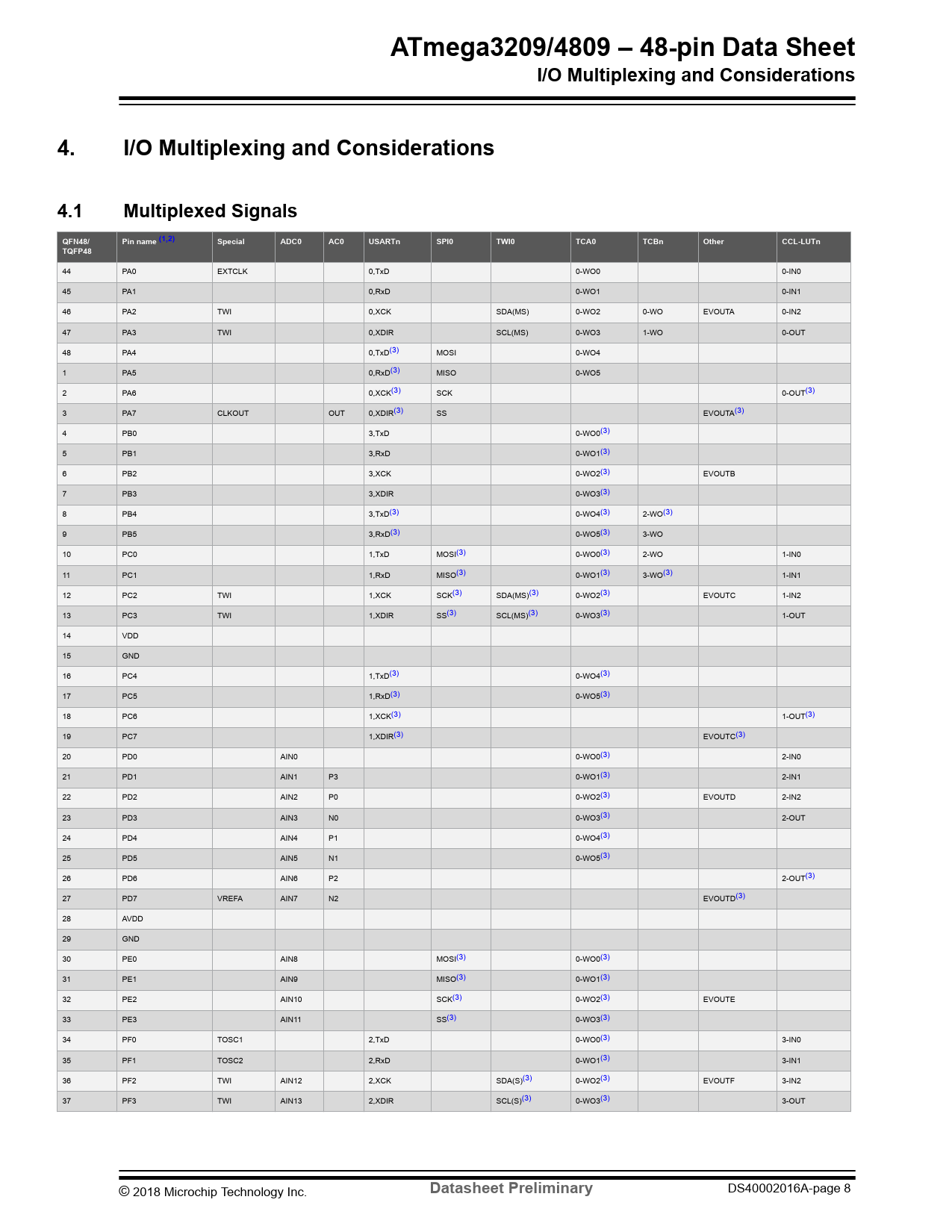

ATmega3209/4809 – 48-pin Data Sheet I/O Multiplexing and Considerations 4. I/O Multiplexing and Considerations 4.1 Multiplexed Signals QFN48/ Pin name (1,2) Special ADC0 AC0 USARTn SPI0 TWI0 TCA0 TCBn Other CCL-LUTn TQFP48
44 PA0 EXTCLK 0,TxD 0-WO0 0-IN0 45 PA1 0,RxD 0-WO1 0-IN1 46 PA2 TWI 0,XCK SDA(MS) 0-WO2 0-WO EVOUTA 0-IN2 47 PA3 TWI 0,XDIR SCL(MS) 0-WO3 1-WO 0-OUT 48 PA4 0,TxD(3) MOSI 0-WO4 1 PA5 0,RxD(3) MISO 0-WO5 2 PA6 0,XCK(3) SCK 0-OUT(3) 3 PA7 CLKOUT OUT 0,XDIR(3) SS EVOUTA(3) 4 PB0 3,TxD 0-WO0(3) 5 PB1 3,RxD 0-WO1(3) 6 PB2 3,XCK 0-WO2(3) EVOUTB 7 PB3 3,XDIR 0-WO3(3) 8 PB4 3,TxD(3) 0-WO4(3) 2-WO(3) 9 PB5 3,RxD(3) 0-WO5(3) 3-WO 10 PC0 1,TxD MOSI(3) 0-WO0(3) 2-WO 1-IN0 11 PC1 1,RxD MISO(3) 0-WO1(3) 3-WO(3) 1-IN1 12 PC2 TWI 1,XCK SCK(3) SDA(MS)(3) 0-WO2(3) EVOUTC 1-IN2 13 PC3 TWI 1,XDIR SS(3) SCL(MS)(3) 0-WO3(3) 1-OUT 14 VDD 15 GND 16 PC4 1,TxD(3) 0-WO4(3) 17 PC5 1,RxD(3) 0-WO5(3) 18 PC6 1,XCK(3) 1-OUT(3) 19 PC7 1,XDIR(3) EVOUTC(3) 20 PD0 AIN0 0-WO0(3) 2-IN0 21 PD1 AIN1 P3 0-WO1(3) 2-IN1 22 PD2 AIN2 P0 0-WO2(3) EVOUTD 2-IN2 23 PD3 AIN3 N0 0-WO3(3) 2-OUT 24 PD4 AIN4 P1 0-WO4(3) 25 PD5 AIN5 N1 0-WO5(3) 26 PD6 AIN6 P2 2-OUT(3) 27 PD7 VREFA AIN7 N2 EVOUTD(3) 28 AVDD 29 GND 30 PE0 AIN8 MOSI(3) 0-WO0(3) 31 PE1 AIN9 MISO(3) 0-WO1(3) 32 PE2 AIN10 SCK(3) 0-WO2(3) EVOUTE 33 PE3 AIN11 SS(3) 0-WO3(3) 34 PF0 TOSC1 2,TxD 0-WO0(3) 3-IN0 35 PF1 TOSC2 2,RxD 0-WO1(3) 3-IN1 36 PF2 TWI AIN12 2,XCK SDA(S)(3) 0-WO2(3) EVOUTF 3-IN2 37 PF3 TWI AIN13 2,XDIR SCL(S)(3) 0-WO3(3) 3-OUT © 2018 Microchip Technology Inc.
