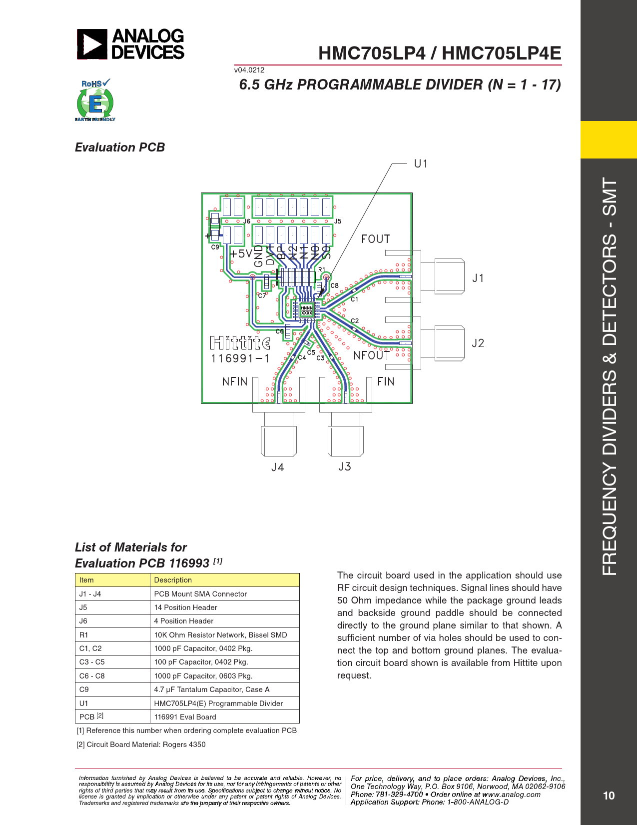

HMC705LP4 / HMC705LP4E. 6.5 GHz PROGRAMMABLE DIVIDER (N = 1 - 17). Evaluation PCB. List of Materials for
HMC705LP4 / HMC705LP4E 6.5 GHz PROGRAMMABLE DIVIDER (N = 1 - 17) Evaluation PCB List of Materials for
v04.0212
t M s s - r o t c e t e s & D r e iD iv y D c n e u q
e
Evaluation PCB 116993 [1]
r the circuit board used in the application should use F item Description rF circuit design techniques. signal lines should have J1 - J4 PcB Mount sMA connector 50 ohm impedance while the package ground leads J5 14 Position Header and backside ground paddle should be connected J6 4 Position Header directly to the ground plane similar to that shown. A r1 10K ohm resistor network, Bissel sMD sufficient number of via holes should be used to con- c1, c2 1000 pF capacitor, 0402 Pkg. nect the top and bottom ground planes. the evalua- c3 - c5 100 pF capacitor, 0402 Pkg. tion circuit board shown is available from Hittite upon c6 - c8 1000 pF capacitor, 0603 Pkg. request. c9 4.7 μF tantalum capacitor, case A u1 HMc705LP4(e) Programmable Divider PcB [2] 116991 eval Board [1] reference this number when ordering complete evaluation PcB [2] circuit Board Material: rogers 4350 I F nf o or r p mati r o in cfe ur , d nish e e l d iv b e y r A y a nalo n g d t Devi o p ces i la s c bele o ieve rd d t e o rbs e : H acc iutrtatite e M and ic reli rao bl w e. a H v o e C wever o , nrp o For price, delivery, and to place orders: Analog Devices, Inc., responsibility is assumed by Analog Devices for its use, nor for any infringements of patents or other oration, 2 Elizabeth Drive, Chelmsford, MA 01824 One Technology Way, P.O. Box 9106, Norwood, MA 02062-9106 Phone: 978-250-3343 Fax: 978-250-3373 O rights of third parties that may result from its use. Specifications subject to change without notice. No rd Phoe n r O e: 7 n- 81-li 3 n 2 e a 9-4 t w 70 ww 0 • O . rdh e itt r o it nle i . n co e a m license is granted by implication or otherwise under any patent or patent rights of Analog Devices. t www.analog.com
