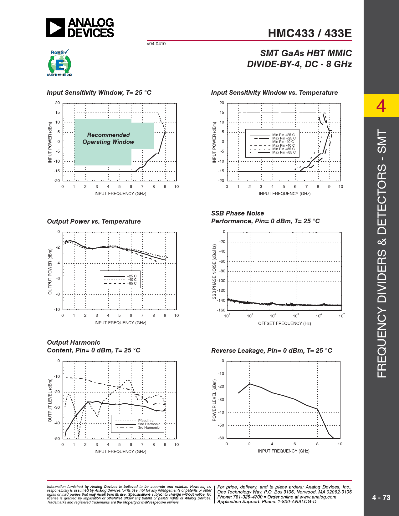

DescriptionSMT 4 SMT GaAs HBT MMIC DIVIDE-BY-4, DC - 8 GHz
Pages / Page6 / 2 — HMC433 / 433E. SMT GaAs HBT MMIC. DIVIDE-BY-4, DC - 8 GHz. Input …
File Format / SizePDF / 356 Kb
HMC433 / 433E. SMT GaAs HBT MMIC. DIVIDE-BY-4, DC - 8 GHz. Input Sensitivity Window, T= 25 °C
HMC433 / 433E SMT GaAs HBT MMIC DIVIDE-BY-4, DC - 8 GHz Input Sensitivity Window, T= 25 °C
HMC433 / 433E
v04.0410
SMT GaAs HBT MMIC DIVIDE-BY-4, DC - 8 GHz Input Sensitivity Window, T= 25 °C Input Sensitivity Window vs. Temperature
20 20 15 15 4 10 10 5 5
Recommended
Min Pin +25 C T Max Pin +25 C 0
Operating Window
0 Min Pin -40 C Max Pin -40 C Min Pin +85 C -5 -5 Max Pin +85 C INPUT POWER (dBm) -10 INPUT POWER (dBm) -10 -15 -15 S - SM R -20 -20 0 1 2 3 4 5 6 7 8 9 10 0 1 2 3 4 5 6 7 8 9 10 O INPUT FREQUENCY (GHz) INPUT FREQUENCY (GHz) T C E
SSB Phase Noise
T
Output Power vs. Temperature Performance, Pin= 0 dBm, T= 25 °C
E 0 0 -20 -2 & D -40 S -60 -4 R -80 E +25 C -6 -40 C -100 +85 C ID -120 OUTPUT POWER (dBm) -8 IV SSB PHASE NOISE (dBc/Hz) -140 -10 -160 Y D 0 1 2 3 4 5 6 7 8 9 10 102 103 104 105 106 107 INPUT FREQUENCY (GHz) OFFSET FREQUENCY (Hz) NC E
Output Harmonic
U
Content, Pin= 0 dBm, T= 25 °C Reverse Leakage, Pin= 0 dBm, T= 25 °C
Q 0 0 E R -10 -10 F -20 -20 -30 -30 -40 OUTPUT LEVEL (dBm) Pfeedthru POWER LEVEL (dBm) -40 2nd Harmonic -50 3rd Harmonic -50 -60 0 1 2 3 4 5 6 7 8 9 10 0 2 4 6 8 10 INPUT FREQUENCY (GHz) INPUT FREQUENCY (GHz) Info F rmoatr pr ion f iurcne, de ished b ly iv A e n r al y o a g D n evd to p ices is bla eli c eve o ed t rde o be ras: H ccuratite tiatne M d reli iacr ble ow . Ho av wev e C er, n o o rpo Fora r t p iro ic n e ,, 2 d 0 eli A ve lrpha R y, and toad, C o place hoel rd m er s s fo : Ard, MA 01 nalog Devic 8 e 2 s 4 , Inc., responsibility is assumed by Analog Devices for its use, nor for any infringements of patents or other One Technology Way, P.O. Box 9106, Norwood, MA 02062-9106 Phone: 978-250-3343 Fax: 978-250-3373 O rights of third parties that may result from its use. Specifications subject to change without notice. No P rde hone r O : 7 n 81- -3li 2n 9 e a -47 t w 0 w 0 • O w rd .ehit r o t nilte in .c e ao t m license is granted by implication or otherwise under any patent or patent rights of Analog Devices. www.analog.com
