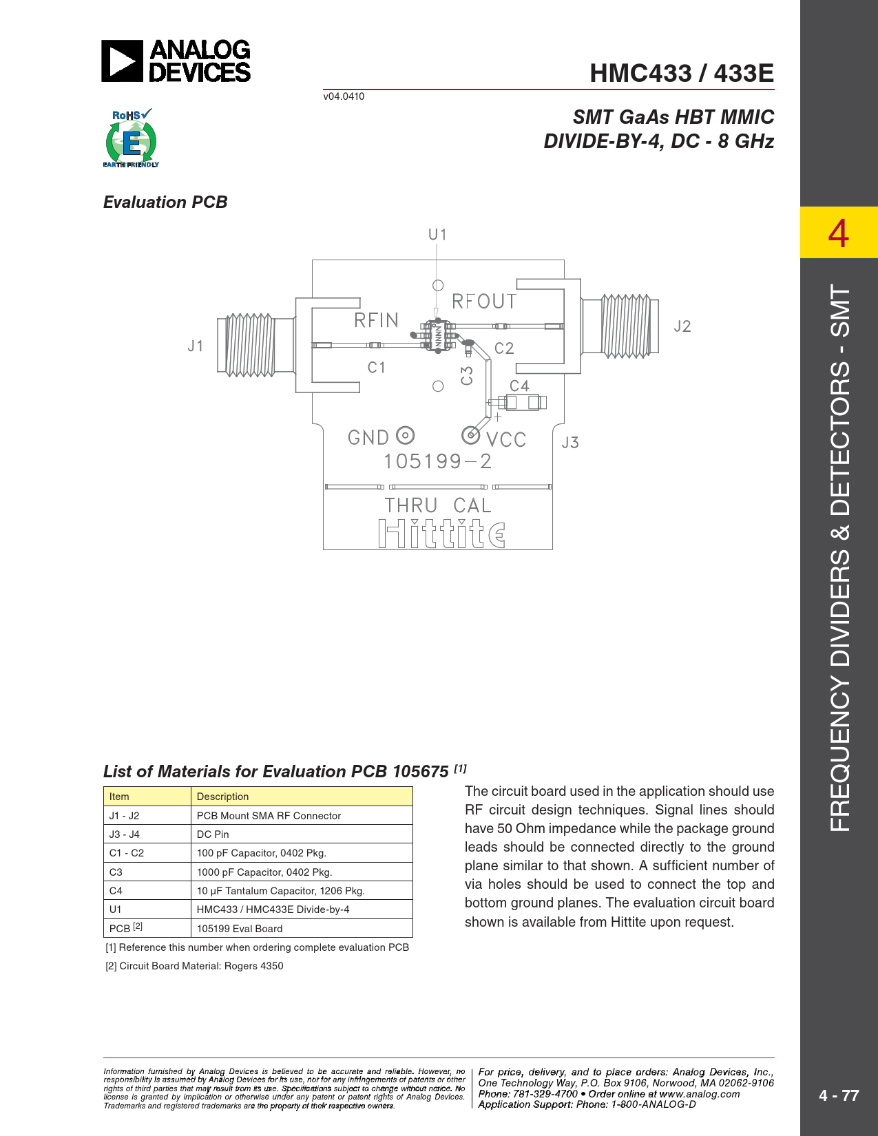

HMC433 / 433E. SMT GaAs HBT MMIC. DIVIDE-BY-4, DC - 8 GHz. Evaluation PCB. List of Materials for Evaluation PCB 105675 [1]
HMC433 / 433E SMT GaAs HBT MMIC DIVIDE-BY-4, DC - 8 GHz Evaluation PCB List of Materials for Evaluation PCB 105675 [1]
HMC433 / 433E
v04.0410
4 T S - SM R O T C E T E & D S R E ID IV Y D NC E U
Q The circuit board used in the application should use Item Description E RF circuit design techniques. Signal lines should J1 - J2 PCB Mount SMA RF Connector R have 50 Ohm impedance while the package ground F J3 - J4 DC Pin leads should be connected directly to the ground C1 - C2 100 pF Capacitor, 0402 Pkg. plane similar to that shown. A sufficient number of C3 1000 pF Capacitor, 0402 Pkg. via holes should be used to connect the top and C4 10 μF Tantalum Capacitor, 1206 Pkg. bottom ground planes. The evaluation circuit board U1 HMC433 / HMC433E Divide-by-4 shown is available from Hittite upon request. PCB [2] 105199 Eval Board [1] Reference this number when ordering complete evaluation PCB [2] Circuit Board Material: Rogers 4350 Info F rmoatr pr ion f iurcne, de ished b ly iv A e n r al y o a g D n evd to p ices is bla eli c eve o ed t rde o be ras: H ccuratite tiatne M d reli iacr ble ow . Ho av wev e C er, n o o rpo Fora r t p iro ic n e ,, 2 d 0 eli A ve lrpha R y, and toad, C o place hoel rd m er s s fo : Ard, MA 01 nalog Devic 8 e 2 s 4 , Inc., responsibility is assumed by Analog Devices for its use, nor for any infringements of patents or other One Technology Way, P.O. Box 9106, Norwood, MA 02062-9106 Phone: 978-250-3343 Fax: 978-250-3373 O rights of third parties that may result from its use. Specifications subject to change without notice. No P rde hone r O : 7 n 81- -3li 2n 9 e a -47 t w 0 w 0 • O w rd .ehit r o t nilte in .c e ao t m license is granted by implication or otherwise under any patent or patent rights of Analog Devices. www.analog.com
