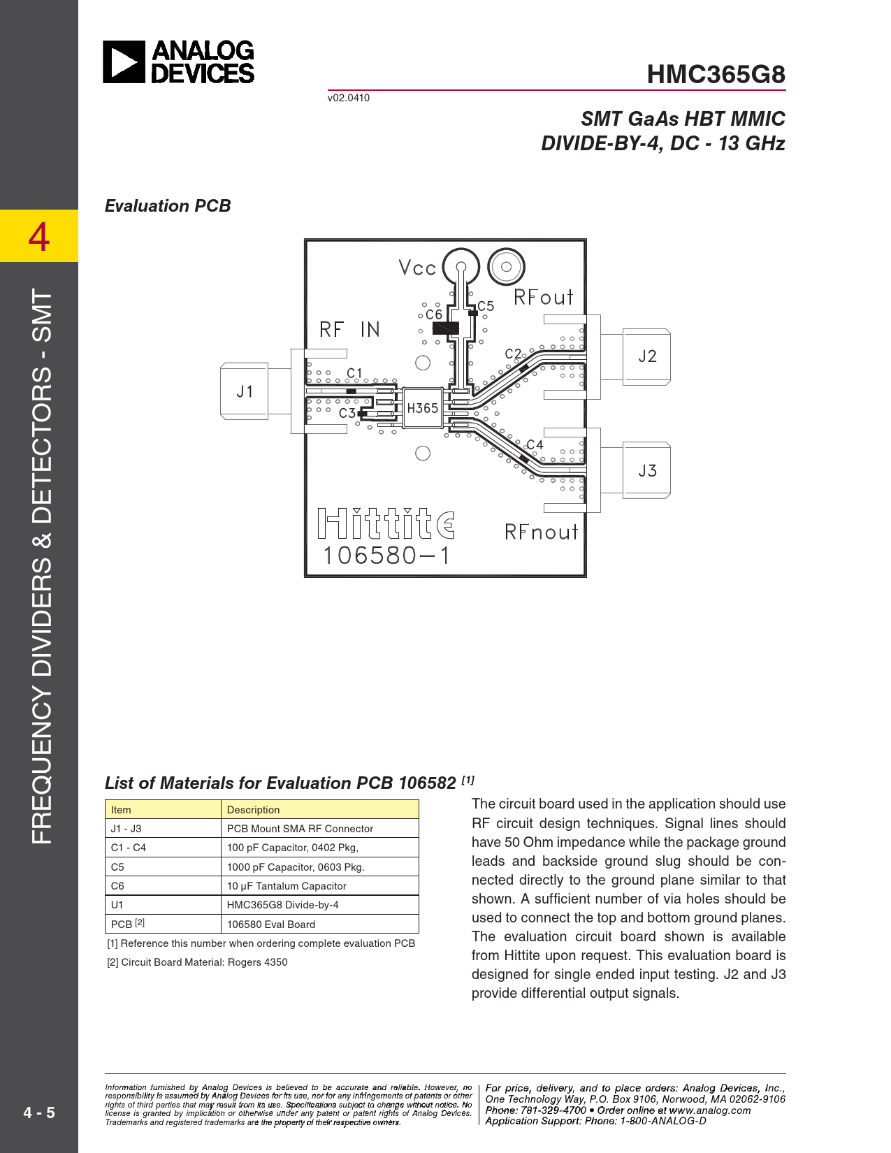

List of Materials for Evaluation PCB 106582 [1]
E The circuit board used in the application should use Item Description R RF circuit design techniques. Signal lines should F J1 - J3 PCB Mount SMA RF Connector have 50 Ohm impedance while the package ground C1 - C4 100 pF Capacitor, 0402 Pkg, leads and backside ground slug should be con- C5 1000 pF Capacitor, 0603 Pkg. nected directly to the ground plane similar to that C6 10 μF Tantalum Capacitor shown. A sufficient number of via holes should be U1 HMC365G8 Divide-by-4 used to connect the top and bottom ground planes. PCB [2] 106580 Eval Board The evaluation circuit board shown is available [1] Reference this number when ordering complete evaluation PCB from Hittite upon request. This evaluation board is [2] Circuit Board Material: Rogers 4350 designed for single ended input testing. J2 and J3 provide differential output signals. Info F rmoatr pr ion f iurcne, de ished b ly iv A e n r al y o a g D n evd to p ices is bla eli c eve o ed t rde o be ras: H ccuratite tiatne M d reli iacr ble ow . Ho av wev e C er, n o o rpo Fora r t p iro ic n e ,, 2 d 0 eli A ve lrpha R y, and toad, C o place hoel rd m er s s fo : Ard, MA 01 nalog Devic 8 e 2 s 4 , Inc., responsibility is assumed by Analog Devices for its use, nor for any infringements of patents or other One Technology Way, P.O. Box 9106, Norwood, MA 02062-9106 rights of third parties that may result from its use. Specifications subject to change without notice. No
