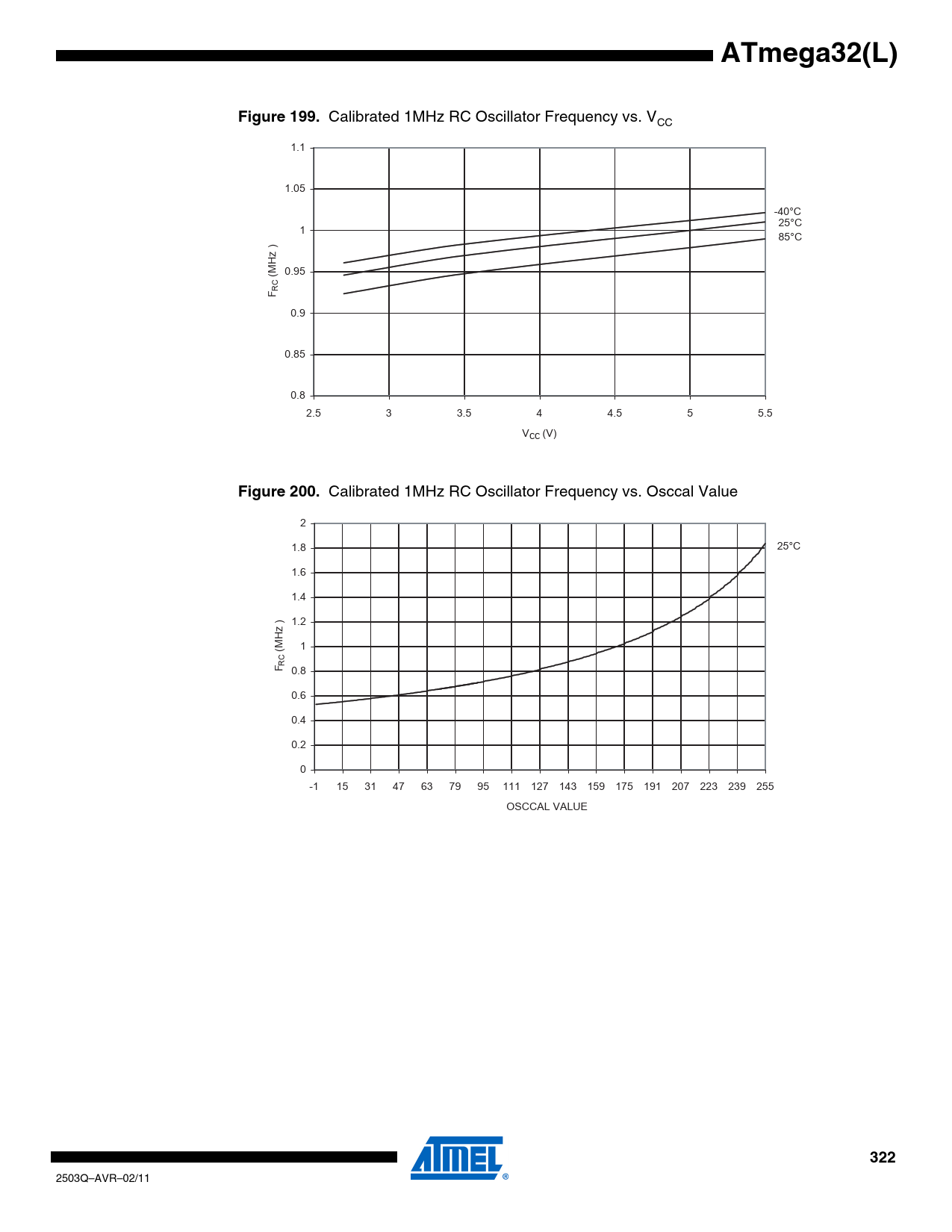

ATmega32(L). Figure 199. Figure 200. 322
ATmega32(L) Figure 199 Figure 200 322
ATmega32(L) Figure 199.
Calibrated 1MHz RC Oscillator Frequency vs. VCC 1.1 1.05 -40°C 25°C 1 85°C ) 0.95 (MHz F RC 0.9 0.85 0.8 2.5 3 3.5 4 4.5 5 5.5 Vcc (V)
Figure 200.
Calibrated 1MHz RC Oscillator Frequency vs. Osccal Value 2 1.8 25°C 1.6 1.4 ) 1.2 1 (MHz F RC 0.8 0.6 0.4 0.2 0 -1 15 31 47 63 79 95 111 127 143 159 175 191 207 223 239 255 OSCCAL VALUE
