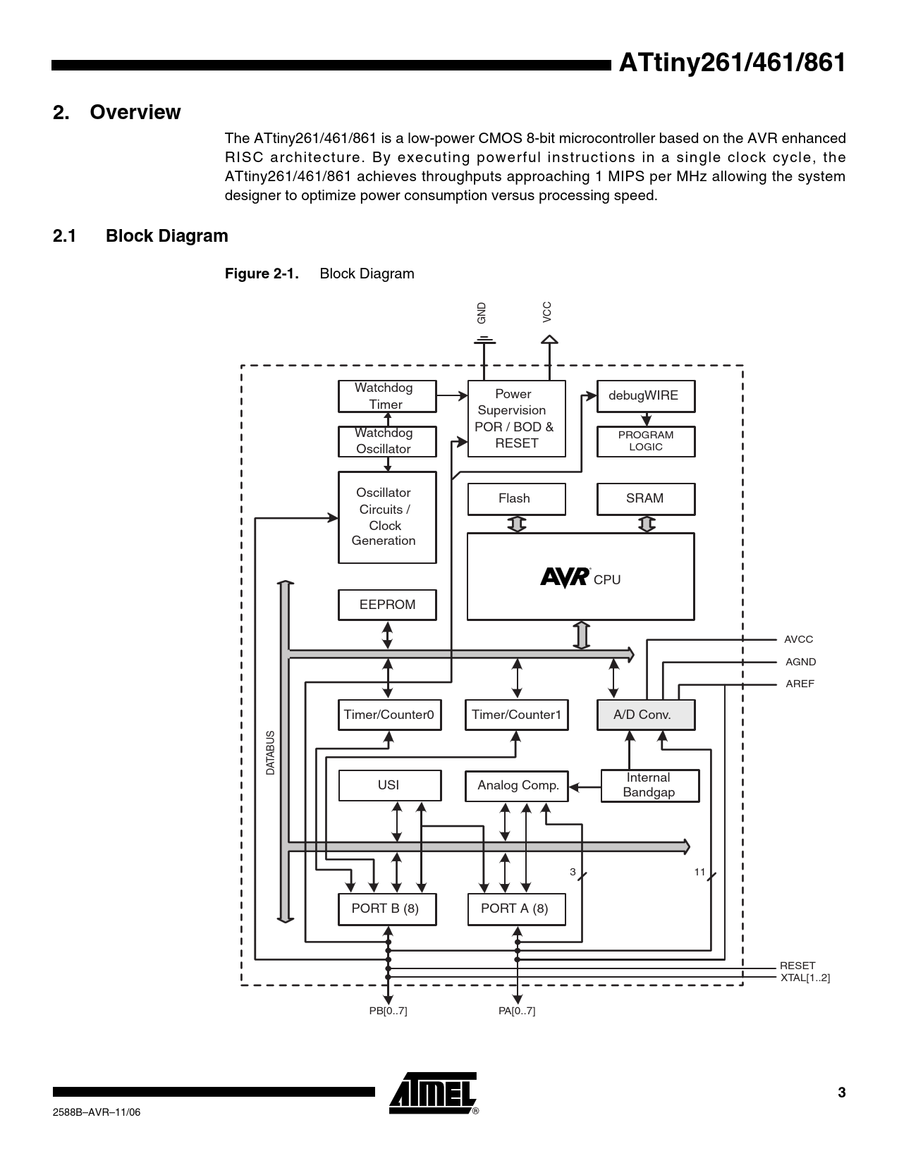

ATtiny261/461/861 2. Overview
The ATtiny261/461/861 is a low-power CMOS 8-bit microcontroller based on the AVR enhanced RISC architecture. By executing powerful instructions in a single clock cycle, the ATtiny261/461/861 achieves throughputs approaching 1 MIPS per MHz allowing the system designer to optimize power consumption versus processing speed.
2.1 Block Diagram Figure 2-1.
Block Diagram GND VCC Watchdog Power debugWIRE Timer Supervision POR / BOD & Watchdog PROGRAM RESET Oscillator LOGIC Oscillator Flash SRAM Circuits / Clock Generation CPU EEPROM AVCC AGND AREF Timer/Counter0 Timer/Counter1 A/D Conv. S U B ATA D Internal USI Analog Comp. Bandgap 3 11 PORT B (8) PORT A (8) RESET XTAL[1..2] PB[0..7] PA[0..7]
