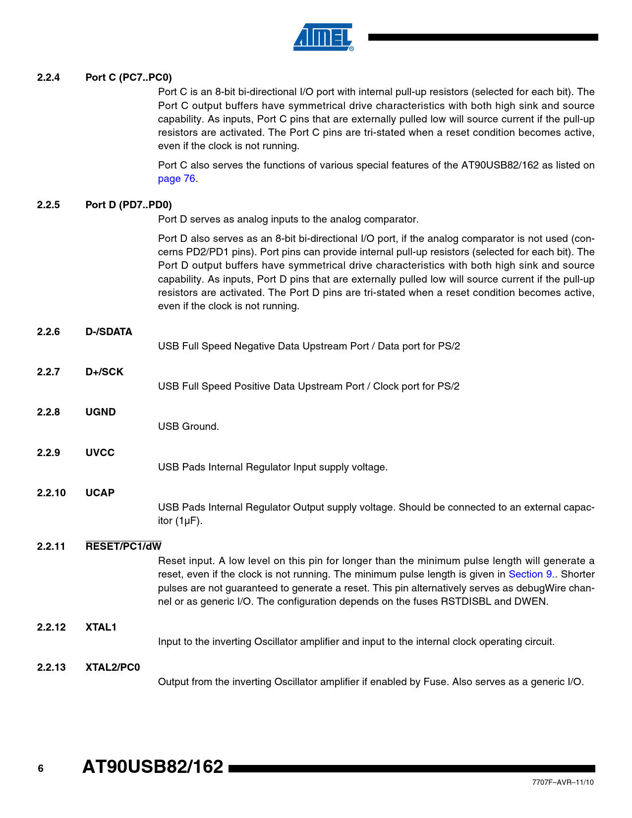

2.2.4 Port C (PC7..PC0)
Port C is an 8-bit bi-directional I/O port with internal pull-up resistors (selected for each bit). The Port C output buffers have symmetrical drive characteristics with both high sink and source capability. As inputs, Port C pins that are externally pulled low will source current if the pull-up resistors are activated. The Port C pins are tri-stated when a reset condition becomes active, even if the clock is not running. Port C also serves the functions of various special features of the AT90USB82/162 as listed on page 76.
2.2.5 Port D (PD7..PD0)
Port D serves as analog inputs to the analog comparator. Port D also serves as an 8-bit bi-directional I/O port, if the analog comparator is not used (con- cerns PD2/PD1 pins). Port pins can provide internal pull-up resistors (selected for each bit). The Port D output buffers have symmetrical drive characteristics with both high sink and source capability. As inputs, Port D pins that are externally pulled low will source current if the pull-up resistors are activated. The Port D pins are tri-stated when a reset condition becomes active, even if the clock is not running.
2.2.6 D-/SDATA
USB Full Speed Negative Data Upstream Port / Data port for PS/2
2.2.7 D+/SCK
USB Full Speed Positive Data Upstream Port / Clock port for PS/2
2.2.8 UGND
USB Ground.
2.2.9 UVCC
USB Pads Internal Regulator Input supply voltage.
2.2.10 UCAP
USB Pads Internal Regulator Output supply voltage. Should be connected to an external capac- itor (1µF).
2.2.11 RESET/PC1/dW
Reset input. A low level on this pin for longer than the minimum pulse length will generate a reset, even if the clock is not running. The minimum pulse length is given in Section 9.. Shorter pulses are not guaranteed to generate a reset. This pin alternatively serves as debugWire chan- nel or as generic I/O. The configuration depends on the fuses RSTDISBL and DWEN.
2.2.12 XTAL1
Input to the inverting Oscillator amplifier and input to the internal clock operating circuit.
2.2.13 XTAL2/PC0
Output from the inverting Oscillator amplifier if enabled by Fuse. Also serves as a generic I/O.
