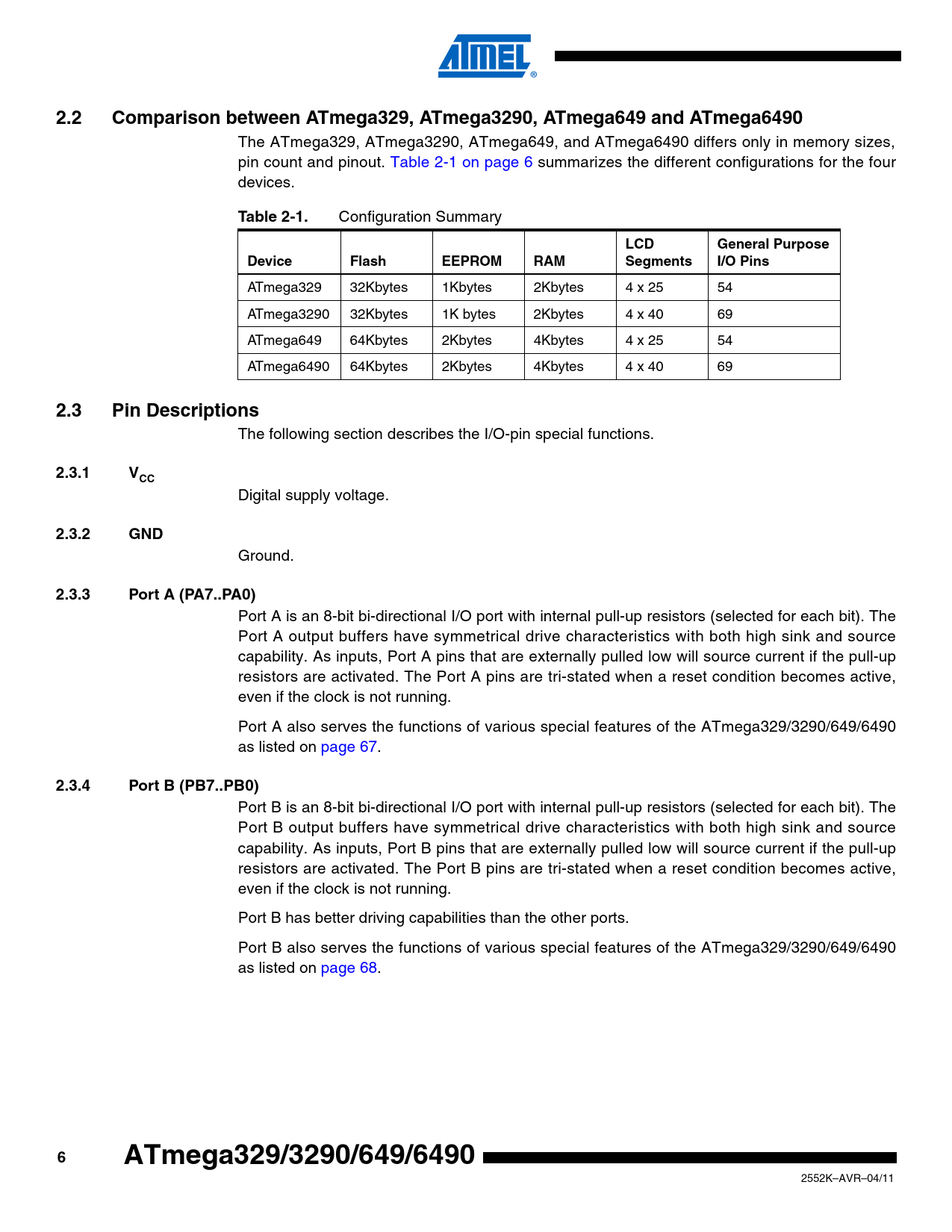

2.2 Comparison between ATmega329, ATmega3290, ATmega649 and ATmega6490
The ATmega329, ATmega3290, ATmega649, and ATmega6490 differs only in memory sizes, pin count and pinout. Table 2-1 on page 6 summarizes the different configurations for the four devices.
Table 2-1.
Configuration Summary
LCD General Purpose Device Flash EEPROM RAM Segments I/O Pins
ATmega329 32Kbytes 1Kbytes 2Kbytes 4 x 25 54 ATmega3290 32Kbytes 1K bytes 2Kbytes 4 x 40 69 ATmega649 64Kbytes 2Kbytes 4Kbytes 4 x 25 54 ATmega6490 64Kbytes 2Kbytes 4Kbytes 4 x 40 69
2.3 Pin Descriptions
The following section describes the I/O-pin special functions.
2.3.1 VCC
Digital supply voltage.
2.3.2 GND
Ground.
2.3.3 Port A (PA7..PA0)
Port A is an 8-bit bi-directional I/O port with internal pull-up resistors (selected for each bit). The Port A output buffers have symmetrical drive characteristics with both high sink and source capability. As inputs, Port A pins that are externally pulled low will source current if the pull-up resistors are activated. The Port A pins are tri-stated when a reset condition becomes active, even if the clock is not running. Port A also serves the functions of various special features of the ATmega329/3290/649/6490 as listed on page 67.
2.3.4 Port B (PB7..PB0)
Port B is an 8-bit bi-directional I/O port with internal pull-up resistors (selected for each bit). The Port B output buffers have symmetrical drive characteristics with both high sink and source capability. As inputs, Port B pins that are externally pulled low will source current if the pull-up resistors are activated. The Port B pins are tri-stated when a reset condition becomes active, even if the clock is not running. Port B has better driving capabilities than the other ports. Port B also serves the functions of various special features of the ATmega329/3290/649/6490 as listed on page 68.
6 ATmega329/3290/649/6490
