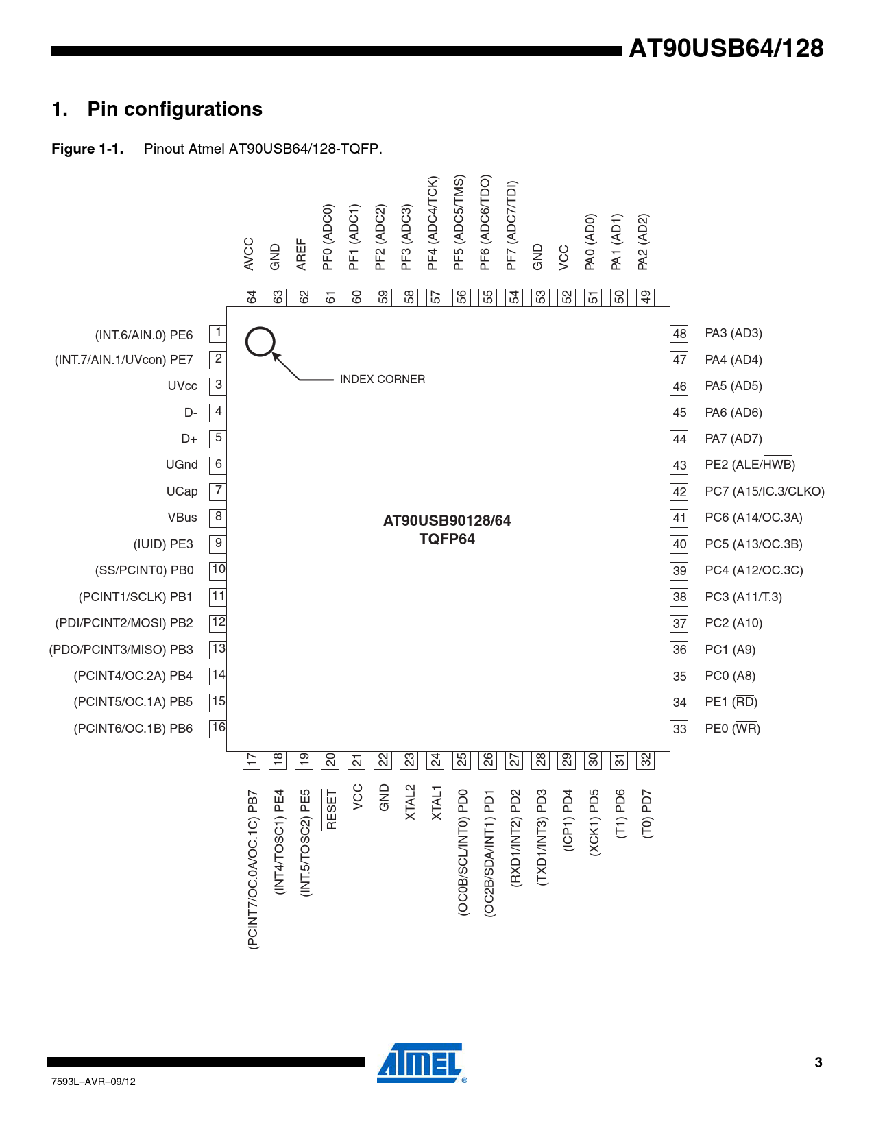

AT90USB64/128. Pin configurations. Figure 1-1. AT90USB90128/64. TQFP64
AT90USB64/128 Pin configurations Figure 1-1 AT90USB90128/64 TQFP64
AT90USB64/128 1. Pin configurations Figure 1-1.
Pinout Atmel AT90USB64/128-TQFP. VCC A0 (AD0) A1 (AD1) A2 (AD2) A GND AREF PF0 (ADC0) PF1 (ADC1) PF2 (ADC2) PF3 (ADC3) PF4 (ADC4/TCK) PF5 (ADC5/TMS) PF6 (ADC6/TDO) PF7 (ADC7/TDI) GND VCC P P P 64 63 62 61 60 59 58 57 56 55 54 53 52 51 50 49 (INT.6/AIN.0) PE6 1 48 PA3 (AD3) (INT.7/AIN.1/UVcon) PE7 2 47 PA4 (AD4) INDEX CORNER UVcc 3 46 PA5 (AD5) D- 4 45 PA6 (AD6) D+ 5 44 PA7 (AD7) UGnd 6 43 PE2 (ALE/HWB) UCap 7 42 PC7 (A15/IC.3/CLKO) VBus 8
AT90USB90128/64
41 PC6 (A14/OC.3A)
TQFP64
(IUID) PE3 9 40 PC5 (A13/OC.3B) (SS/PCINT0) PB0 10 39 PC4 (A12/OC.3C) (PCINT1/SCLK) PB1 11 38 PC3 (A11/T.3) (PDI/PCINT2/MOSI) PB2 12 37 PC2 (A10) (PDO/PCINT3/MISO) PB3 13 36 PC1 (A9) (PCINT4/OC.2A) PB4 14 35 PC0 (A8) (PCINT5/OC.1A) PB5 15 34 PE1 (RD) (PCINT6/OC.1B) PB6 16 33 PE0 (WR) 17 18 19 20 21 22 23 24 25 26 27 28 29 30 31 32 VCC GND AL2 AL1 XT XT RESET .1C) PB7 (T1) PD6 (T0) PD7 OSC1) PE4 OSC2) PE5 (ICP1) PD4 A/INT1) PD1 (XCK1) PD5 .0A/OC .5/T (RXD1/INT2) PD2 (TXD1/INT3) PD3 (INT4/T (INT (OC0B/SCL/INT0) PD0 (OC2B/SD (PCINT7/OC
