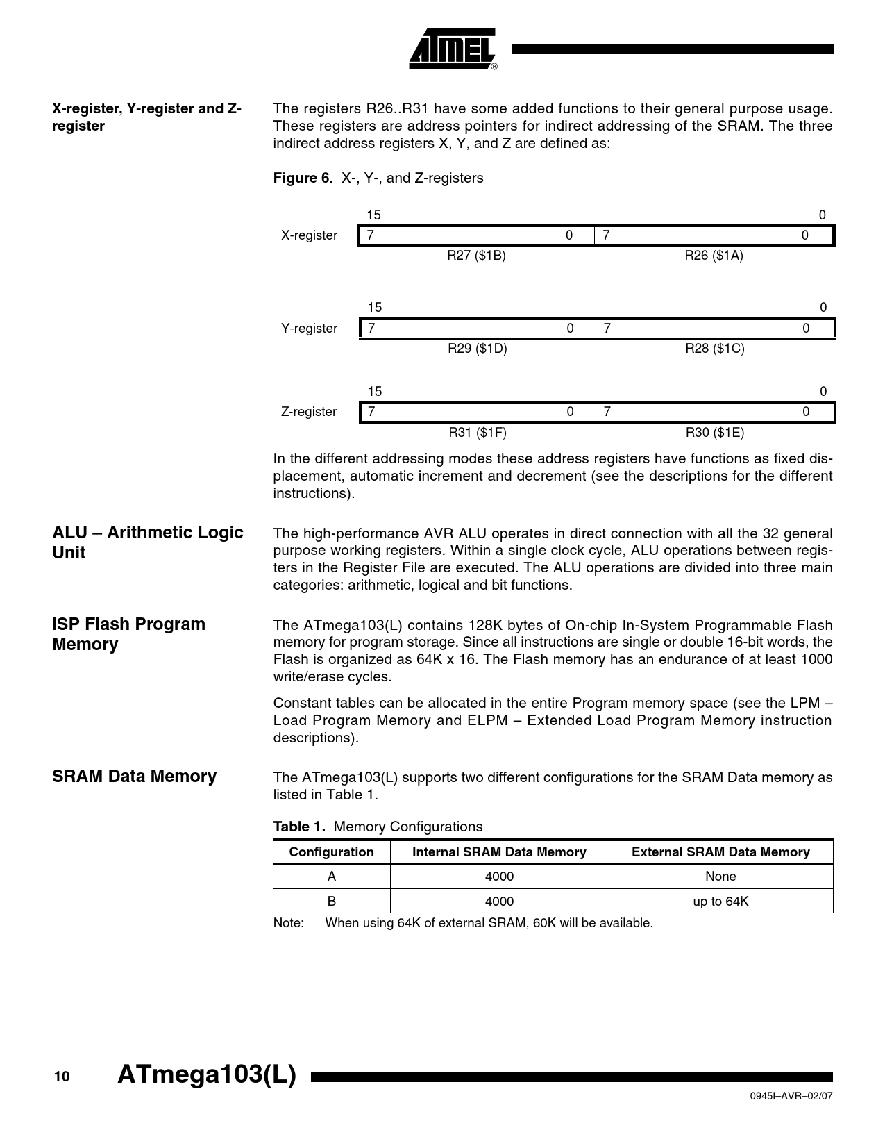

X-register, Y-register and Z-
The registers R26..R31 have some added functions to their general purpose usage.
register
These registers are address pointers for indirect addressing of the SRAM. The three indirect address registers X, Y, and Z are defined as:
Figure 6.
X-, Y-, and Z-registers 15 0 X-register 7 0 7 0 R27 ($1B) R26 ($1A) 15 0 Y-register 7 0 7 0 R29 ($1D) R28 ($1C) 15 0 Z-register 7 0 7 0 R31 ($1F) R30 ($1E) In the different addressing modes these address registers have functions as fixed dis- placement, automatic increment and decrement (see the descriptions for the different instructions).
ALU – Arithmetic Logic
The high-performance AVR ALU operates in direct connection with all the 32 general
Unit
purpose working registers. Within a single clock cycle, ALU operations between regis- ters in the Register File are executed. The ALU operations are divided into three main categories: arithmetic, logical and bit functions.
ISP Flash Program
The ATmega103(L) contains 128K bytes of On-chip In-System Programmable Flash
Memory
memory for program storage. Since all instructions are single or double 16-bit words, the Flash is organized as 64K x 16. The Flash memory has an endurance of at least 1000 write/erase cycles. Constant tables can be allocated in the entire Program memory space (see the LPM – Load Program Memory and ELPM – Extended Load Program Memory instruction descriptions).
SRAM Data Memory
The ATmega103(L) supports two different configurations for the SRAM Data memory as listed in Table 1.
Table 1.
Memory Configurations
Configuration Internal SRAM Data Memory External SRAM Data Memory
A 4000 None B 4000 up to 64K Note: When using 64K of external SRAM, 60K will be available.
