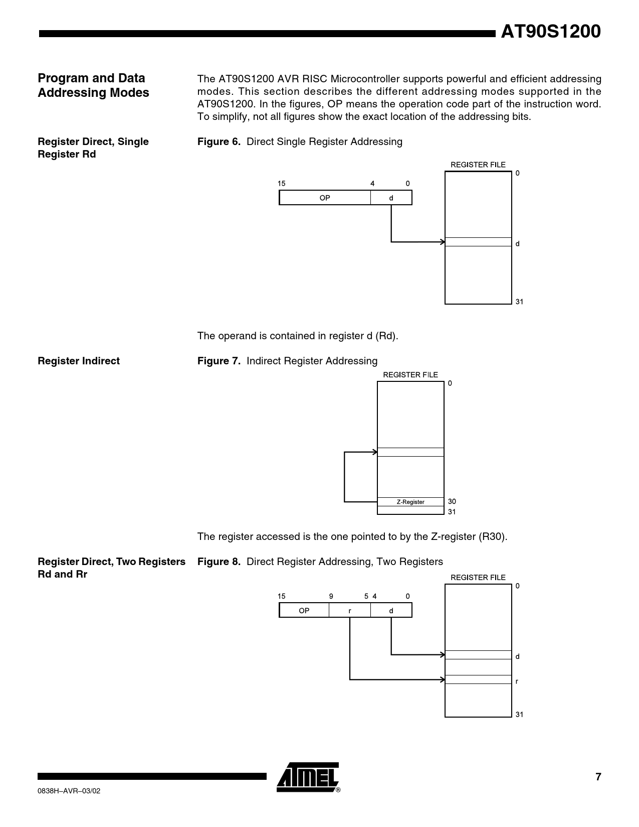

AT90S1200 Program and Data
The AT90S1200 AVR RISC Microcontroller supports powerful and efficient addressing
Addressing Modes
modes. This section describes the different addressing modes supported in the AT90S1200. In the figures, OP means the operation code part of the instruction word. To simplify, not all figures show the exact location of the addressing bits.
Register Direct, Single Figure 6.
Direct Single Register Addressing
Register Rd
The operand is contained in register d (Rd).
Register Indirect Figure 7.
Indirect Register Addressing The register accessed is the one pointed to by the Z-register (R30).
Register Direct, Two Registers Figure 8.
Direct Register Addressing, Two Registers
Rd and Rr 7
