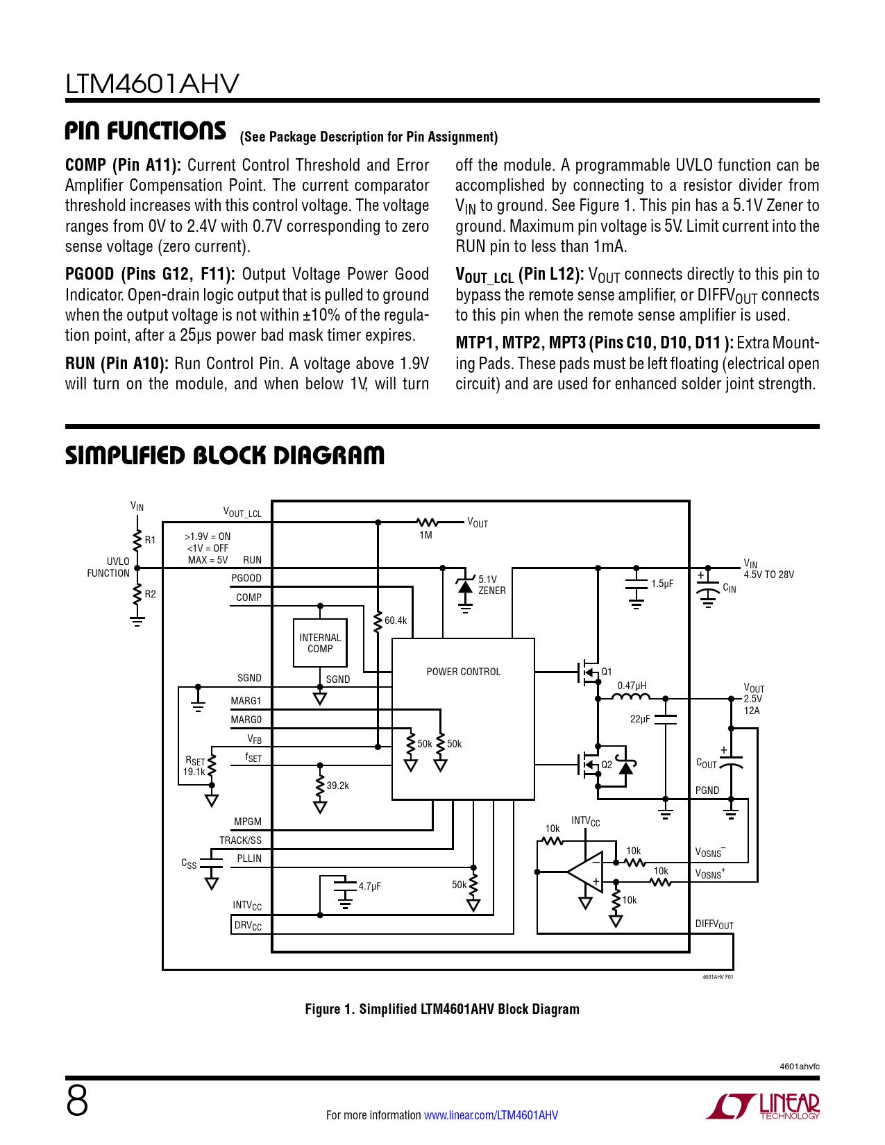

pin FuncTions (See Package Description for Pin Assignment). COMP (Pin A11):. PGOOD (Pins G12, F11):. VOUT_LCL (Pin L12):
pin FuncTions (See Package Description for Pin Assignment) COMP (Pin A11): PGOOD (Pins G12, F11): VOUT_LCL (Pin L12):
LTM4601AHV
Current Control Threshold and Error off the module. A programmable UVLO function can be Amplifier Compensation Point. The current comparator accomplished by connecting to a resistor divider from threshold increases with this control voltage. The voltage VIN to ground. See Figure 1. This pin has a 5.1V Zener to ranges from 0V to 2.4V with 0.7V corresponding to zero ground. Maximum pin voltage is 5V. Limit current into the sense voltage (zero current). RUN pin to less than 1mA.
Output Voltage Power Good
VOUT_LCL (Pin L12):
VOUT connects directly to this pin to Indicator. Open-drain logic output that is pulled to ground bypass the remote sense amplifier, or DIFFVOUT connects when the output voltage is not within ±10% of the regula- to this pin when the remote sense amplifier is used. tion point, after a 25µs power bad mask timer expires.
MTP1, MTP2, MPT3 (Pins C10, D10, D11 ):
Extra Mount-
RUN (Pin A10):
Run Control Pin. A voltage above 1.9V ing Pads. These pads must be left floating (electrical open will turn on the module, and when below 1V, will turn circuit) and are used for enhanced solder joint strength.
siMpliFieD block DiagraM
VIN VOUT_LCL VOUT >1.9V = ON 1M R1 <1V = OFF UVLO MAX = 5V RUN VIN FUNCTION PGOOD + 5.1V 4.5V TO 28V 1.5µF ZENER CIN R2 COMP 60.4k INTERNAL COMP POWER CONTROL SGND Q1 SGND 0.47µH VOUT MARG1 2.5V 12A MARG0 22µF VFB 50k 50k + f R SET SET Q2 COUT 19.1k 39.2k PGND MPGM INTV 10k CC TRACK/SS 10k V – PLLIN – OSNS CSS 10k + V + OSNS 4.7µF 50k INTV 10k CC DRVCC DIFFVOUT 4601AHV F01
Figure 1. Simplified LTM4601AHV Block Diagram
