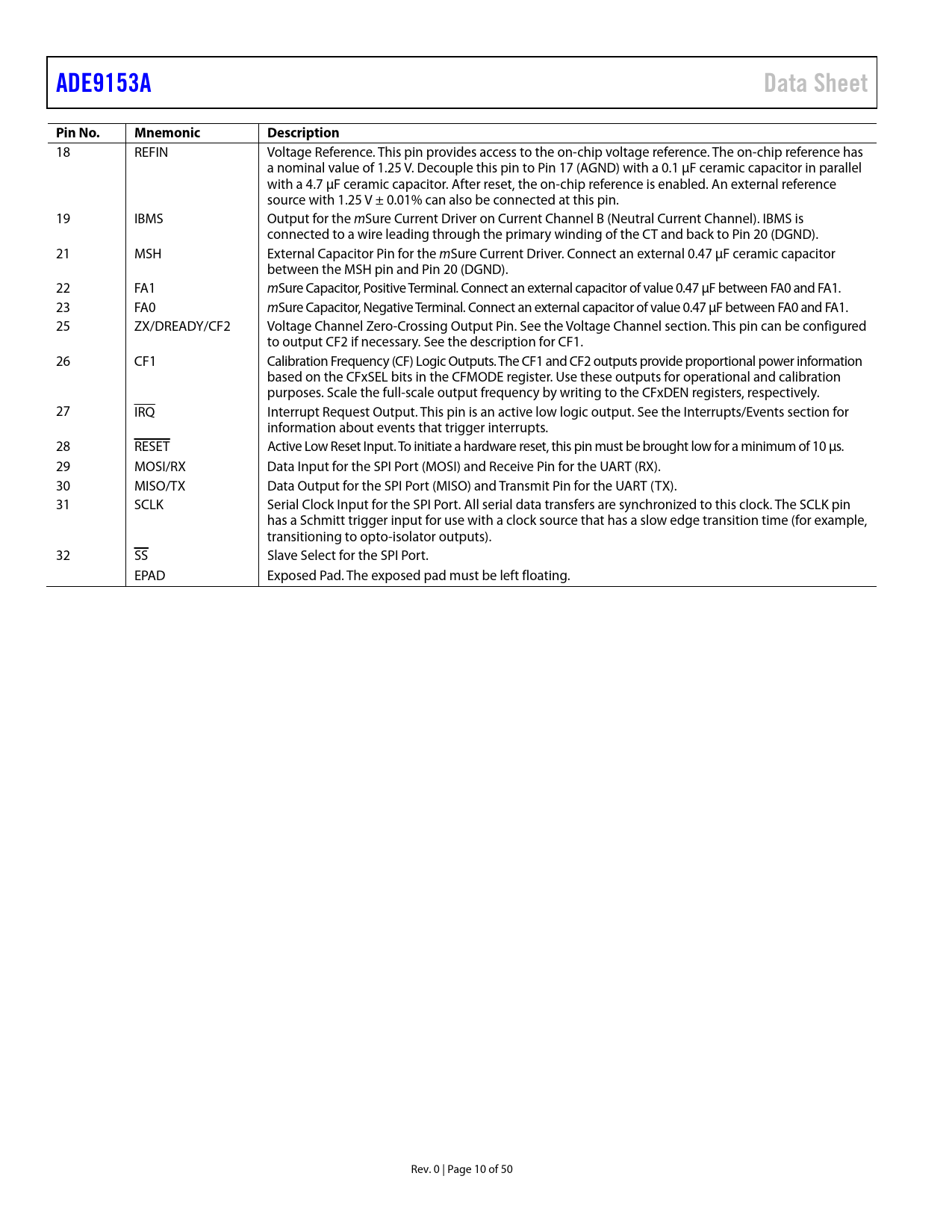

ADE9153A Data Sheet Pin No. Mnemonic Description
18 REFIN Voltage Reference. This pin provides access to the on-chip voltage reference. The on-chip reference has a nominal value of 1.25 V. Decouple this pin to Pin 17 (AGND) with a 0.1 μF ceramic capacitor in parallel with a 4.7 μF ceramic capacitor. After reset, the on-chip reference is enabled. An external reference source with 1.25 V ± 0.01% can also be connected at this pin. 19 IBMS Output for the mSure Current Driver on Current Channel B (Neutral Current Channel). IBMS is connected to a wire leading through the primary winding of the CT and back to Pin 20 (DGND). 21 MSH External Capacitor Pin for the mSure Current Driver. Connect an external 0.47 μF ceramic capacitor between the MSH pin and Pin 20 (DGND). 22 FA1 mSure Capacitor, Positive Terminal. Connect an external capacitor of value 0.47 μF between FA0 and FA1. 23 FA0 mSure Capacitor, Negative Terminal. Connect an external capacitor of value 0.47 μF between FA0 and FA1. 25 ZX/DREADY/CF2 Voltage Channel Zero-Crossing Output Pin. See the Voltage Channel section. This pin can be configured to output CF2 if necessary. See the description for CF1. 26 CF1 Calibration Frequency (CF) Logic Outputs. The CF1 and CF2 outputs provide proportional power information based on the CFxSEL bits in the CFMODE register. Use these outputs for operational and calibration purposes. Scale the full-scale output frequency by writing to the CFxDEN registers, respectively. 27 IRQ Interrupt Request Output. This pin is an active low logic output. See the Interrupts/Events section for information about events that trigger interrupts. 28 RESET Active Low Reset Input. To initiate a hardware reset, this pin must be brought low for a minimum of 10 μs. 29 MOSI/RX Data Input for the SPI Port (MOSI) and Receive Pin for the UART (RX). 30 MISO/TX Data Output for the SPI Port (MISO) and Transmit Pin for the UART (TX). 31 SCLK Serial Clock Input for the SPI Port. All serial data transfers are synchronized to this clock. The SCLK pin has a Schmitt trigger input for use with a clock source that has a slow edge transition time (for example, transitioning to opto-isolator outputs). 32 SS Slave Select for the SPI Port. EPAD Exposed Pad. The exposed pad must be left floating. Rev. 0 | Page 10 of 50 Document Outline FEATURES APPLICATIONS GENERAL DESCRIPTION TYPICAL APPLICATIONS CIRCUIT TABLE OF CONTENTS REVISION HISTORY SPECIFICATIONS AUTOCALIBRATION SPI TIMING CHARACTERISTICS ABSOLUTE MAXIMUM RATINGS THERMAL RESISTANCE ESD CAUTION PIN CONFIGURATION AND FUNCTION DESCRIPTIONS TYPICAL PERFORMANCE CHARACTERISTICS ENERGY LINEARITY OVER SUPPLY AND TEMPERATURE ENERGY ERROR OVER FREQUENCY AND POWER FACTOR RMS LINEARITY OVER TEMPERATURE AND RMS ERROR OVER FREQUENCY SIGNAL-TO-NOISE RATIO (SNR) PERFORMANCE OVER DYNAMIC RANGE TEST CIRCUIT TERMINOLOGY THEORY OF OPERATION mSURE AUTOCALIBRATION FEATURE mSure System Warning Interrupts MEASUREMENTS Current Channel Current Channel Gain, xIGAIN High-Pass Filter Digital Integrator Phase Compensation Voltage Channel RMS and Power Measurements Total RMS Total Active Power Fundamental Reactive Power Total Apparent Power Energy Accumulation, Power Accumulation, and No Load Detection Features Energy Accumulation Energy Accumulation Modes Reset Energy Register on Read Power Accumulation No Load Detection Feature Digital to Frequency Conversion—CFx Output Calibration Frequency (CF) Energy Selection Configuring the CFx Pulse Width CFx Pulse Sign Clearing the CFx Accumulator POWER QUALITY MEASUREMENTS Zero-Crossing Detection CF1/ZX/DREADY Zero-Crossing Timeout Line Period Calculation Angle Measurement One Cycle RMS Measurement Dip and Swell Indication Overcurrent Indication Peak Detection Power Factor Temperature APPLICATIONS INFORMATION INTERRUPTS/EVENTS PIN INTERRUPTS SERVICING INTERRUPTS CF2/ZX/DREADY EVENT PIN ACCESSING ON-CHIP DATA SPI PROTOCOL OVERVIEW UART INTERFACE COMMUNICATION VERIFICATION REGISTERS CRC OF CONFIGURATION REGISTERS CONFIGURATION LOCK REGISTER INFORMATION REGISTER SUMMARY REGISTER DETAILS OUTLINE DIMENSIONS ORDERING GUIDE
