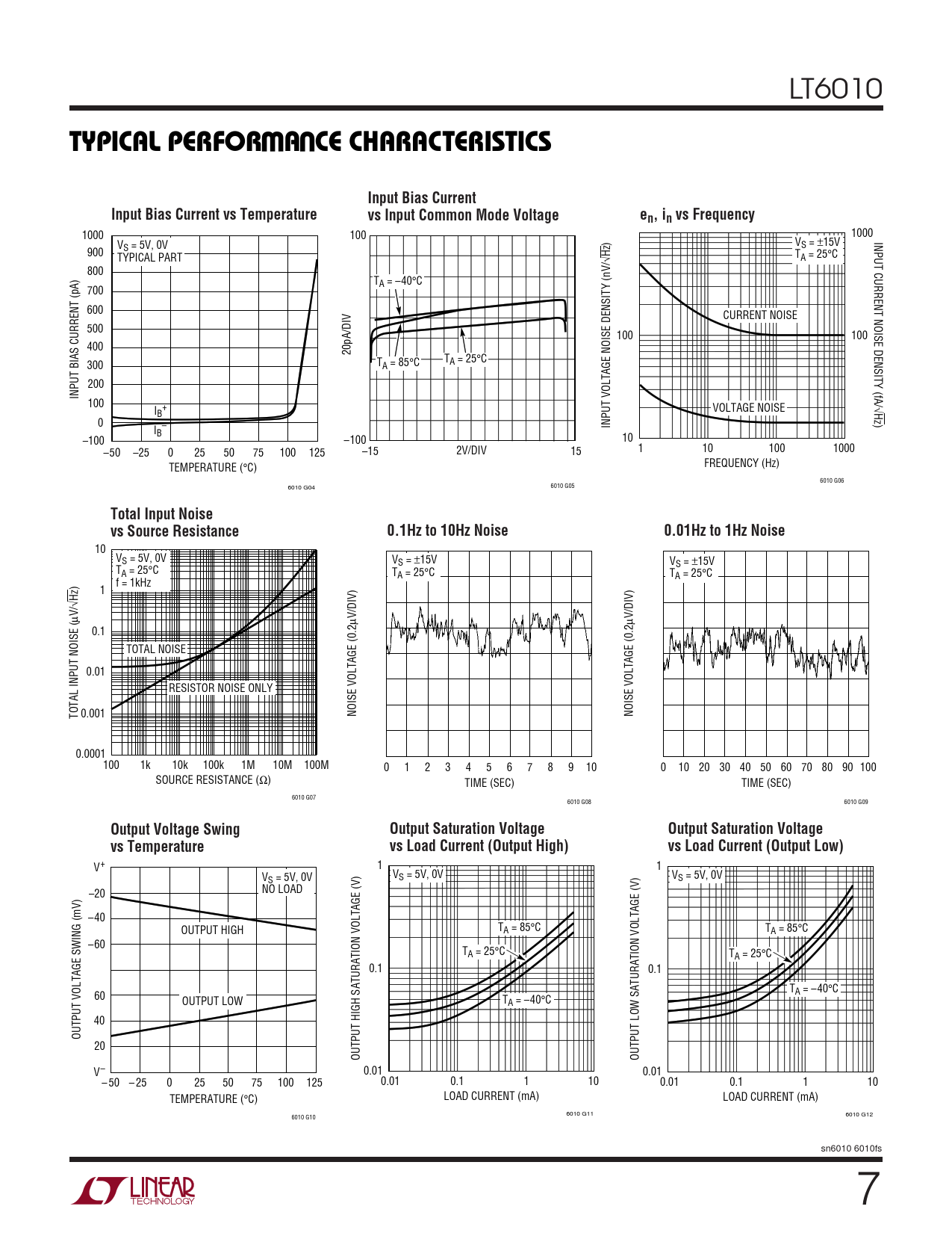

Description135µA, 14nV/√Hz, Rail-to-Rail Output Precision Op Amp with Shutdown
Pages / Page16 / 7 — TYPICAL PERFOR A CE CHARACTERISTICS. Input Bias Current. Input Bias …
File Format / SizePDF / 304 Kb
TYPICAL PERFOR A CE CHARACTERISTICS. Input Bias Current. Input Bias Current vs Temperature. vs Input Common Mode Voltage
TYPICAL PERFOR A CE CHARACTERISTICS Input Bias Current Input Bias Current vs Temperature vs Input Common Mode Voltage
LT6010
W U TYPICAL PERFOR A CE CHARACTERISTICS Input Bias Current Input Bias Current vs Temperature vs Input Common Mode Voltage en, in vs Frequency
1000 1000 100 INPUT CURRENT NOISE DENSITY (fA/ V VS = ±15V 900 S = 5V, 0V TYPICAL PART √Hz) TA = 25°C 800 TA = –40°C 700 600 CURRENT NOISE 500 100 100 400 20pA/DIV 300 TA = 85°C TA = 25°C 200 INPUT BIAS CURRENT (pA) 100 √ I + VOLTAGE NOISE B Hz) 0 INPUT VOLTAGE NOISE DENSITY (nV/ I – B –100 10 –100 –50 –25 0 25 50 75 100 125 –15 2V/DIV 1 10 100 1000 15 TEMPERATURE (°C) FREQUENCY (Hz) 6010 G06 6010 G04 6010 G05
Total Input Noise vs Source Resistance 0.1Hz to 10Hz Noise 0.01Hz to 1Hz Noise
10 VS = 5V, 0V VS = ±15V VS = ±15V TA = 25°C TA = 25°C TA = 25°C f = 1kHz 1 √Hz) µV/ µV/DIV) µV/DIV) 0.1 TOTAL NOISE 0.01 RESISTOR NOISE ONLY TOTAL INPUT NOISE ( 0.001 NOISE VOLTAGE (0.2 NOISE VOLTAGE (0.2 0.0001 100 1k 10k 100k 1M 10M 100M 0 1 2 3 4 5 6 7 8 9 10 0 10 20 30 40 50 60 70 80 90 100 SOURCE RESISTANCE (Ω) TIME (SEC) TIME (SEC) 6010 G07 6010 G08 6010 G09
Output Voltage Swing Output Saturation Voltage Output Saturation Voltage vs Temperature vs Load Current (Output High) vs Load Current (Output Low)
V+ 1 1 V V V S = 5V, 0V S = 5V, 0V S = 5V, 0V –20 NO LOAD –40 OUTPUT HIGH TA = 85°C TA = 85°C –60 TA = 25°C TA = 25°C 0.1 0.1 T 60 A = –40°C OUTPUT LOW TA = –40°C 40 OUTPUT VOLTAGE SWING (mV) 20 OUTPUT HIGH SATURATION VOLTAGE (V) OUTPUT LOW SATURATION VOLTAGE (V) V– 0.01 0.01 – 50 – 25 0 25 50 75 100 125 0.01 0.1 1 10 0.01 0.1 1 10 TEMPERATURE (°C) LOAD CURRENT (mA) LOAD CURRENT (mA) 6010 G11 6010 G12 6010 G10 sn6010 6010fs 7
