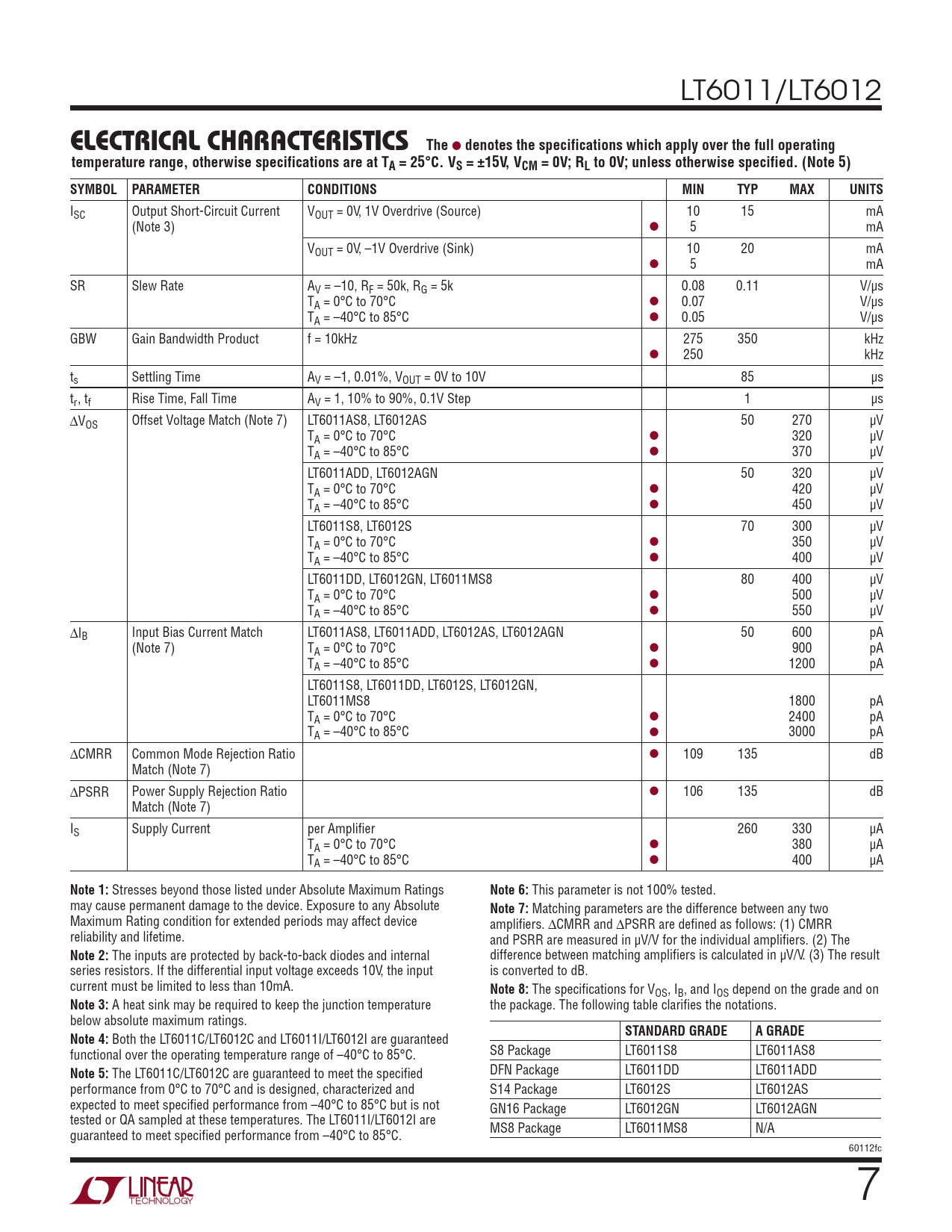

denotes the specifications which apply over the full operating temperature range, otherwise specifications are at TA = 25°C. VS = ±15V, VCM = 0V; RL to 0V; unless otherwise specified. (Note 5) SYMBOL PARAMETER CONDITIONS MIN TYP MAX UNITS
ISC Output Short-Circuit Current VOUT = 0V, 1V Overdrive (Source) 10 15 mA (Note 3) l 5 mA VOUT = 0V, –1V Overdrive (Sink) 10 20 mA l 5 mA SR Slew Rate AV = –10, RF = 50k, RG = 5k 0.08 0.11 V/µs TA = 0°C to 70°C l 0.07 V/µs TA = –40°C to 85°C l 0.05 V/µs GBW Gain Bandwidth Product f = 10kHz 275 350 kHz l 250 kHz ts Settling Time AV = –1, 0.01%, VOUT = 0V to 10V 85 µs tr , tf Rise Time, Fall Time AV = 1, 10% to 90%, 0.1V Step 1 µs ∆VOS Offset Voltage Match (Note 7) LT6011AS8, LT6012AS 50 270 µV TA = 0°C to 70°C l 320 µV TA = –40°C to 85°C l 370 µV LT6011ADD, LT6012AGN 50 320 µV TA = 0°C to 70°C l 420 µV TA = –40°C to 85°C l 450 µV LT6011S8, LT6012S 70 300 µV TA = 0°C to 70°C l 350 µV TA = –40°C to 85°C l 400 µV LT6011DD, LT6012GN, LT6011MS8 80 400 µV TA = 0°C to 70°C l 500 µV TA = –40°C to 85°C l 550 µV ∆IB Input Bias Current Match LT6011AS8, LT6011ADD, LT6012AS, LT6012AGN 50 600 pA (Note 7) TA = 0°C to 70°C l 900 pA TA = –40°C to 85°C l 1200 pA LT6011S8, LT6011DD, LT6012S, LT6012GN, LT6011MS8 1800 pA TA = 0°C to 70°C l 2400 pA TA = –40°C to 85°C l 3000 pA ∆CMRR Common Mode Rejection Ratio l 109 135 dB Match (Note 7) ∆PSRR Power Supply Rejection Ratio l 106 135 dB Match (Note 7) IS Supply Current per Amplifier 260 330 µA TA = 0°C to 70°C l 380 µA TA = –40°C to 85°C l 400 µA
Note 1:
Note 6:
This parameter is not 100% tested. may cause permanent damage to the device. Exposure to any Absolute
Note 7:
Matching parameters are the difference between any two Maximum Rating condition for extended periods may affect device amplifiers. ∆CMRR and ∆PSRR are defined as follows: (1) CMRR reliability and lifetime. and PSRR are measured in µV/V for the individual amplifiers. (2) The
Note 2:
The inputs are protected by back-to-back diodes and internal difference between matching amplifiers is calculated in µV/V. (3) The result series resistors. If the differential input voltage exceeds 10V, the input is converted to dB. current must be limited to less than 10mA.
Note 8:
The specifications for VOS, IB, and IOS depend on the grade and on
Note 3:
A heat sink may be required to keep the junction temperature the package. The following table clarifies the notations. below absolute maximum ratings.
Note 4:
Both the LT6011C/LT6012C and LT6011I/LT6012I are guaranteed
STANDARD GRADE A GRADE
functional over the operating temperature range of –40°C to 85°C. S8 Package LT6011S8 LT6011AS8
Note 5:
The LT6011C/LT6012C are guaranteed to meet the specified DFN Package LT6011DD LT6011ADD performance from 0°C to 70°C and is designed, characterized and S14 Package LT6012S LT6012AS expected to meet specified performance from –40°C to 85°C but is not GN16 Package LT6012GN LT6012AGN tested or QA sampled at these temperatures. The LT6011I/LT6012I are guaranteed to meet specified performance from –40°C to 85°C. MS8 Package LT6011MS8 N/A 60112fc 7 Document Outline Features Applications Description Typical Application Absolute Maximum Ratings Package/Order Information Order Information Electrical Characteristics Typical Performance Characteristics Applications Information Simplified Schematic Package Description Revision History Typical Application Related Parts
