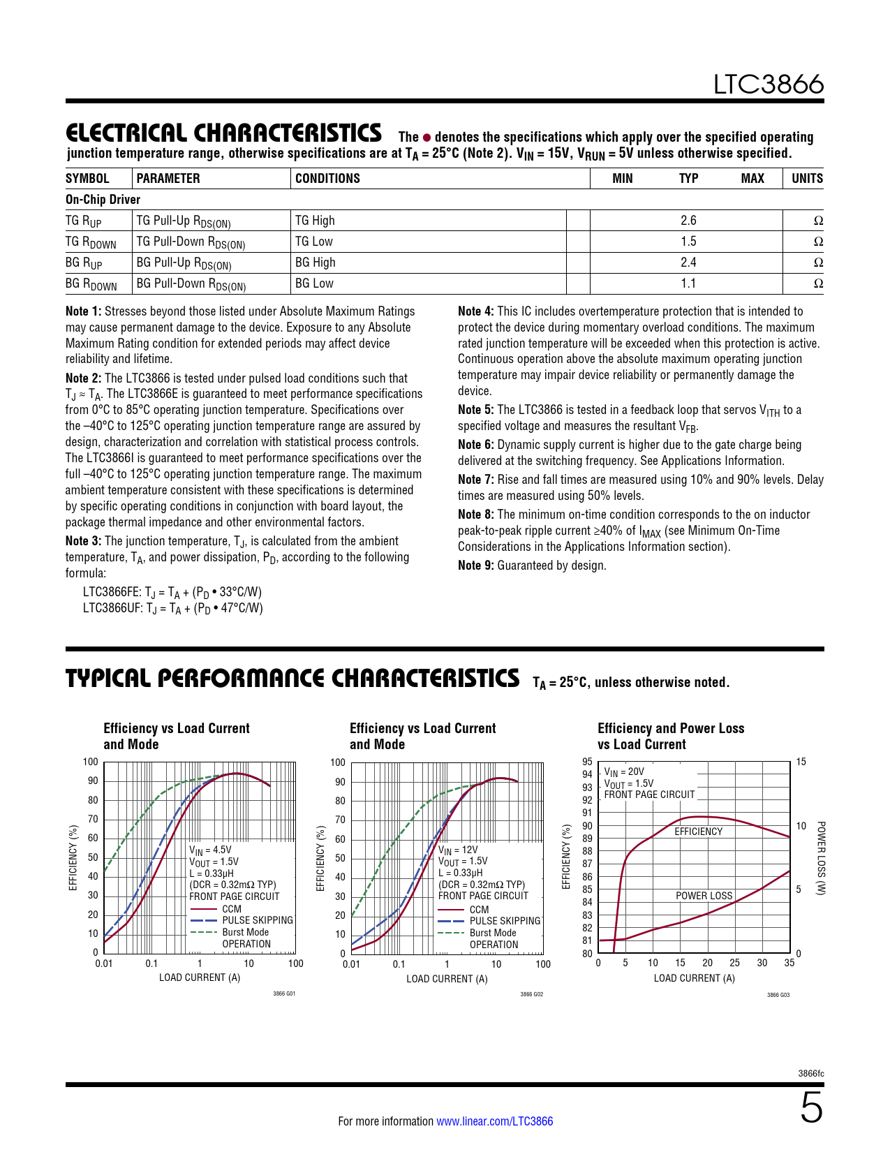

e lecTrical characTerisTics The. denotes the specifications which apply over the specified operating
e lecTrical characTerisTics The denotes the specifications which apply over the specified operating
LTC3866
l
denotes the specifications which apply over the specified operating junction temperature range, otherwise specifications are at TA = 25°C (Note 2). VIN = 15V, VRUN = 5V unless otherwise specified. SYMBOL PARAMETER CONDITIONS MIN TYP MAX UNITS On-Chip Driver
TG RUP TG Pull-Up RDS(ON) TG High 2.6 Ω TG RDOWN TG Pull-Down RDS(ON) TG Low 1.5 Ω BG RUP BG Pull-Up RDS(ON) BG High 2.4 Ω BG RDOWN BG Pull-Down RDS(ON) BG Low 1.1 Ω

Typical perForMance characTerisTics TA = 25°C, unless otherwise noted. Efficiency vs Load Current Efficiency vs Load Current Efficiency and Power Loss and Mode and Mode vs Load Current
