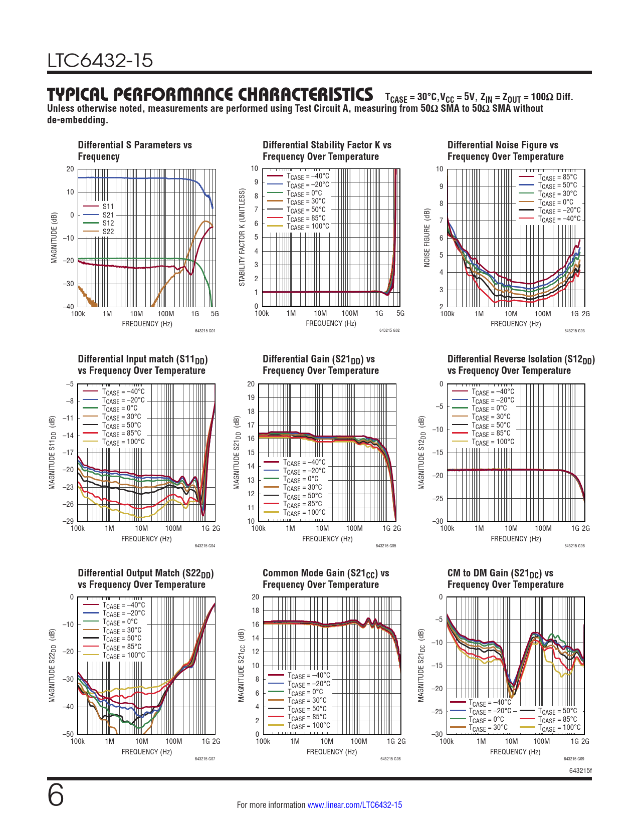

Pages / Page20 / 6 — TYPICAL PERFORMANCE CHARACTERISTICS. TCASE = 30°C,VCC = 5V, ZIN = ZOUT = …
TYPICAL PERFORMANCE CHARACTERISTICS. TCASE = 30°C,VCC = 5V, ZIN = ZOUT = 100Ω Diff
TYPICAL PERFORMANCE CHARACTERISTICS TCASE = 30°C,VCC = 5V, ZIN = ZOUT = 100Ω Diff
LTC6432-15
TYPICAL PERFORMANCE CHARACTERISTICS TCASE = 30°C,VCC = 5V, ZIN = ZOUT = 100Ω Diff. Unless otherwise noted, measurements are performed using Test Circuit A, measuring from 50Ω SMA to 50Ω SMA without de-embedding. Differential S Parameters vs Differential Stability Factor K vs Differential Noise Figure vs Frequency Frequency Over Temperature Frequency Over Temperature
20 10 10 TCASE = –40°C TCASE = 85°C 9 TCASE = –20°C 9 TCASE = 50°C 10 TCASE = 0°C T 8 CASE = 30°C TCASE = 30°C 8 T S11 CASE = 0°C 7 TCASE = 50°C T 0 S21 CASE = –20°C TCASE = 85°C T S12 7 CASE = –40°C 6 T S22 CASE = 100°C –10 5 6 ACTOR K (UNITLESS) 4 5 MAGNITUDE (dB) –20 Y F 3 NOISE FIGURE (dB) 4 ABILIT 2 –30 ST 3 1 –40 0 2 100k 1M 10M 100M 1G 5G 100k 1M 10M 100M 1G 5G 100k 1M 10M 100M 1G 2G FREQUENCY (Hz) FREQUENCY (Hz) FREQUENCY (Hz) 643215 G01 643215 G02 643215 G03
Differential Input match (S11DD) Differential Gain (S21DD) vs Differential Reverse Isolation (S12DD) vs Frequency Over Temperature Frequency Over Temperature vs Frequency Over Temperature
–5 20 0 TCASE = –40°C TCASE = –40°C –8 T 19 CASE = –20°C TCASE = –20°C TCASE = 0°C –5 18 TCASE = 0°C –11 TCASE = 30°C TCASE = 30°C (dB) TCASE = 50°C 17 TCASE = 50°C T (dB) (dB) –10 T DD –14 CASE = 85°C CASE = 85°C T DD 16 DD CASE = 100°C TCASE = 100°C –17 15 –15 TCASE = –40°C –20 14 TCASE = –20°C –20 13 TCASE = 0°C MAGNITUDE S11 –23 MAGNITUDE S21 TCASE = 30°C MAGNITUDE S12 12 TCASE = 50°C –25 –26 11 TCASE = 85°C TCASE = 100°C –29 10 –30 100k 1M 10M 100M 1G 2G 100k 1M 10M 100M 1G 2G 100k 1M 10M 100M 1G 2G FREQUENCY (Hz) FREQUENCY (Hz) FREQUENCY (Hz) 643215 G04 643215 G05 643215 G06
Differential Output Match (S22DD) Common Mode Gain (S21CC) vs CM to DM Gain (S21DC) vs vs Frequency Over Temperature Frequency Over Temperature Frequency Over Temperature
0 20 0 TCASE = –40°C T 18 CASE = –20°C –5 –10 TCASE = 0°C 16 TCASE = 30°C (dB) TCASE = 50°C 14 (dB) (dB) –10 DD T –20 CASE = 85°C CC DC T 12 CASE = 100°C 10 –15 –30 8 TCASE = –40°C TCASE = –20°C –20 6 TCASE = 0°C MAGNITUDE S22 MAGNITUDE S21 TCASE = 30°C MAGNITUDE S21 –40 4 T T CASE = –40°C CASE = 50°C –25 TCASE = –20°C TCASE = 50°C 2 TCASE = 85°C T T T CASE = 0°C CASE = 85°C CASE = 100°C TCASE = 30°C TCASE = 100°C –50 0 –30 100k 1M 10M 100M 1G 2G 100k 1M 10M 100M 1G 2G 100k 1M 10M 100M 1G 2G FREQUENCY (Hz) FREQUENCY (Hz) FREQUENCY (Hz) 643215 G07 643215 G08 643215 G09 643215f 6 For more information www.linear.com/LTC6432-15 Document Outline Features Applications Description Typical Application Absolute Maximum Ratings Pin Configuration Order Information DC Electrical Characteristics AC Electrical Characteristics Typical Performance Characteristics Pin Functions Block Diagram Test Circuit A Operation Applications Information Differential S Parameters Package Description Typical Application Related Parts
