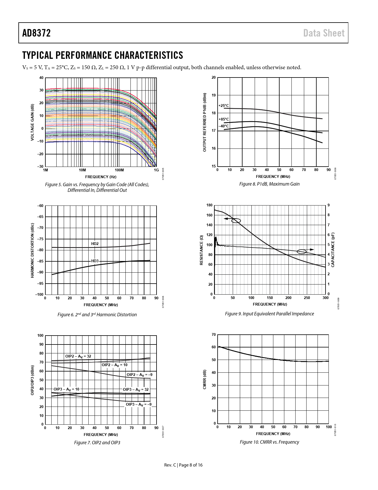

AD8372. Data Sheet. TYPICAL PERFORMANCE CHARACTERISTICS. m B d. +25°C. d (. 1dB. D E. +85°C. E G. –40°C. R T. VO –10. U TP. –20. –30. 10M. 100M
AD8372 Data Sheet TYPICAL PERFORMANCE CHARACTERISTICS m B d +25°C d ( 1dB D E +85°C E G –40°C R T VO –10 U TP –20 –30 10M 100M
VS = 5 V, TA = 25°C, ZS = 150 Ω, ZL = 250 Ω, 1 V p-p differential output, both channels enabled, unless otherwise noted.
40 20 30 ) 19 m B d ) 20 ( B +25°C d ( 1dB IN P 18 A 10 D E +85°C R E G R G –40°C A 0 FE T E 17 L R T VO –10 U TP 16 OU –20 –30 15

07 07 Figure 5. Gain vs. Frequency by Gain Code (All Codes), Figure 8. P1dB, Maximum Gain Differential In, Differential Out
–60 180 9 –65 160 8 140 7 Bc) –70 d ( ) N ) 120 6 F IO –75 p T ( ( R HD2 5 CE O 100 T –80 ANCE AN IS T T D IS 80 4 CI IC S A –85 HD3 N O RE 60 3 CAP RM –90 40 2 HA –95 20 1 –100 0 0 0 10 20 30 40 50 60 70 80 90

51 07 70 0 Figure 6. 2nd and 3rd Harmonic Distortion Figure 9. Input Equivalent Parallel Impedance
100 70 90 60 80 OIP2 – AV = 32 50 70 ) OIP2 – AV = 10 m B 60 ) d B OIP2 – A d 40 3 ( V = –9 50 IP RR ( 2/O 30 40 OIP3 – A CM V = 10 OIP3 – AV = 32 OIP 30 20 OIP3 – A 20 V = –9 10 10 0 0

07 07 Figure 7. OIP2 and OIP3 Figure 10. CMRR vs. Frequency Rev. C | Page 8 of 16 Document Outline FEATURES APPLICATIONS FUNCTIONAL BLOCK DIAGRAM GENERAL DESCRIPTION REVISION HISTORY SPECIFICATIONS SERIAL CONTROL INTERFACE TIMING ABSOLUTE MAXIMUM RATINGS ESD CAUTION PIN CONFIGURATION AND FUNCTION DESCRIPTIONS TYPICAL PERFORMANCE CHARACTERISTICS THEORY OF OPERATION SINGLE-ENDED AND DIFFERENTIAL SIGNALS PASSIVE FILTER TECHNIQUES DIGITAL GAIN CONTROL DRIVING ANALOG-TO-DIGITAL CONVERTERS EVALUATION BOARD SCHEMATIC OUTLINE DIMENSIONS ORDERING GUIDE
