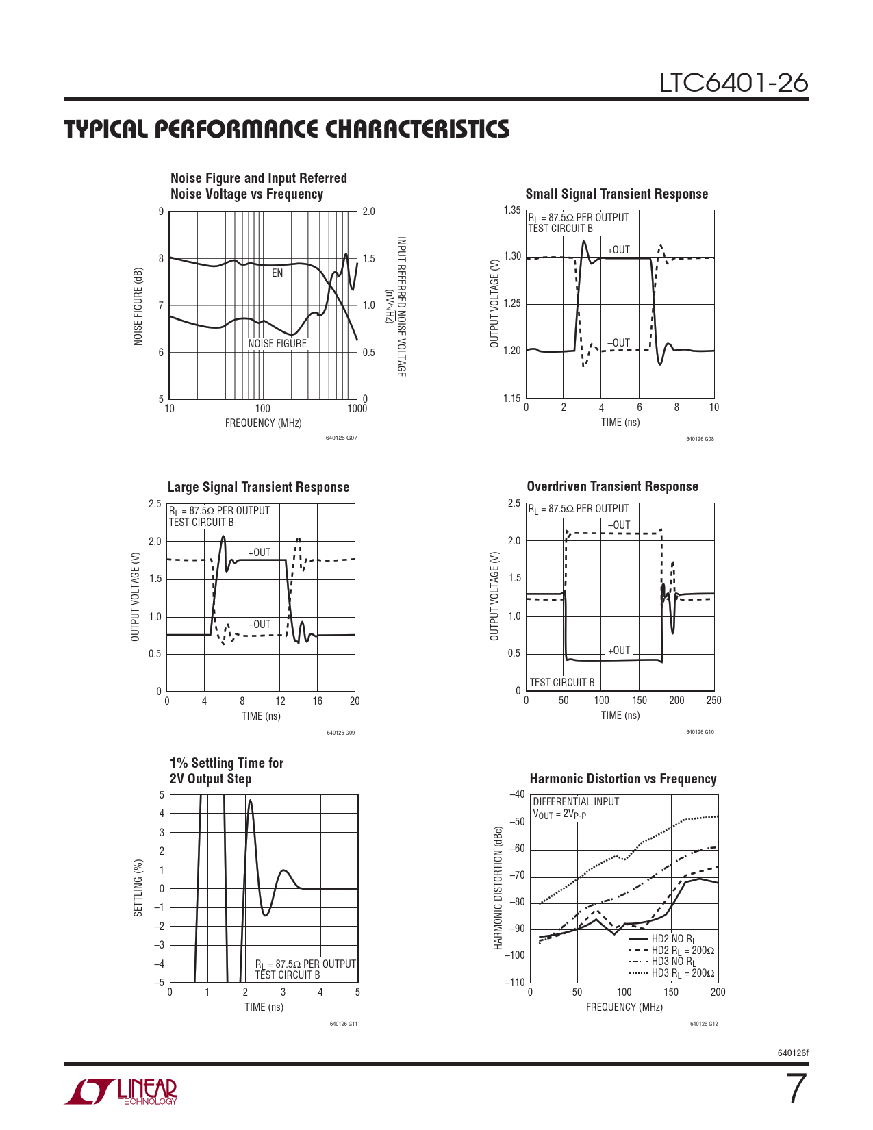

TYPICAL PERFORMANCE CHARACTERISTICS. Noise Figure and Input Referred Noise Voltage vs Frequency
TYPICAL PERFORMANCE CHARACTERISTICS Noise Figure and Input Referred Noise Voltage vs Frequency
LTC6401-26
TYPICAL PERFORMANCE CHARACTERISTICS Noise Figure and Input Referred Noise Voltage vs Frequency Small Signal Transient Response
9 2.0 1.35 RL = 87.5Ω PER OUTPUT INPUT REFERRED NOISE VOLTAGE TEST CIRCUIT B +OUT 8 1.5 1.30 EN (nV/ √ 7 1.0 Hz) 1.25 NOISE FIGURE (dB) NOISE FIGURE OUTPUT VOLTAGE (V) –OUT 6 0.5 1.20 5 0 1.15 10 100 1000 0 2 4 6 8 10 FREQUENCY (MHz) TIME (ns) 640126 G07 640126 G08
Large Signal Transient Response Overdriven Transient Response
2.5 2.5 R R L = 87.5Ω PER OUTPUT L = 87.5Ω PER OUTPUT TEST CIRCUIT B –OUT 2.0 2.0 +OUT 1.5 1.5 1.0 1.0 –OUT OUTPUT VOLTAGE (V) OUTPUT VOLTAGE (V) 0.5 0.5 +OUT TEST CIRCUIT B 0 0 0 4 8 12 16 20 0 50 100 150 200 250 TIME (ns) TIME (ns) 640126 G09 640126 G10
1% Settling Time for 2V Output Step Harmonic Distortion vs Frequency
