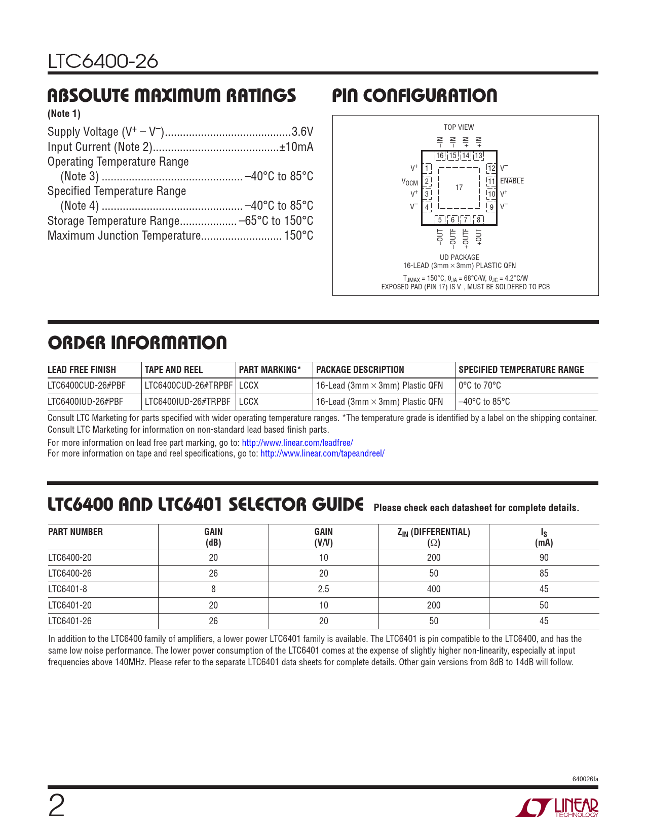

LTC6400-26
ABSOLUTE MAXIMUM RATINGS PIN CONFIGURATION (Note 1)
Supply Voltage (V+ – V–) ..3.6V TOP VIEW Input Current (Note 2) ..±10mA –IN –IN +IN +IN Operating Temperature Range 16 15 14 13 V+ 1 12 V– (Note 3) ... –40°C to 85°C VOCM 2 11 ENABLE Specifi ed Temperature Range 17 V+ 3 10 V+ (Note 4) ... –40°C to 85°C V– 4 9 V– Storage Temperature Range ... –65°C to 150°C 5 6 7 8 Maximum Junction Temperature... 150°C –OUT –OUTF +OUTF +OUT UD PACKAGE 16-LEAD (3mm s 3mm) PLASTIC QFN TJMAX = 150°C, θJA = 68°C/W, θJC = 4.2°C/W EXPOSED PAD (PIN 17) IS V–, MUST BE SOLDERED TO PCB
ORDER INFORMATION LEAD FREE FINISH TAPE AND REEL PART MARKING* PACKAGE DESCRIPTION SPECIFIED TEMPERATURE RANGE
LTC6400CUD-26#PBF LTC6400CUD-26#TRPBF LCCX 16-Lead (3mm × 3mm) Plastic QFN 0°C to 70°C LTC6400IUD-26#PBF LTC6400IUD-26#TRPBF LCCX 16-Lead (3mm × 3mm) Plastic QFN –40°C to 85°C Consult LTC Marketing for parts specifi ed with wider operating temperature ranges. *The temperature grade is identifi ed by a label on the shipping container. Consult LTC Marketing for information on non-standard lead based fi nish parts. For more information on lead free part marking, go to: http://www.linear.com/leadfree/ For more information on tape and reel specifi cations, go to: http://www.linear.com/tapeandreel/
LTC6400 AND LTC6401 SELECTOR GUIDE Please check each datasheet for complete details. PART NUMBER GAIN GAIN ZIN (DIFFERENTIAL) IS (dB) (V/V) (
Ω
) (mA)
LTC6400-20 20 10 200 90 LTC6400-26 26 20 50 85 LTC6401-8 8 2.5 400 45 LTC6401-20 20 10 200 50 LTC6401-26 26 20 50 45 In addition to the LTC6400 family of amplifi ers, a lower power LTC6401 family is available. The LTC6401 is pin compatible to the LTC6400, and has the same low noise performance. The lower power consumption of the LTC6401 comes at the expense of slightly higher non-linearity, especially at input frequencies above 140MHz. Please refer to the separate LTC6401 data sheets for complete details. Other gain versions from 8dB to 14dB will follow. 640026fa 2
