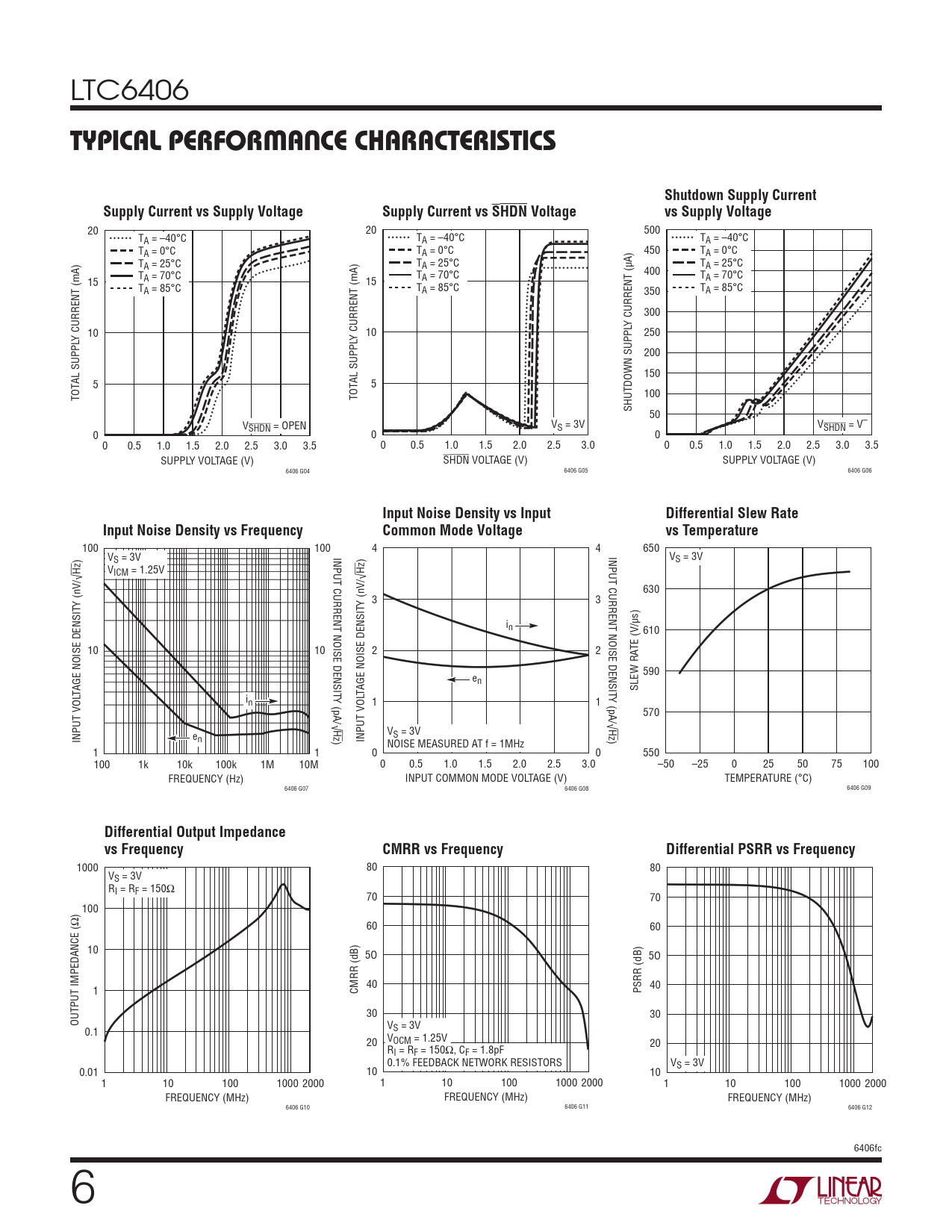

TYPICAL PERFORMANCE CHARACTERISTICS. Shutdown Supply Current. Supply Current vs Supply Voltage
TYPICAL PERFORMANCE CHARACTERISTICS Shutdown Supply Current Supply Current vs Supply Voltage
LTC6406
TYPICAL PERFORMANCE CHARACTERISTICS Shutdown Supply Current Supply Current vs Supply Voltage Supply Current vs SHDN Voltage vs Supply Voltage
20 20 500 TA = –40°C TA = –40°C TA = –40°C TA = 0°C TA = 0°C 450 TA = 0°C TA = 25°C TA = 25°C TA = 25°C T T 400 T 15 A = 70°C A = 70°C 15 A = 70°C TA = 85°C TA = 85°C 350 TA = 85°C 300 Y CURRENT (μA) Y CURRENT (mA) 10 Y CURRENT (mA) 10 250 200 150 AL SUPPL 5 AL SUPPL 5 TOT TOT 100 SHUTDOWN SUPPL 50 VSHDN = OPEN VS = 3V VSHDN = V– 0 0 0 0 0.5 1.0 1.5 2.0 2.5 3.0 3.5 0 0.5 1.0 1.5 2.0 2.5 3.0 0 0.5 1.0 1.5 2.0 2.5 3.0 3.5 SUPPLY VOLTAGE (V) SHDN VOLTAGE (V) SUPPLY VOLTAGE (V) 6406 G04 6406 G05 6406 G06
Input Noise Density vs Input Differential Slew Rate Input Noise Density vs Frequency Common Mode Voltage vs Temperature
100 100 4 4 650 INPUT CURRENT NOISE DENSIT INPUT CURRENT NOISE DENSIT ) VS = 3V ) VS = 3V Hz VICM = 1.25V Hz /√ /√ 630 Y (nV 3 3 Y (nV in /μs) 610 10 10 2 2 TE (V 590 en TAGE NOISE DENSIT SLEW RA Y (pA/√ TAGE NOISE DENSIT Y (pA/√ in 1 1 570 Hz Hz VS = 3V INPUT VOL en ) INPUT VOL ) NOISE MEASURED AT f = 1MHz 1 1 0 0 550 100 1k 10k 100k 1M 10M 0 0.5 1.0 1.5 2.0 2.5 3.0 –50 –25 0 25 50 75 100 FREQUENCY (Hz) INPUT COMMON MODE VOLTAGE (V) TEMPERATURE (°C) 6406 G07 6406 G08 6406 G09
Differential Output Impedance vs Frequency CMRR vs Frequency Differential PSRR vs Frequency
1000 80 80 VS = 3V RI = RF = 150Ω 70 70 100 60 60 10 5O 5O 40 40 1 CMRR (dB) PSRR (dB) 30 30 OUTPUT IMPEDANCE (Ω) V 0.1 S = 3V VOCM = 1.25V 20 20 RI = RF = 150Ω, CF = 1.8pF 0.1% FEEDBACK NETWORK RESISTORS VS = 3V 0.01 10 10 1 10 100 1000 2000 1 10 100 1000 2000 1 10 100 1000 2000 FREQUENCY (MHz) FREQUENCY (MHz) FREQUENCY (MHz) 6406 G10 6406 G11 6406 G12 6406fc 6
