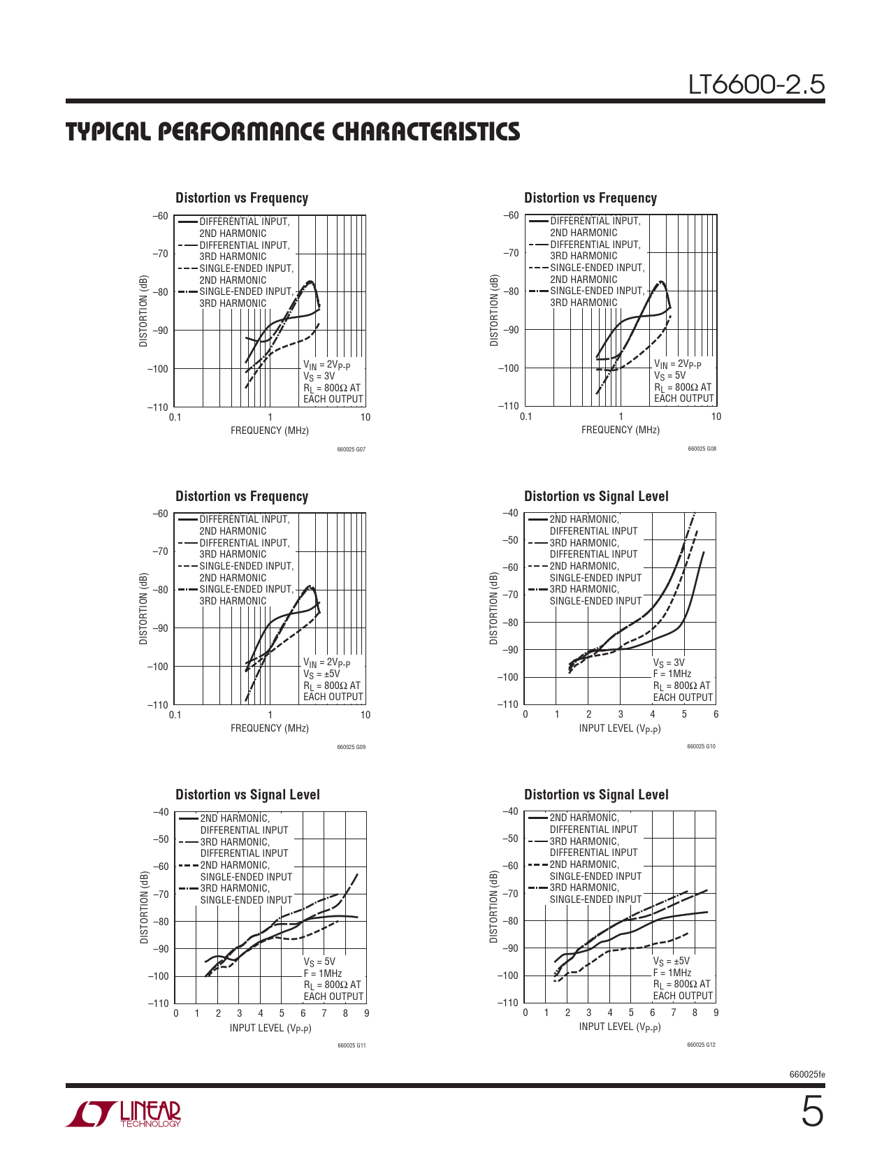

TYPICAL PERFORMANCE CHARACTERISTICS. Distortion vs Frequency. Distortion vs Signal Level
TYPICAL PERFORMANCE CHARACTERISTICS Distortion vs Frequency Distortion vs Signal Level
LT6600-2.5
TYPICAL PERFORMANCE CHARACTERISTICS Distortion vs Frequency Distortion vs Frequency
–60 –60 DIFFERENTIAL INPUT, DIFFERENTIAL INPUT, 2ND HARMONIC 2ND HARMONIC DIFFERENTIAL INPUT, DIFFERENTIAL INPUT, –70 3RD HARMONIC –70 3RD HARMONIC SINGLE-ENDED INPUT, SINGLE-ENDED INPUT, 2ND HARMONIC 2ND HARMONIC –80 SINGLE-ENDED INPUT, –80 SINGLE-ENDED INPUT, 3RD HARMONIC 3RD HARMONIC –90 –90 DISTORTION (dB) DISTORTION (dB) V –100 VIN = 2VP-P –100 IN = 2VP-P VS = 3V VS = 5V RL = 800Ω AT RL = 800Ω AT EACH OUTPUT EACH OUTPUT –110 –110 0.1 1 10 0.1 1 10 FREQUENCY (MHz) FREQUENCY (MHz) 660025 G07 660025 G08
–60 –40 DIFFERENTIAL INPUT, 2ND HARMONIC, 2ND HARMONIC DIFFERENTIAL INPUT DIFFERENTIAL INPUT, –50 3RD HARMONIC, –70 3RD HARMONIC DIFFERENTIAL INPUT SINGLE-ENDED INPUT, –60 2ND HARMONIC, 2ND HARMONIC SINGLE-ENDED INPUT –80 SINGLE-ENDED INPUT, 3RD HARMONIC, –70 3RD HARMONIC SINGLE-ENDED INPUT –80 –90 DISTORTION (dB) DISTORTION (dB) –90 –100 VIN = 2VP-P VS = 3V VS = ±5V –100 F = 1MHz RL = 800Ω AT RL = 800Ω AT EACH OUTPUT EACH OUTPUT –110 –110 0.1 1 10 0 1 2 3 4 5 6 FREQUENCY (MHz) INPUT LEVEL (VP-P) 660025 G09 660025 G10
Distortion vs Signal Level Distortion vs Signal Level
–40 –40 2ND HARMONIC, 2ND HARMONIC, DIFFERENTIAL INPUT DIFFERENTIAL INPUT –50 3RD HARMONIC, –50 3RD HARMONIC, DIFFERENTIAL INPUT DIFFERENTIAL INPUT –60 2ND HARMONIC, –60 2ND HARMONIC, SINGLE-ENDED INPUT SINGLE-ENDED INPUT 3RD HARMONIC, 3RD HARMONIC, –70 –70 SINGLE-ENDED INPUT SINGLE-ENDED INPUT –80 –80 DISTORTION (dB) DISTORTION (dB) –90 –90 VS = 5V VS = ±5V –100 F = 1MHz –100 F = 1MHz RL = 800Ω AT RL = 800Ω AT EACH OUTPUT EACH OUTPUT –110 –110 0 1 2 3 4 5 6 7 8 9 0 1 2 3 4 5 6 7 8 9 INPUT LEVEL (VP-P) INPUT LEVEL (VP-P) 660025 G11 660025 G12 660025fe 5
