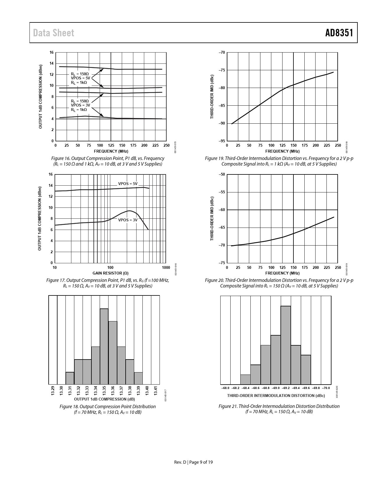

031 031 Figure 16. Output Compression Point, P1 dB, vs. Frequency Figure 19. Third-Order Intermodulation Distortion vs. Frequency for a 2 V p-p (RL = 150 Ω and 1 kΩ, AV = 10 dB, at 3 V and 5 V Supplies) Composite Signal into RL = 1 kΩ (AV = 10 dB, at 5 V Supplies)

031 031 Figure 17. Output Compression Point, P1 dB, vs. RG (f =100 MHz, Figure 20. Third-Order Intermodulation Distortion vs. Frequency for a 2 V p-p RL = 150 Ω, AV = 10 dB, at 3 V and 5 V Supplies) Composite Signal into RL = 150 Ω (AV = 10 dB, at 5 V Supplies)

3145- 0 Figure 18. Output Compression Point Distribution Figure 21. Third-Order Intermodulation Distortion Distribution (f = 70 MHz, RL = 150 Ω, AV = 10 dB) (f = 70 MHz, RL = 150 Ω, AV = 10 dB) Rev. D | Page 9 of 19 Document Outline FEATURES APPLICATIONS FUNCTIONAL BLOCK DIAGRAM GENERAL DESCRIPTION TABLE OF CONTENTS REVISION HISTORY SPECIFICATIONS ABSOLUTE MAXIMUM RATINGS ESD CAUTION PIN CONFIGURATIONS AND FUNCTION DESCRIPTIONS TYPICAL PERFORMANCE CHARACTERISTICS THEORY OF OPERATION BASIC CONCEPTS GAIN ADJUSTMENT COMMON-MODE ADJUSTMENT INPUT AND OUTPUT MATCHING SINGLE-ENDED-TO-DIFFERENTIAL OPERATION ADC DRIVING ANALOG MULTIPLEXING I/O CAPACITIVE LOADING TRANSMISSION LINE EFFECTS CHARACTERIZATION SETUP EVALUATION BOARD OUTLINE DIMENSIONS ORDERING GUIDE
