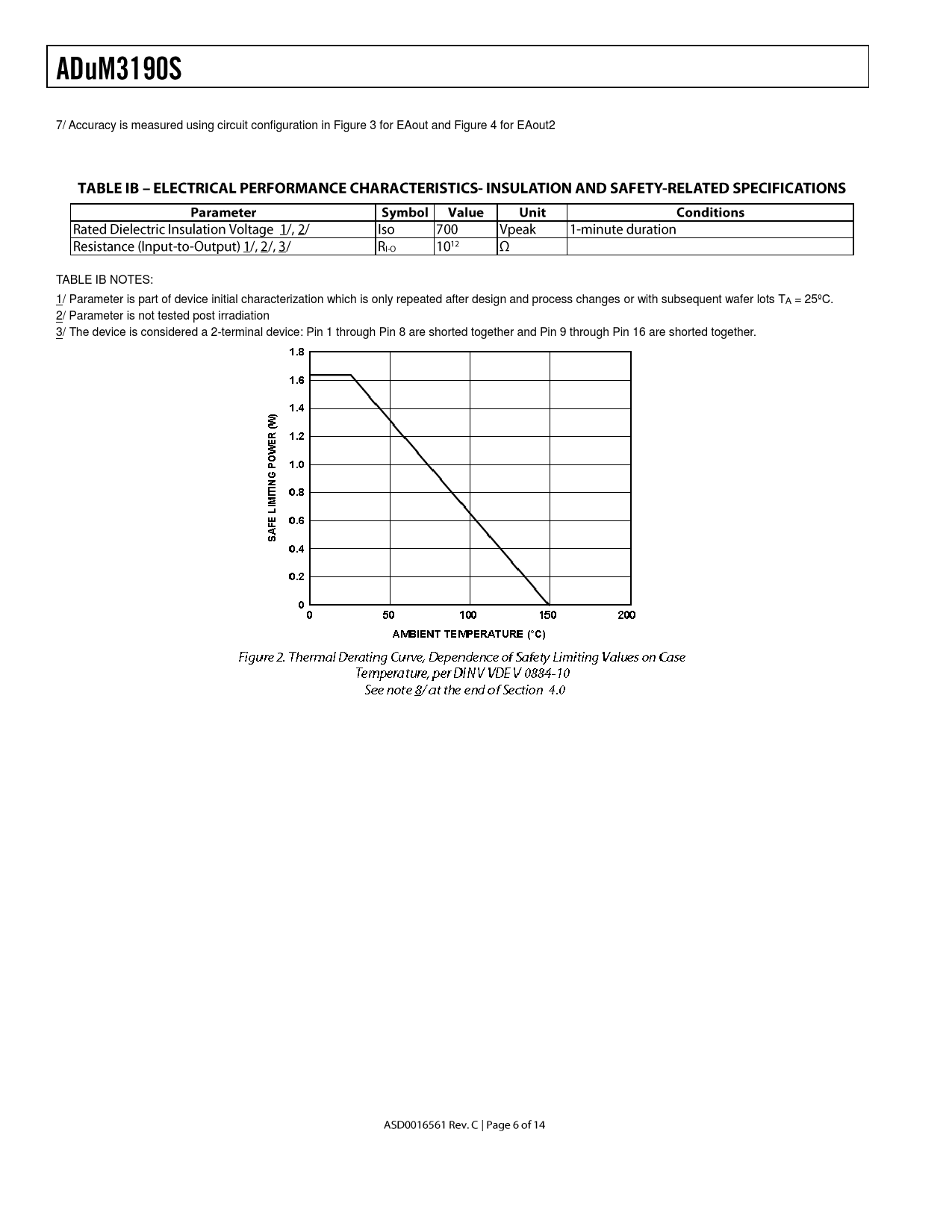

7/. Accuracy. is. measured. using. circuit. configuration. in. Figure. 3. for. EAout. and. Figure. 4. for. EAout2. TABLE. IB. NOTES:. 1/. Parameter. is. part. of. device
7/ Accuracy is measured using circuit configuration in Figure 3 for EAout and Figure 4 for EAout2 TABLE IB NOTES: 1/ Parameter is part of device
7/ Accuracy is measured using circuit configuration in Figure 3 for EAout and Figure 4 for EAout2 TABLE IB NOTES: 1/ Parameter is part of device initial characterization which is only repeated after design and process changes or with subsequent wafer lots TA = 25ºC. 2/ Parameter is not tested post irradiation 3/ The device is considered a 2-terminal device: Pin 1 through Pin 8 are shorted together and Pin 9 through Pin 16 are shorted together.
