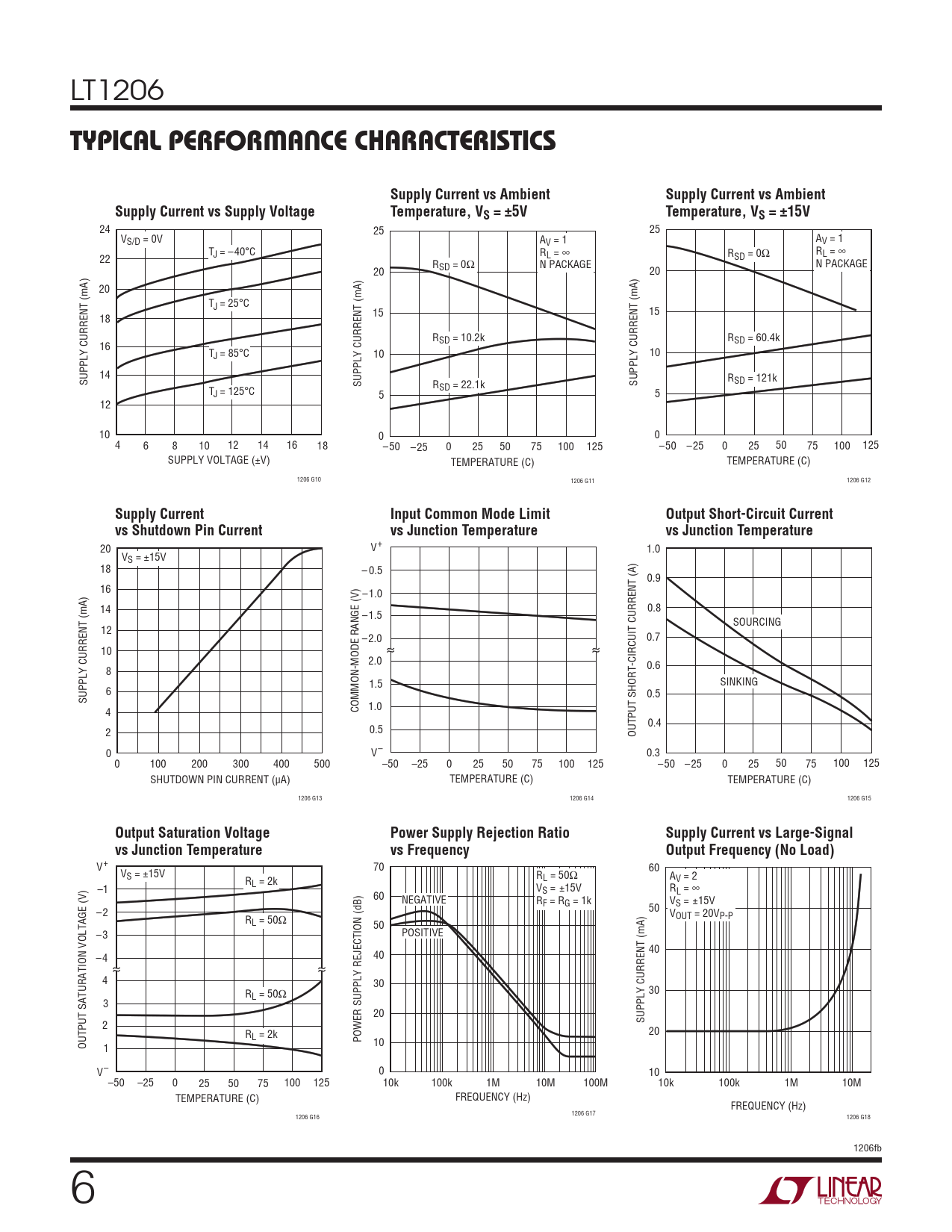

Typical perForMance characTerisTics. Supply Current vs Ambient. Supply Current vs Supply Voltage. Temperature, VS = ±5V
Typical perForMance characTerisTics Supply Current vs Ambient Supply Current vs Supply Voltage Temperature, VS = ±5V
LT1206
Typical perForMance characTerisTics Supply Current vs Ambient Supply Current vs Ambient Supply Current vs Supply Voltage Temperature, VS = ±5V Temperature, VS = ±15V
24 25 25 VS/D = 0V AV = 1 AV = 1 T R R R 22 J = –40°C L = ∞ L = ∞ SD = 0Ω RSD = 0Ω N PACKAGE N PACKAGE 20 20 20 TJ = 25°C 15 18 15 R R 16 SD = 10.2k SD = 60.4k TJ = 85°C 10 10 14 SUPPLY CURRENT (mA) SUPPLY CURRENT (mA) R SUPPLY CURRENT (mA) RSD = 121k T SD = 22.1k J = 125°C 5 5 12 10 0 0 4 6 8 10 12 14 16 18 –50 –25 0 25 50 75 100 125 –50 –25 0 25 50 75 100 125 SUPPLY VOLTAGE (±V) TEMPERATURE (C) TEMPERATURE (C) 1206 G10 1206 G11 1206 G12
Supply Current Input Common Mode Limit Output Short-Circuit Current vs Shutdown Pin Current vs Junction Temperature vs Junction Temperature
20 V+ 1.0 VS = ±15V 18 – 0.5 0.9 16 –1.0 14 0.8 –1.5 SOURCING 12 –2.0 0.7 10 2.0 8 0.6 1.5 SINKING 6 SUPPLY CURRENT (mA) 0.5 4 COMMON-MODE RANGE (V) 1.0 0.4 2 0.5 OUTPUT SHORT-CIRCUIT CURRENT (A) 0 V– 0.3 0 100 200 300 400 500 –50 –25 0 25 50 75 100 125 –50 –25 0 25 50 75 100 125 SHUTDOWN PIN CURRENT (µA) TEMPERATURE (C) TEMPERATURE (C) 1206 G13 1206 G14 1206 G15
Output Saturation Voltage Power Supply Rejection Ratio Supply Current vs Large-Signal vs Junction Temperature vs Frequency Output Frequency (No Load)
V+ V 70 60 S = ±15V R RL = 50Ω AV = 2 –1 L = 2k V R 60 S = ±15V L = ∞ NEGATIVE RF = RG = 1k VS = ±15V –2 50 R VOUT = 20VP-P L = 50Ω 50 –3 POSITIVE 40 –4 40 4 30 R 30 L = 50Ω 3 20 2 SUPPLY CURRENT (mA) R 20 L = 2k OUTPUT SATURATION VOLTAGE (V) POWER SUPPLY REJECTION (dB) 1 10 V– 0 10 –50 –25 0 25 50 75 100 125 10k 100k 1M 10M 100M 10k 100k 1M 10M TEMPERATURE (C) FREQUENCY (Hz) FREQUENCY (Hz) 1206 G17 1206 G16 1206 G18 1206fb 6 Document Outline Features Applications Description Typical Application Absolute Maximum Ratings Pin Configuration Order Information Electrical Characteristics Small-Signal Bandwidth Typical Performance Characteristics Simplified Schematic Applications Information Package Description Revision History Related Parts
