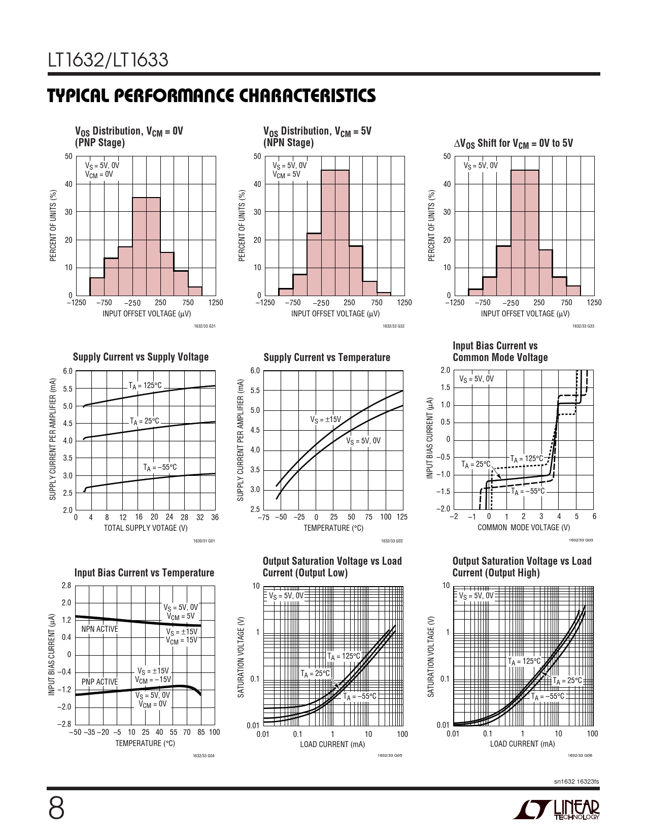

TYPICAL PERFORMANCE CHARACTERISTICS. VOS Distribution, VCM = 0V. VOS Distribution, VCM = 5V. (PNP Stage). (NPN Stage)
TYPICAL PERFORMANCE CHARACTERISTICS VOS Distribution, VCM = 0V VOS Distribution, VCM = 5V (PNP Stage) (NPN Stage)
LT1632/LT1633
W U TYPICAL PERFORMANCE CHARACTERISTICS VOS Distribution, VCM = 0V VOS Distribution, VCM = 5V (PNP Stage) (NPN Stage)
VOS Shift for VCM = 0V to 5V
50 50 50 VS = 5V, 0V VS = 5V, 0V VS = 5V, 0V VCM = 0V VCM = 5V 40 40 40 30 30 30 20 20 20 PERCENT OF UNITS (%) PERCENT OF UNITS (%) PERCENT OF UNITS (%) 10 10 10 0 0 0 –1250 –750 –250 250 750 1250 –1250 –750 –250 250 750 1250 –1250 –750 –250 250 750 1250 INPUT OFFSET VOLTAGE (µV) INPUT OFFSET VOLTAGE (µV) INPUT OFFSET VOLTAGE (µV) 1632/33 G31 1632/33 G32 1632/33 G33
Input Bias Current vs Supply Current vs Supply Voltage Supply Current vs Temperature Common Mode Voltage
6.0 6.0 2.0 VS = 5V, 0V 5.5 TA = 125°C 5.5 1.5 5.0 µA) 1.0 5.0 V 4.5 TA = 25°C S = ±15V 0.5 4.5 4.0 V 0 S = 5V, 0V 4.0 3.5 –0.5 TA = 125°C T TA = 25°C A = –55°C 3.5 3.0 INPUT BIAS CURRENT ( –1.0 2.5 3.0 –1.5 TA = –55°C SUPPLY CURRENT PER AMPLIFIER (mA) SUPPLY CURRENT PER AMPLIFIER (mA) 2.0 2.5 –2.0 0 4 8 12 16 20 24 28 32 36 –75 –50 –25 0 25 50 75 100 125 –2 –1 0 1 2 3 4 5 6 TOTAL SUPPLY VOTAGE (V) TEMPERATURE (°C) COMMON MODE VOLTAGE (V) 1630/31 G01 1632/33 G02 1632/33 G03
Output Saturation Voltage vs Load Output Saturation Voltage vs Load Input Bias Current vs Temperature Current (Output Low) Current (Output High)
2.8 10 10 VS = 5V, 0V VS = 5V, 0V 2.0 VS = 5V, 0V V µA) 1.2 CM = 5V NPN ACTIVE VS = ±15V 1 1 0.4 VCM = 15V 0 TA = 125°C TA = 125°C –0.4 VS = ±15V TA = 25°C PNP ACTIVE VCM = –15V 0.1 0.1 TA = 25°C –1.2 INPUT BIAS CURRENT ( VS = 5V, 0V SATURATION VOLTAGE (V) T SATURATION VOLTAGE (V) A = –55°C TA = –55°C –2.0 VCM = 0V –2.8 0.01 0.01 – 50 –35 – 20 –5 10 25 40 55 70 85 100 0.01 0.1 1 10 100 0.01 0.1 1 10 100 TEMPERATURE (°C) LOAD CURRENT (mA) LOAD CURRENT (mA) 1632/33 G04 1632/33 G05 1632/33 G06 sn1632 16323fs 8
