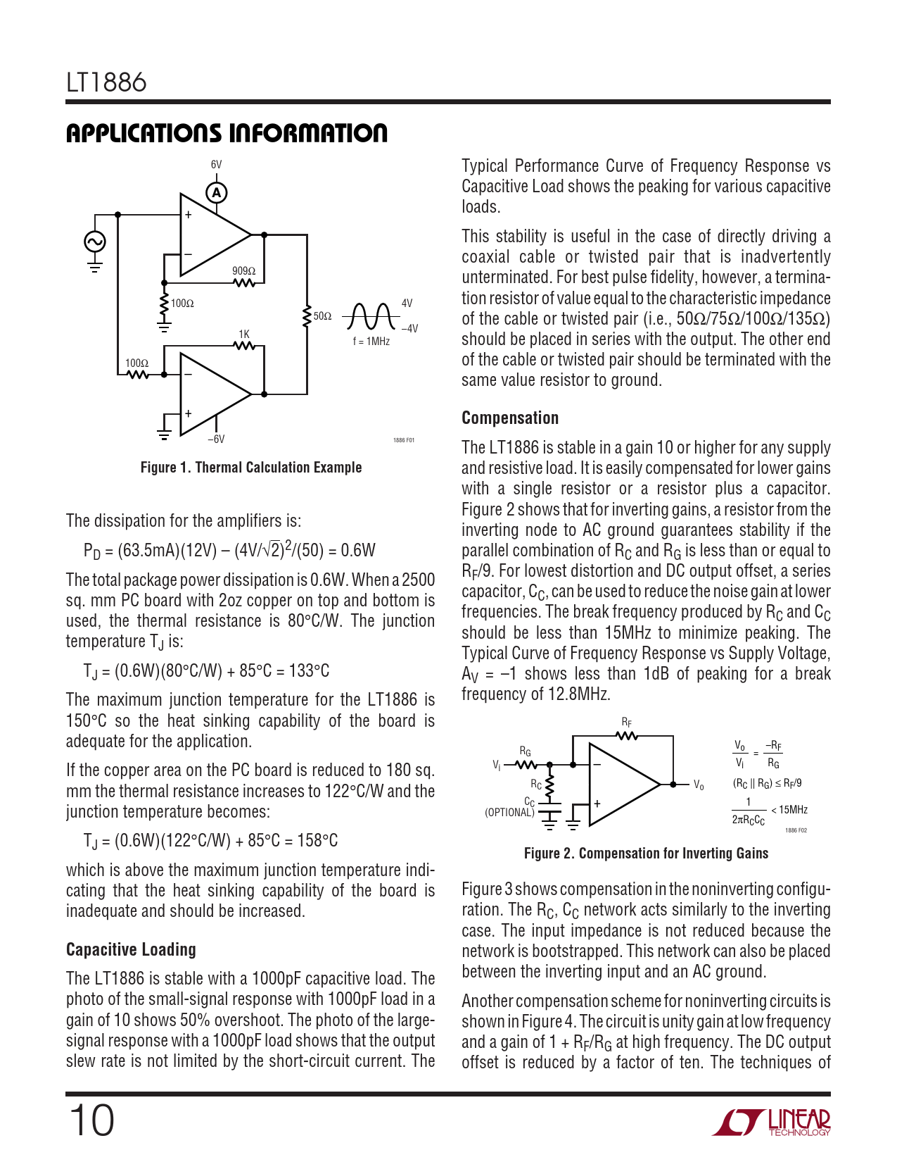

6V Typical Performance Curve of Frequency Response vs Capacitive Load shows the peaking for various capacitive loads. + This stability is useful in the case of directly driving a – coaxial cable or twisted pair that is inadvertently 909Ω unterminated. For best pulse fidelity, however, a termina- 100 4V tion resistor of value equal to the characteristic impedance Ω 50Ω of the cable or twisted pair (i.e., 50Ω/75Ω/100Ω/135Ω) –4V 1K f = 1MHz should be placed in series with the output. The other end 100Ω of the cable or twisted pair should be terminated with the – same value resistor to ground. +

Figure 1. Thermal Calculation Example
and resistive load. It is easily compensated for lower gains with a single resistor or a resistor plus a capacitor. Figure␣ 2 shows that for inverting gains, a resistor from the The dissipation for the amplifiers is: inverting node to AC ground guarantees stability if the PD = (63.5mA)(12V) – (4V/√2)2/(50) = 0.6W parallel combination of RC and RG is less than or equal to R The total package power dissipation is 0.6W. When a 2500 F/9. For lowest distortion and DC output offset, a series capacitor, C sq. mm PC board with 2oz copper on top and bottom is C, can be used to reduce the noise gain at lower frequencies. The break frequency produced by R used, the thermal resistance is 80°C/W. The junction C and CC should be less than 15MHz to minimize peaking. The temperature TJ is: Typical Curve of Frequency Response vs Supply Voltage, TJ = (0.6W)(80°C/W) + 85°C = 133°C AV = –1 shows less than 1dB of peaking for a break The maximum junction temperature for the LT1886 is frequency of 12.8MHz. 150°C so the heat sinking capability of the board is RF adequate for the application. V –R R o F G – = If the copper area on the PC board is reduced to 180 sq. V V R i i G mm the thermal resistance increases to 122°C/W and the RC Vo (RC || RG) ≤ RF/9 + C 1 junction temperature becomes: C (OPTIONAL) < 15MHz 2πRCCC 1886 F02 TJ = (0.6W)(122°C/W) + 85°C = 158°C
Figure 2. Compensation for Inverting Gains
which is above the maximum junction temperature indi- cating that the heat sinking capability of the board is Figure 3 shows compensation in the noninverting configu- inadequate and should be increased. ration. The RC, CC network acts similarly to the inverting case. The input impedance is not reduced because the
