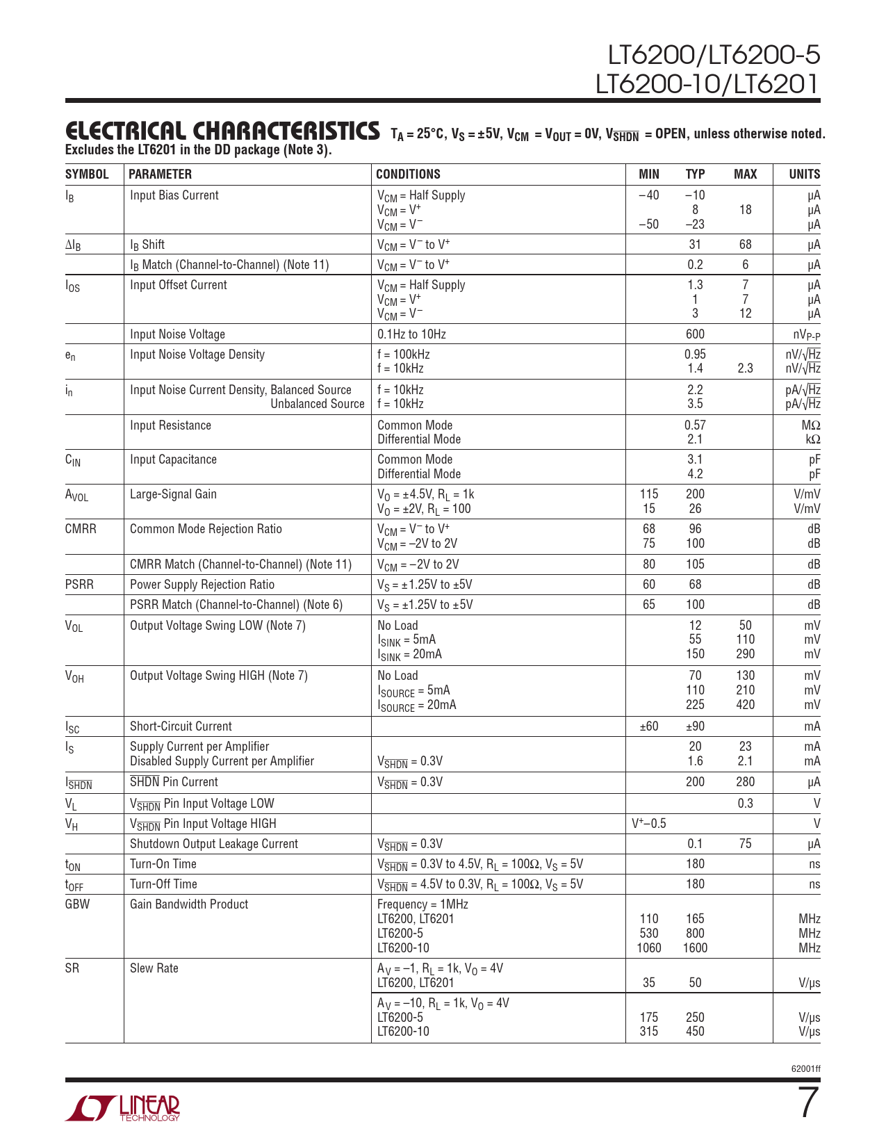

elecTrical characTerisTics. TA = 25°C, VS = ±5V, VCM = VOUT = 0V, VSHDN = OPEN, unless otherwise noted
elecTrical characTerisTics TA = 25°C, VS = ±5V, VCM = VOUT = 0V, VSHDN = OPEN, unless otherwise noted
LT6200/LT6200-5 LT6200-10/LT6201
elecTrical characTerisTics TA = 25°C, VS = ±5V, VCM = VOUT = 0V, VSHDN = OPEN, unless otherwise noted. Excludes the LT6201 in the DD package (Note 3). SYMBOL PARAMETER CONDITIONS MIN TYP MAX UNITS
IB Input Bias Current VCM = Half Supply –40 –10 µA VCM = V+ 8 18 µA VCM = V– –50 –23 µA ∆IB IB Shift VCM = V– to V+ 31 68 µA IB Match (Channel-to-Channel) (Note 11) VCM = V– to V+ 0.2 6 µA IOS Input Offset Current VCM = Half Supply 1.3 7 µA VCM = V+ 1 7 µA VCM = V– 3 12 µA Input Noise Voltage 0.1Hz to 10Hz 600 nVP-P en Input Noise Voltage Density f = 100kHz 0.95 nV/√Hz f = 10kHz 1.4 2.3 nV/√Hz in Input Noise Current Density, Balanced Source f = 10kHz 2.2 pA/√Hz Unbalanced Source f = 10kHz 3.5 pA/√Hz Input Resistance Common Mode 0.57 MΩ Differential Mode 2.1 kΩ CIN Input Capacitance Common Mode 3.1 pF Differential Mode 4.2 pF AVOL Large-Signal Gain VO = ±4.5V, RL = 1k 115 200 V/mV VO = ±2V, RL = 100 15 26 V/mV CMRR Common Mode Rejection Ratio VCM = V – to V+ 68 96 dB VCM = –2V to 2V 75 100 dB CMRR Match (Channel-to-Channel) (Note 11) VCM = –2V to 2V 80 105 dB PSRR Power Supply Rejection Ratio VS = ±1.25V to ±5V 60 68 dB PSRR Match (Channel-to-Channel) (Note 6) VS = ±1.25V to ±5V 65 100 dB VOL Output Voltage Swing LOW (Note 7) No Load 12 50 mV ISINK = 5mA 55 110 mV ISINK = 20mA 150 290 mV VOH Output Voltage Swing HIGH (Note 7) No Load 70 130 mV ISOURCE = 5mA 110 210 mV ISOURCE = 20mA 225 420 mV ISC Short-Circuit Current ±60 ±90 mA IS Supply Current per Amplifier 20 23 mA Disabled Supply Current per Amplifier VSHDN = 0.3V 1.6 2.1 mA ISHDN SHDN Pin Current VSHDN = 0.3V 200 280 µA VL VSHDN Pin Input Voltage LOW 0.3 V VH VSHDN Pin Input Voltage HIGH V+–0.5 V Shutdown Output Leakage Current VSHDN = 0.3V 0.1 75 µA tON Turn-On Time VSHDN = 0.3V to 4.5V, RL = 100Ω, VS = 5V 180 ns tOFF Turn-Off Time VSHDN = 4.5V to 0.3V, RL = 100Ω, VS = 5V 180 ns GBW Gain Bandwidth Product Frequency = 1MHz LT6200, LT6201 110 165 MHz LT6200-5 530 800 MHz LT6200-10 1060 1600 MHz SR Slew Rate AV = –1, RL = 1k, VO = 4V LT6200, LT6201 35 50 V/µs AV = –10, RL = 1k, VO = 4V LT6200-5 175 250 V/µs LT6200-10 315 450 V/µs 62001ff 7 Document Outline Features Applications Description Typical Application Absolute Maximum Ratings Pin Configuration Order Information Electrical Characteristics Typical Performance Characteristics Applications Information Package Description Revision History Typical Application Related Parts
